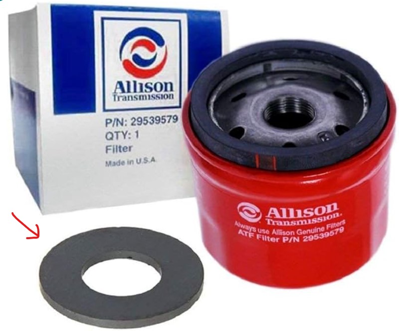

Also looked at the spin on filter for the trans: Fram. Yikes. Guys on the Ferrari forum have a saying: "Friends don't let friends use Fram filters."
Trans fluid is a little dark. I know the oil has been changed once a year over the last 9 years, even though the PO was only putting about 1500 miles a year on it. Doesn't look like the trans has been properly serviced, so will get that taken care of with proper filters.
Forgot to measure my pan, so don't know if it has deep or shallow.
Any Allison gurus here? What about TranSynd fluid?

After a LOT of reading, I bought the Transynd fluid. Also bought Baldwin filters.
We have our Museum fundraiser next week, so I am buried in prep for that, but may still get to my trans service this weekend.
Man, I love this truck.
Yes, to both Transynd and Baldwin Filters. Make sure there is a magnet on top of the spin on filter. I use same fluid and filter in my 05 LLY Duramax. The GMT800 platform is one of the best trucks GM ever made. I love mine. Seats in them are almost like a lazy-boy recliner! Enjoy the truck!
