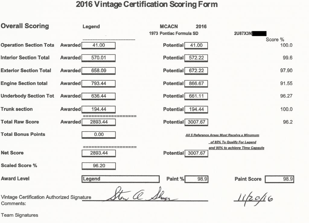

I got the scoring sheets from Steve Shauger:
Looks like we came "this close" to getting the ultimate award of "Time Capsule". You have to get a score higher than 95% in each of the categories to achieve that. As a result, the car was awarded Legend status as it passed the minimum 85% in each category.
We missed it by a few points in the engine compartment category for the following items as far as I can figure:
1) Reproduction battery: we got zero points out of 30 possible points.
2) We got zero out of a possible 15 points for the starter. The starter was the correct part number 1108436 for a Super Duty, but it original stamping date was February 1, 1971 - deemed two years too early for the car.
3) The alternator and power steering belts were not the originals. So we only got 7.5 out of 15 possible points.
4) In the "distributor, wires and plugs" section we got 16 out of a possible 20 points there. Not the assembly line spark plugs maybe? (the sheet doesn't specify what the deduction is for)

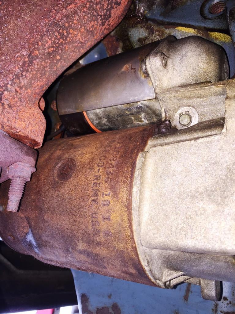

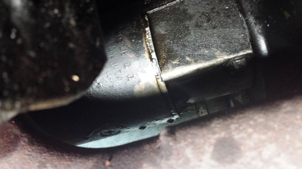

I have been scratching my head over my starter which is an SD455 1108436 starter but has a 1B11 date on it (Feb 1971). It appears it has never been touched and no one in the ownership chain ever replaced it. I was told by the judges that it is too early to be a factory installed starter, which is why they gave me zero points for the starter. At the time of the show I had no idea the starter was that far beofre the car otherwise I would have researched the issue beforehand.
(It is interesting to note though, that all the 73 SD455 engines were cast in 1972 which was how the engineers got around the bosses trying to cancel the entire SD455 program once they found out about it - but they found out too late that all the engines had already been built and instead of scrapping the program, they decided to save money and just let the cars be built)
Well, I just had my buddy down the street (just 5 miles away) check his starter. He owns a survivor, original paint, Brewster Green SD455 Trans Am that he has owned for several decades and bought from the original owner. His car was built/shipped 20 days before mine 6/29/73 versus 7/19/73
and the result?
SAME PART NUMBER, SAME EXACT DATE CODE!
My starter:
His starter:
I am now reaching out to other SD455 owners about their starter dates. Stay tuned!

1971 V8 - 455 H.O. 1108436
Possible they used 71 455 HO starters?

Yes, the 1108436 was the high torque application used in the 455HO and the SD455. It may very well be that they had a stockpile of them made in a certain batch and then just used them up as time went on.

I sent my starter research to Steve (Paceme) and they checked their records on the Charlie's 1700 mile SD they judged back in 2011...wait for the drum roll...SAME PART NUMBER, SAME DATE! So he is recalculating the score. Stay tuned for further episodes. [img]<<GRAEMLIN_URL>>/biggthumpup.gif[/img]

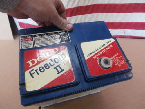

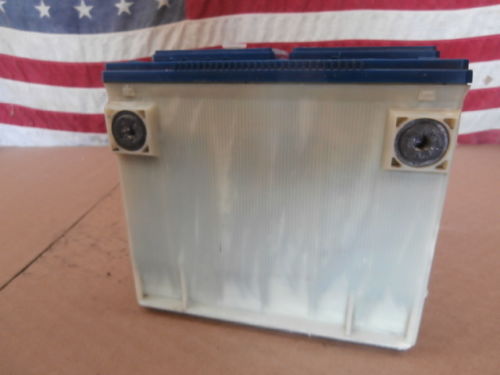

And now my search starts for the correct 1973 Delco X C89 battery in case anyone has one in the corner of their garage. It doesn't have to work to get partial points. This car had the $26 optional maintenance free battery better known as the Delco Freedom battery. I believe it looks like this:

I believe the early style was called the Delco Freedom and the later 1970's was the Delco Freedom II. They both had the white case and blue top. Same cases, just a slight alteration in the stickers they placed on top.

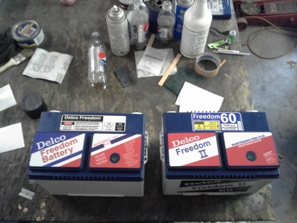

This guy cloned his own modern batteries into replicas of the originals for the later 1970's Trans Ams
http://www.78ta.com/HTAF/index.php?topic=42751.0
