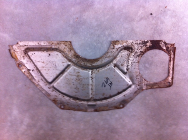

Graeme,
Here is a known original 69 Z28 inspection cover, the CC cover looks the same IMO , except for the black paint that could be stripped off.

Originally Posted by luv2sixty9 View Post
Graeme,
The new picture of the clutch inspection cover is 67 68 for 69 is slightly different.
Thanxs Dave
Dave, Respectfully What is different? According to my GM parts book dated 72 the inspection cover is the same 67/68/69, with no superseded part number

Here's mine, hope that's correct for '69 (but it's going back on there regardless!).
Tim in NSW, Australia
