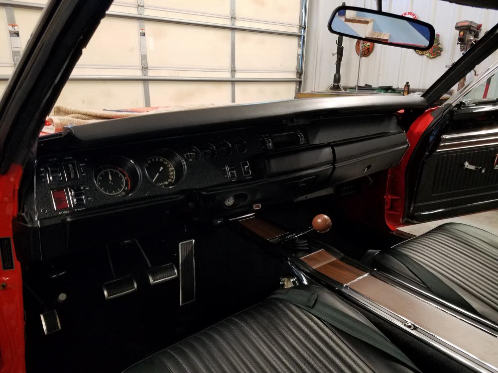

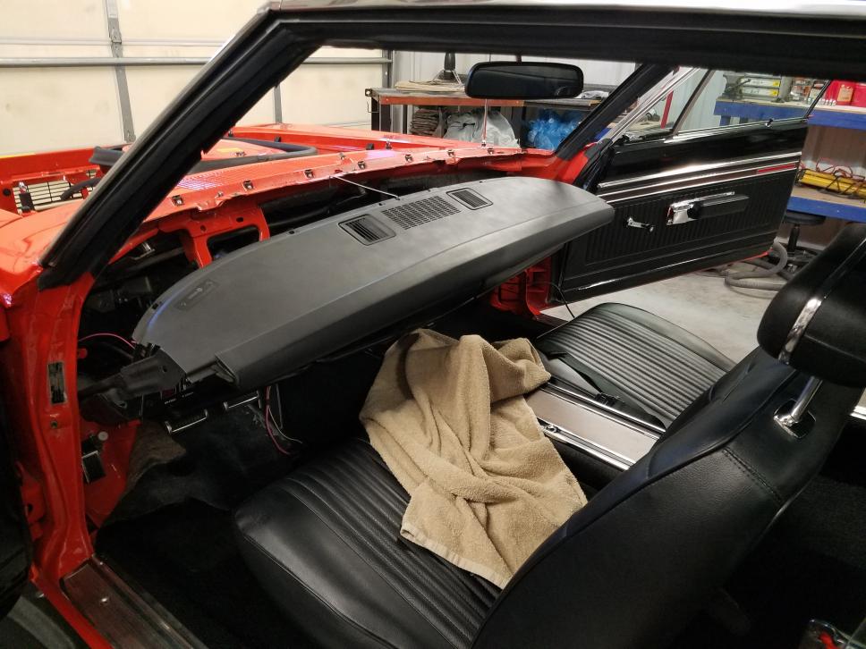

Well, so much for aftermarket quality! The center dash pad, while very good looking, is missing the faux stitching and doesn't match the rest of the original pads. Oh well, on the shelf it goes. I'll save it for another B-Body car. The key would be to order all three pads so they match. So, in went the original part and I'll just live with the few little blemishes on it. After all, it's original to the car so there's something to be said for that!

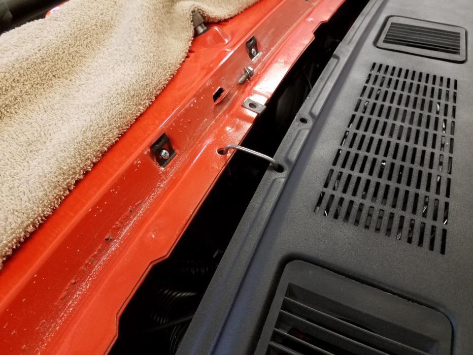

When you're a one man show, you find ways to get that extra hand you need when you don't trust anyone to not scratch the crap out of your work. So here's my helper with holding the dash in place while I hook everything up. Mopar dashes mount on two kick panel area bolts and then pivot on those toward the cowl. Once in those two bolts, I made this handy, CNC machined, CAD drafted, intricately designed bracing mechanism [a bent wire ] to hold the dash in place.

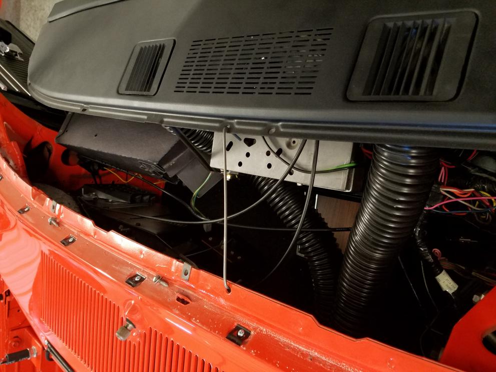

The bigger gap allowed me to hook up the wiring and defroster ducts. Once those were hooked up, I went back to the CAD designer and shortened the parameters on the brace by 1/12th and 3/4 millimeters to get the proper distance to allow my hand to fit behind the instrument panel and hook up the speedometer cable

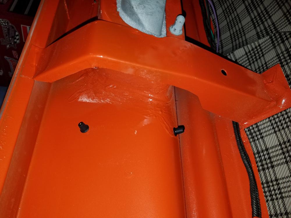

One of those small details that nobody will notice, but I know is there, are these always missing tail panel screw cover caps. They screw onto the ends of the screws that hold the tail panel on that are visible inside the trunk. I made these myself based on an original.

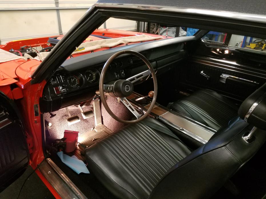

And steering column going in........

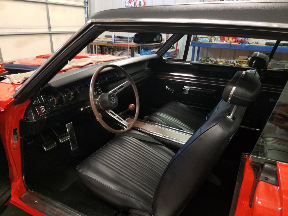

It's in! today I'll test the lights and make sure it cranks over! More to come....
