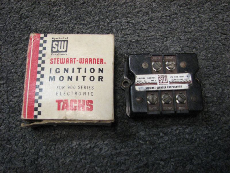

Thanks to Jason for swapping out his mint NOS 990B monitor for my not as nice one plus some cash. This one will look great on the firewall. Not that the other one was not good but this one was mint so thank you for doing that.

My pleasure Rick. I think the one in the picture is the one I received, not the one I sent. Is that right?

Whoops, you are right! That was mine. Here is yours.

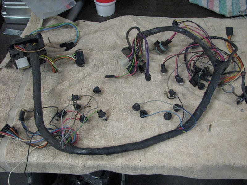

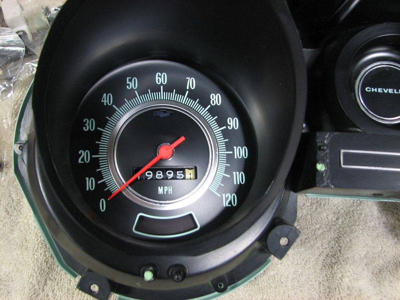

This past weekends project were the gauges and wiring harness. All were torn down, cleaned and repaired as necessary. The carriers were badly rusted and corroded so all had to be stripped and cleared or repainted as original including the white interiors. All hardware restored. Next comes a new gauge lens face and then mounted into the dash carrier that was in excellent shape. I will finish on the dash carrier in the coming evenings and assemble it as a unit in anticipation of installing it shortly.

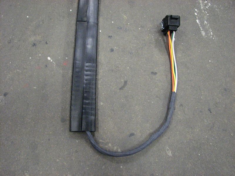

Thanks: 3,044

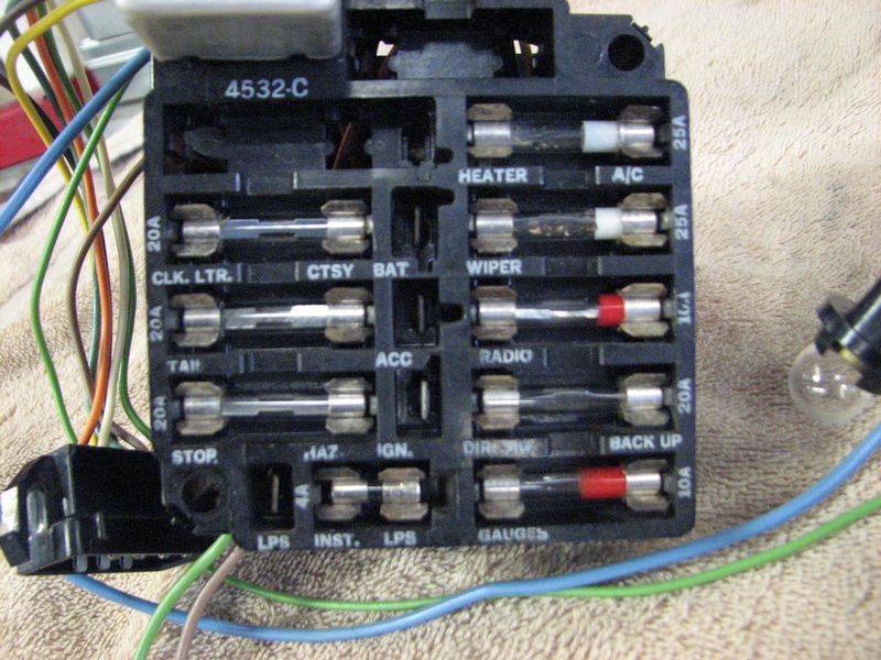

As a general rule I replace all wiring harnesses whether they need to or not at least under the hood for safety reasons. The rest depends on the condition. When ever I use reproduction harnesses I always open them up and replace some of the wires with correctly colored ones from my inventory and change out any incorrect ones. American Auto Wire custom made all the harnesses on the car by hand using some of the items I sent them and they did a great job. The dash harness was still in great shape so I ended up restoring my original using original style tapes and wraps. Original color coded fuses were also cleaned and reused.
All electrical switches were disassembled, rebuild and relubed. I do this on almost every restoration to insure everything is brand new.

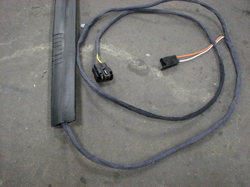

The intermediate harness was supplied by AAW and the sheathing was the original which was restored.
Rick Nelson

surprised the painted fuses survived so well..hard to get in 2019
