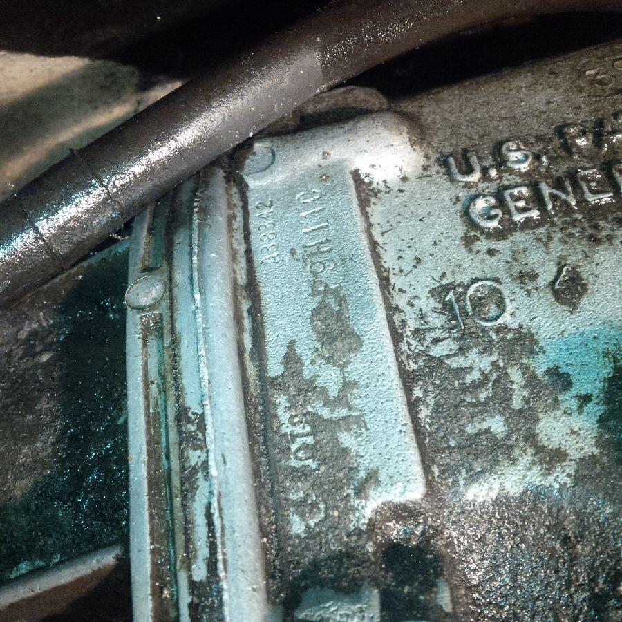

Ryan....that's a 1969 M22.....you lucky dog!

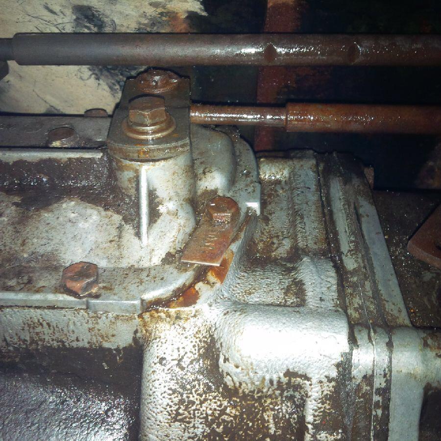

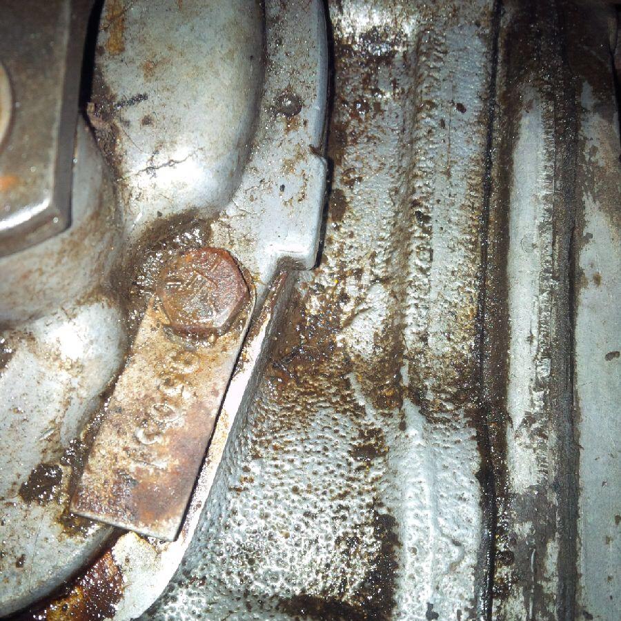

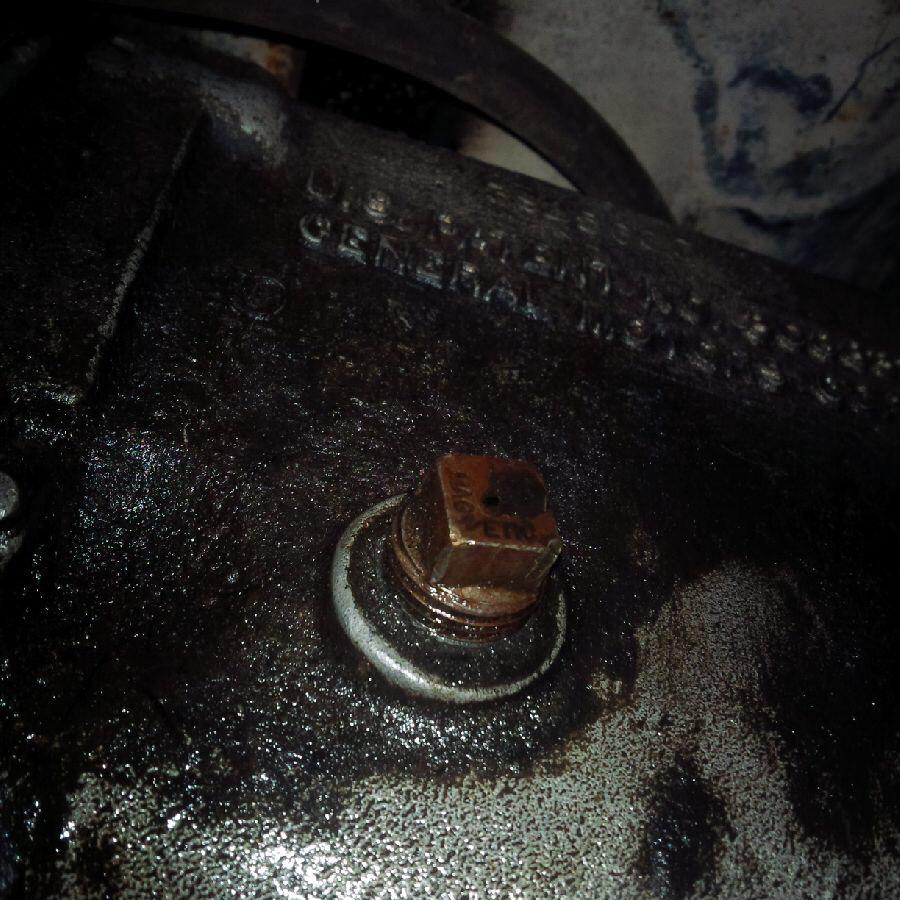

Here are some transmission pictures and a couple floor pan shots

Hmmm, supposed to be an M20.........
Can you type out the codes or post a link?

The letter &quot;C&quot; makes it a M22......if the internal gears haven't been changed.

The tag on the side cover has numbers on it. That will be helpful to know what trans you have.

P= Muncie 4 speed
9= model year
H= August
11= 11th day
C= rock crusher M-22, 10 tooth input, 27 tooth output shaft.
I also knew Ryan would be Whining [img]<<GRAEMLIN_URL>>/biggthumpup.gif[/img] Very Cool!

The tag says 9503 and seems like 13 backwards at the end, my phone died as I cleaned the tag for good pictures:-(

Is the stamp A38342 part of a VIN from the car it came from? Not enough digits?
Is A Atlanta? Did this come out of a Chevelle?
