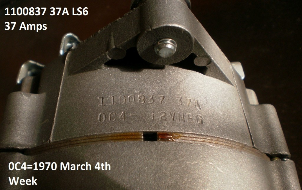

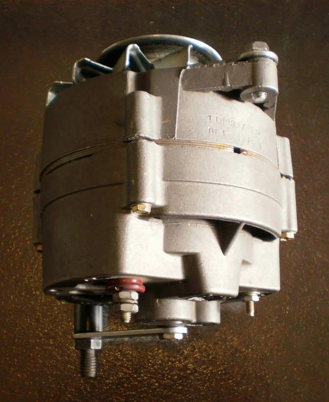

Ok Guys,
I am going with <span style="color: #FF0000">Solid lifters</span>.
Still havent ordered my cam,lifters,rockers,pushrods etc...
so lots of time to order the parts.
Here is the original Distributor restored by Jeff Dotterer with certificate.
Also photos of my Original Alternator.
Yesterday i was busy restoring the Wiper Washer Motor which came out fantastic,i will post photos later of that piece.
Question, Does anyone know what the &quot;DSL&quot; logo means on the Waterpump to Alternator bracket?
Also why does this bracket have a special fitting in it,is it a support hole for the smog pump?
<span style="font-weight: bold">its a bushing, so the alt. belt lines up.</span>

Thank you Donnie and Steve for that Info.
Donnie i am sticking to build the motor just like that &quot;quote&quot; i stated but will use the solid lifters though.
Nothing can change my mind about the flat top pistons and lower compression though, last motor i had running in there was a pain in the a@@ with the 11:25 to 1 compression, car would not run right with 94 octane and every fill up for gas i had to mix about 25$ worth of Very High Octane just to get the right gas. I really hated bringing that Cherry can in my trunk and paying $125 for each fill up.
At least with the Original LS6 rebuilt to my tastes i can drive in peace and just go to the gas station to get gas like everyone else. [img]<<GRAEMLIN_URL>>/biggthumpup.gif[/img]
