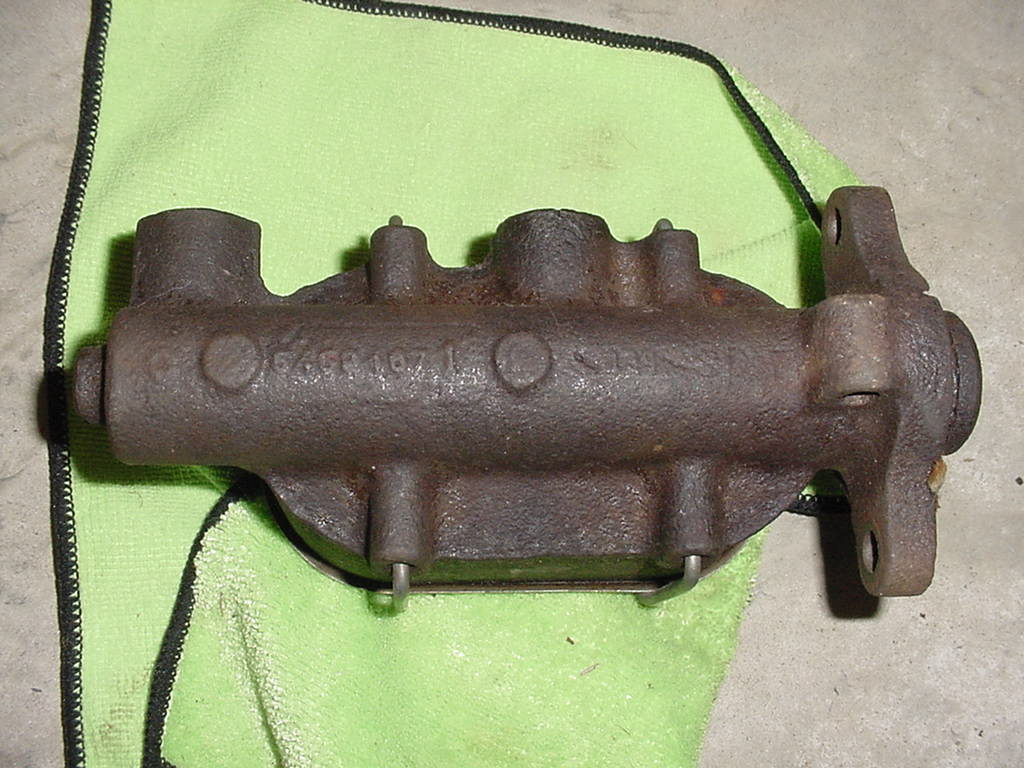

Hi is this the correct master cylinder I need for J52 brakes has part # 5459467 can not read the letter stamped on flat part

Yep...that is the one. Code will be "AD" 1" bore and no bleeders.
