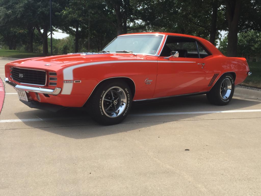

Here is what I am working on.
Need bias ply tires to mimic my current set up.

Are you kidding me? That car looks "flat out awesome" the way it sits. I wouldn't touch a thing on that car.

Agree,lose the radials & you'll have me.

Leave her alone -- looks great!

Thanks guys!
I think TTO's with Bias Ply tires the same size as what my radials are would look killer. Just struggling with which bias ply tire to get to match up with 215/65/15 & 255/60/15. I am thinking maybe a F60 will be very close to the fronts and a G60 may be a little narrower than the 255's.

G60 would look alright on the back, but L60 would likely be a better fit being that they are 9.0 wide and match the height on your existing rear tires.
