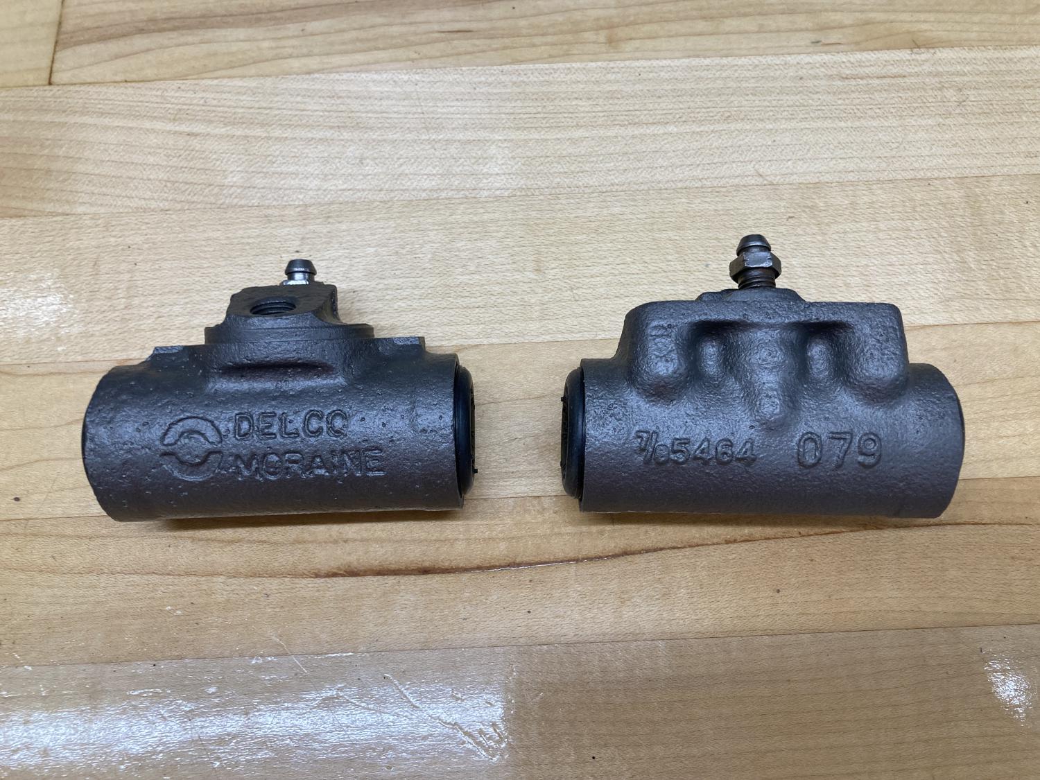

Rainy Sunday morning here yesterday so I spent some time back on the Chevelle. Still waiting for the fuel pump - will be a couple more weeks I guess.
Last week I was able to get the rear brake cylinders assembled and installed. My plan for yesterday was to install a new rear flexible brake line and bleed the brakes. I bought an AC Delco line rather than a repop figuring I wouldn't have any issues - but guess what...the hole for the attaching bolt wasn't machined big enough. I should have known when I saw the Made in China on the box....
I hooked the old line back up and started to bleed the brakes, was able to get fluid to the back but for some reason I am not able to get fluid out of the front calipers........will need to diagnose that next. So it sits for a while longer now.
