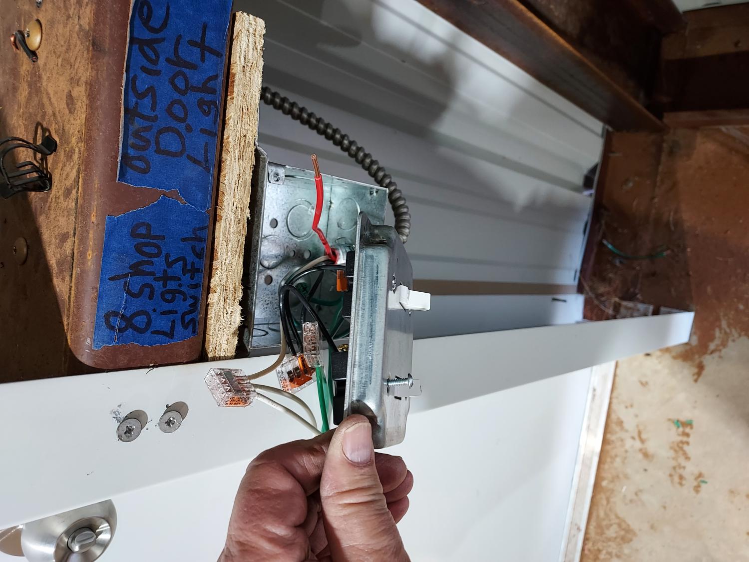

Getting started running power. Touch working off a 10' ladder. Pulled MC cable around to the man door. Getting a box ready with 2 switches. One for inside LED's and outside door light. Someone gave me a $500 roll of 12/3 in 1986. FINALLY have a place to use it. Probably cost $80 back then...LOL Came out of the man door box and up to mount 4 boxes for the lights. All 8 on one circuit will work. Got 3 done, last one today. THEN I can plug all the lights in and take down all the extension cords. ALL outlets 20amp. Even the switches are heavy duty 20amp. There will be no 14-gauge wire or 15amp outlets. I used full gang boxes with single outlet for more room in the box. Makes things a little easier in the air. I use the blue rubber protectors around the outlet, especially in metal boxes. Just an added safety thing. D

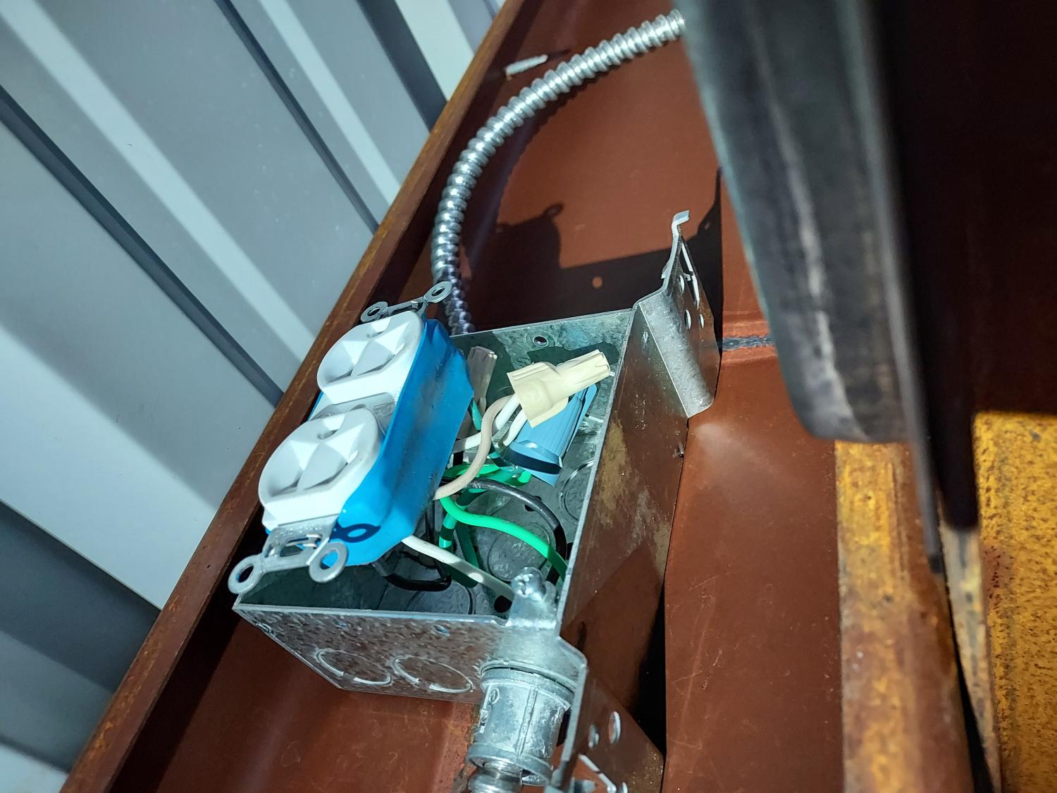

Got 12 boxes trimmed out and tested, all good. Now ready to start the other 12. Prefabbed up a bunch to get a jump on assembly trim-out.
Yes outlets are upside down, ground up on purpose. Anybody guess the reason why? Danny

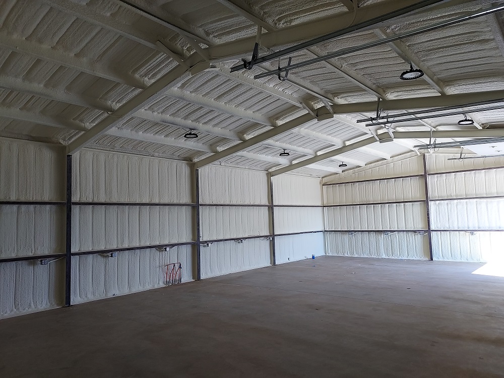

Well, I finished the other 12 or so outlets. Dug another shorter ditch between the 2 buildings. I ran 2" flex in that ditch along with a 1/2" soft copper air line. I can pull power through that flex for my Mini-Split Heat/Air unit. So I can come off the 200amp main panel and save power in the new shop 100amp sub panel.My girlfriend bought me a 48,000btu unit.
https://www.premiumhomesource.com/pr...SABEgIonPD_BwE
So the double compressor mounts out side. Then there will be 2 wall units inside both 24,000btu's each. It says it will work for about 18,000 cubic feet. My shop is probably about 18 or 19,000 cu ft. 30 X 50 X about 12 = 18,000 cu ft. Going to run power from main panel to disconnect box, then into unit. I bought an extra 50' line set. So one wall unit on each side wall. Too much work and money to get the radiant heat going. And it's only heat. This will be heat and air cond.
I am putting the compressor in the small shop. It is insulted with closed cell spray foam. Then 25' or so away in the new shop will be the outlet. That way I don't have to listen to it turning on/running. I might be able to hear it some, but it won't be like having it a few feet away... LOUD.
Paid $6,500 for closed cell spray foam insulation in the new shop. 2" on the ceiling and 1-1/2" on the walls. So this should be a big help with temperature control. Getting excited... D

That foam looks great, but where do you live that you can get by with 2" ?? I blew in 24" of fiberglass in my ceiling.
I think you have enough outlets...
I bought a mini split for my shop a few months ago too. Gets way to hot to work in during the summer. Hope to get it installed next year.
