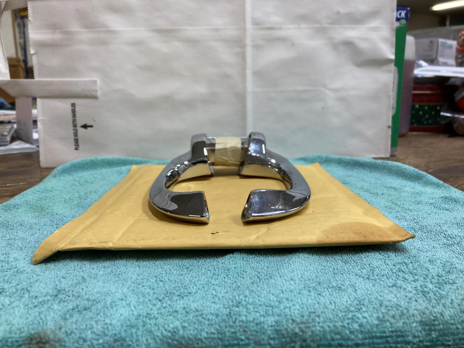

are you sure the handles are original? a 70 handle will not work on a 69
69 SS L78 Chevelle
70 SS 396 Chevelle

Donnie is correct. The 70-72 handles have a much flatter mounting area than the 68-69 which is cut at quite and angle. I cannot imagine that the issue is in the door panel as that would be quite noticeable let alone hard to screw up. Look at the angle of the mounting area on this handle in the photo and you can see how much more cut angle it is than yours. Sorry but this is the only photo I have that has an almost straight on shot of the door handle.
Rick Nelson

here a pic 70 on the right 69 on the left
69 SS L78 Chevelle
70 SS 396 Chevelle

Donnie, take a shot of the thumb end to show the difference in angles. I have no 69's here or I would do it.
Rick Nelson

Ahhhh....I see what ya'll are talking about. The door handles are original re-chromed but not from this car and therefore I have no idea from what year.
The door handles I took off of this car were very badly pitted. Really not useable. I need a set of 69 door handles now!

I read that some handles had 3.25" shafts and others had 3.5" shafts. This car was made in Framingham Mass. Any idea what would be correct for this plant? Man I wish I still had the original handles I usually never through anything away but these handles were hammered so out they went.

70 on the left...69 on the right
69 SS L78 Chevelle
70 SS 396 Chevelle

Thanks guys! I had no idea.
