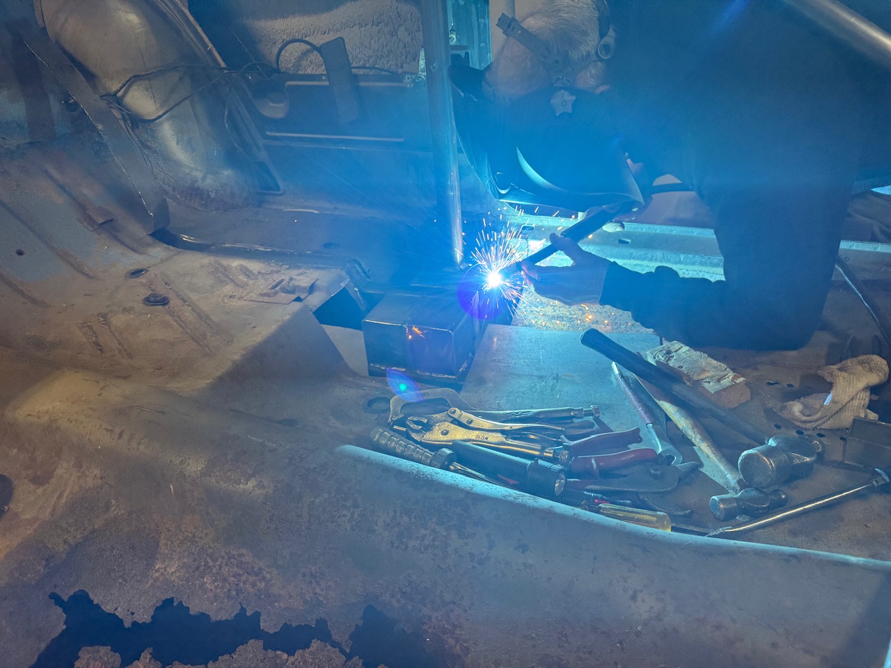

Took a ride out to the chassis shop today. Spent half a day up there(it’s 3.5hours each way so I left at 3:30. Got there at 7, went to breakfast then we worked on the car until 1 and I headed home to be back at 4:30). Had a great time and we got quite a bit done.
Yesterday Bill had a friend stop by and help welding the cage in. The two of us got more of the welding done. Then we got the dash cut and into place and then got the dash bar fit into place to be tacked.
Once the dash was in we rechecked my seating position so he could make the seat brackets and do the steering column. It’s basically going to come right through the factory hole but be 5-6 inches longer for my seating position in the car.
He has a bunch of cro-moly tubing being delivered tomorrow to make the ladder bars after he finishes the cage. He thinks that’ll be done sometime next week. The subframe connectors are complete. After that we have to do the engine plates and mount the pedals and it’s done.

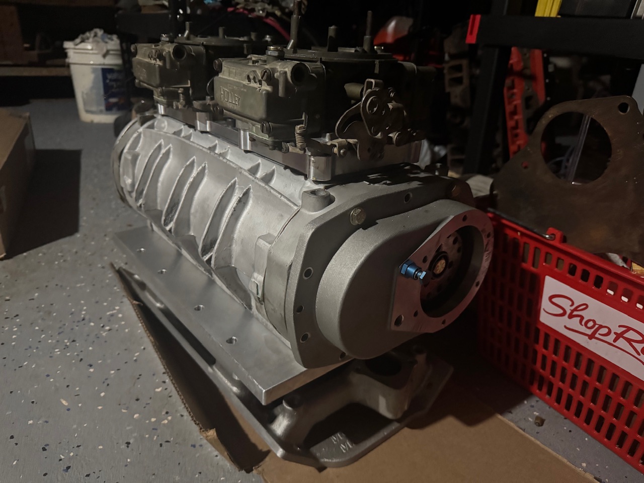

Also, a picture of the blower. Though I really want to switch to mechanical injection. It complicates things quite a bit. But I have time. No reason to rush.
Indy Modman 671 blower intake
Adapter plate
8V71 blower rebuilt
Dual carb adapter
Twin Holley 750 tunnel ram double pumpers. For now.

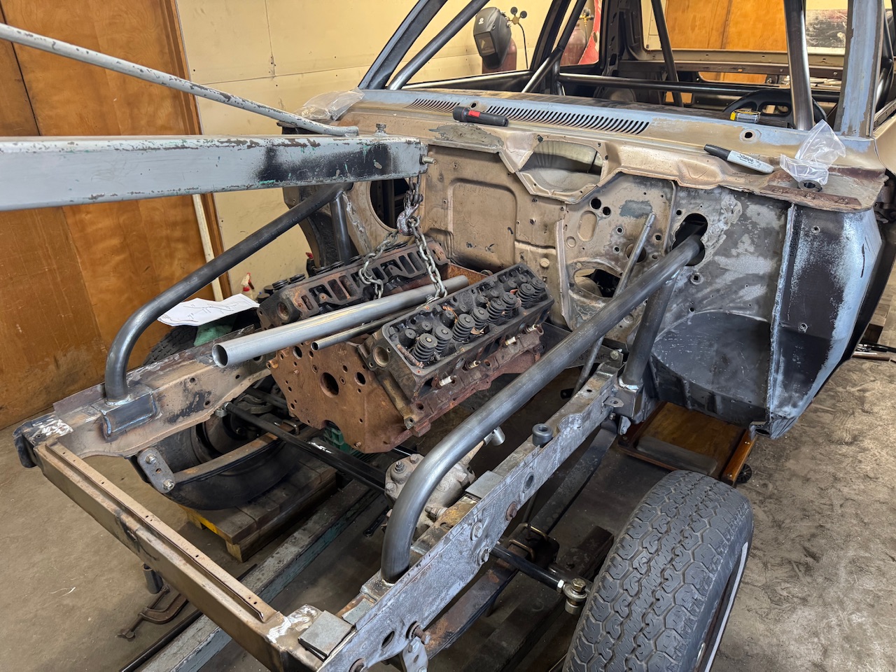

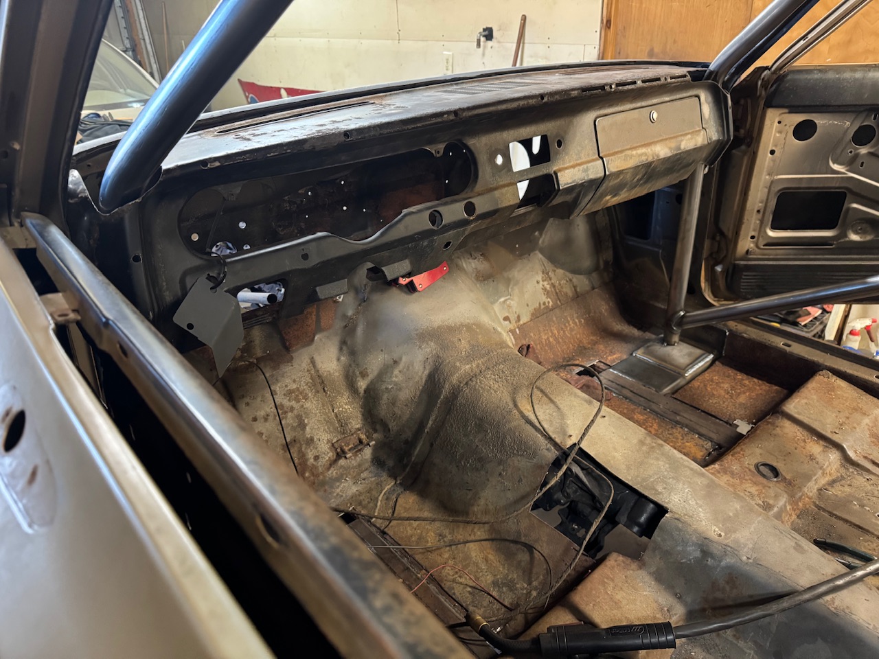

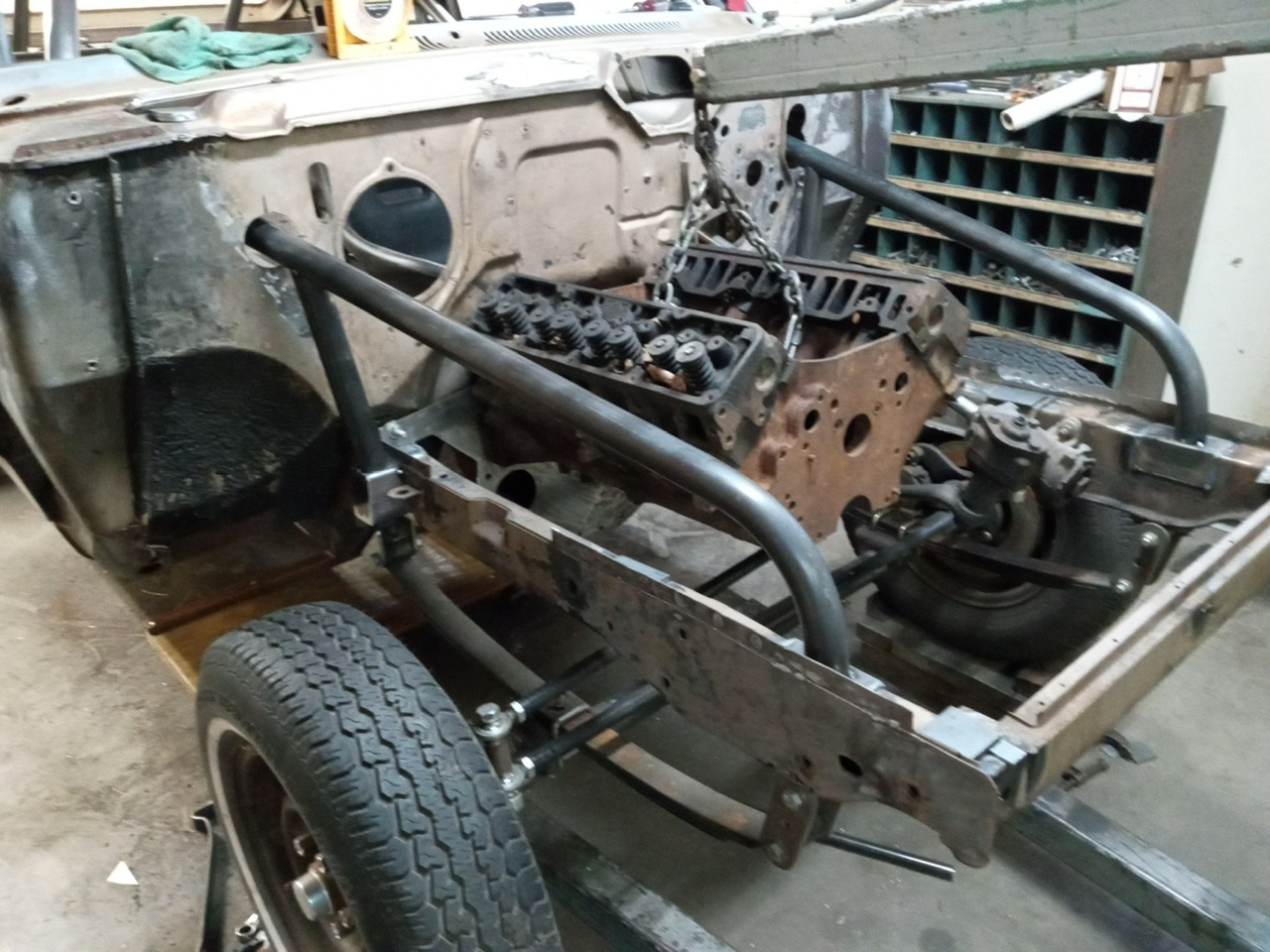

Chassis shop pictures
Cage is basically done minus some brackets and finished welds. Drivers seat is mounted. He’s leaving the passenger seat to me. Motor midplate is installed. Waiting on the front elephant ears from the local metal shop. They should be done this week. Then it’s onto the last major job, the rear suspension and ladder bars. I’m going up there this week or next week to help.
Hope you guys enjoy the photos.

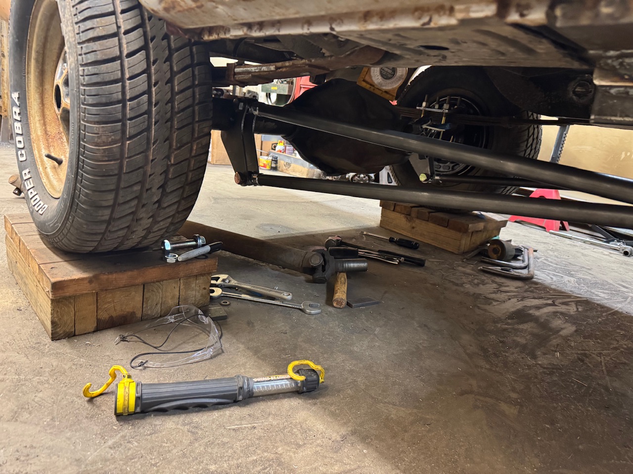

Chassis shop update
Took a ride out to PA today and spent the day helping to mock parts up so all the interior parts can be mounted and installed. We test mounted the steering column and found it sucks so we’re using basically no parts out of it. We also figured out how to hang the wilwood brake and clutch pedals so the mounts can be figured out.
The cage is 100% done minus brackets and mounts for stuff like the seat, belts, and other things.
The ladder bars are started and once the bars are done the housing sliders can be installed.
Hope you all enjoy the photos. This should be my last ride out there before I go pick the car up. He wants to get it done by the middle of March.
