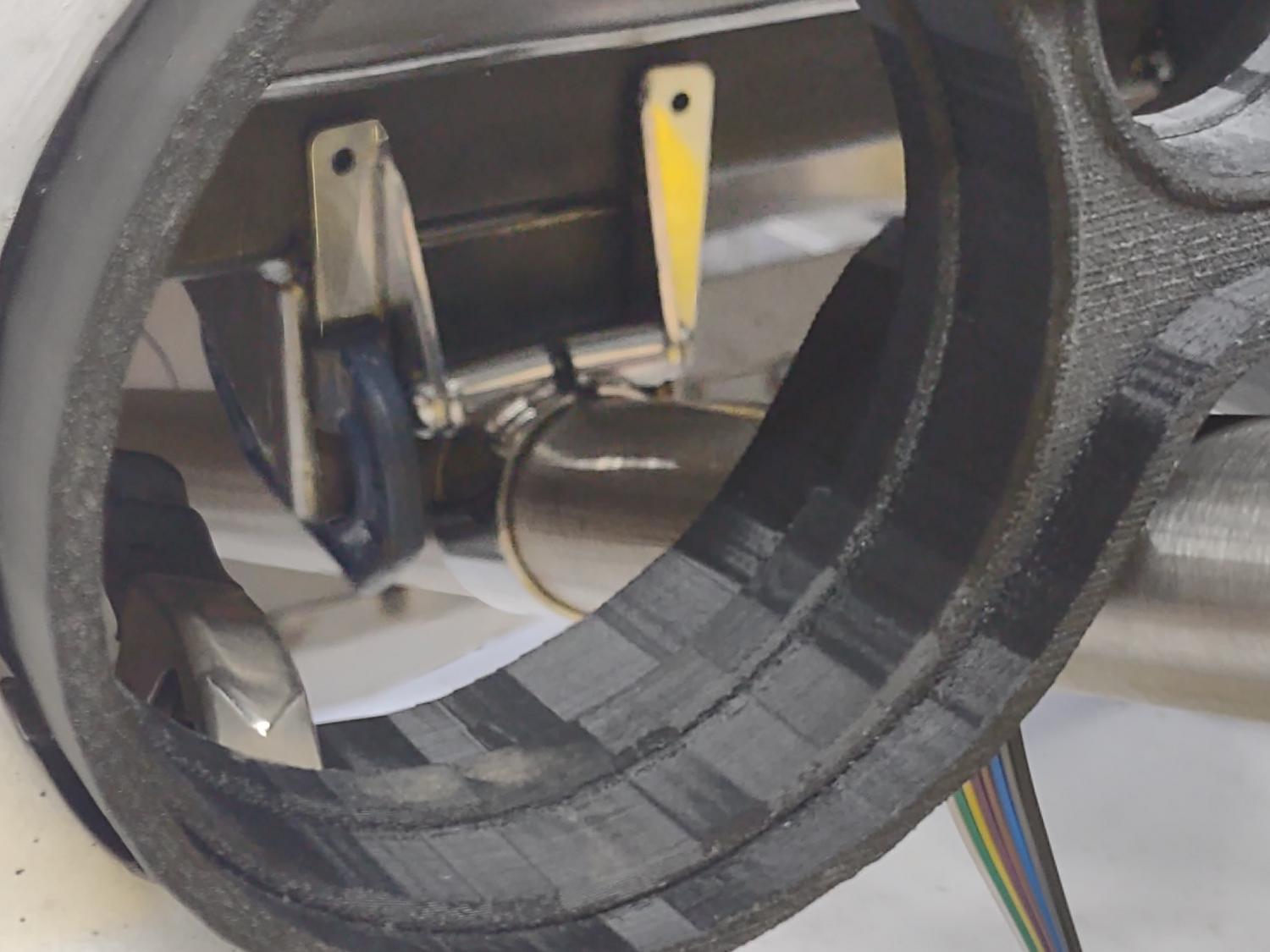

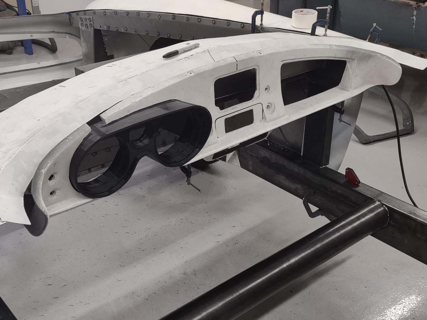

The fiberglass dash I bought a while ago which was molded off a real 507 dash. Although not the best, it'll work add I'll work with it to make it fit perfect. The idea is to mimic the real thing so with that, out comes the reference photos I took visiting the one in Philly being restored. Plus, the other few hundred I have of one during a restoration. The dash is supported by four brackets and the dash itself is three pieces. Everything is fabricated to be removed just like the real thing. Here's the tricky part I described earlier.

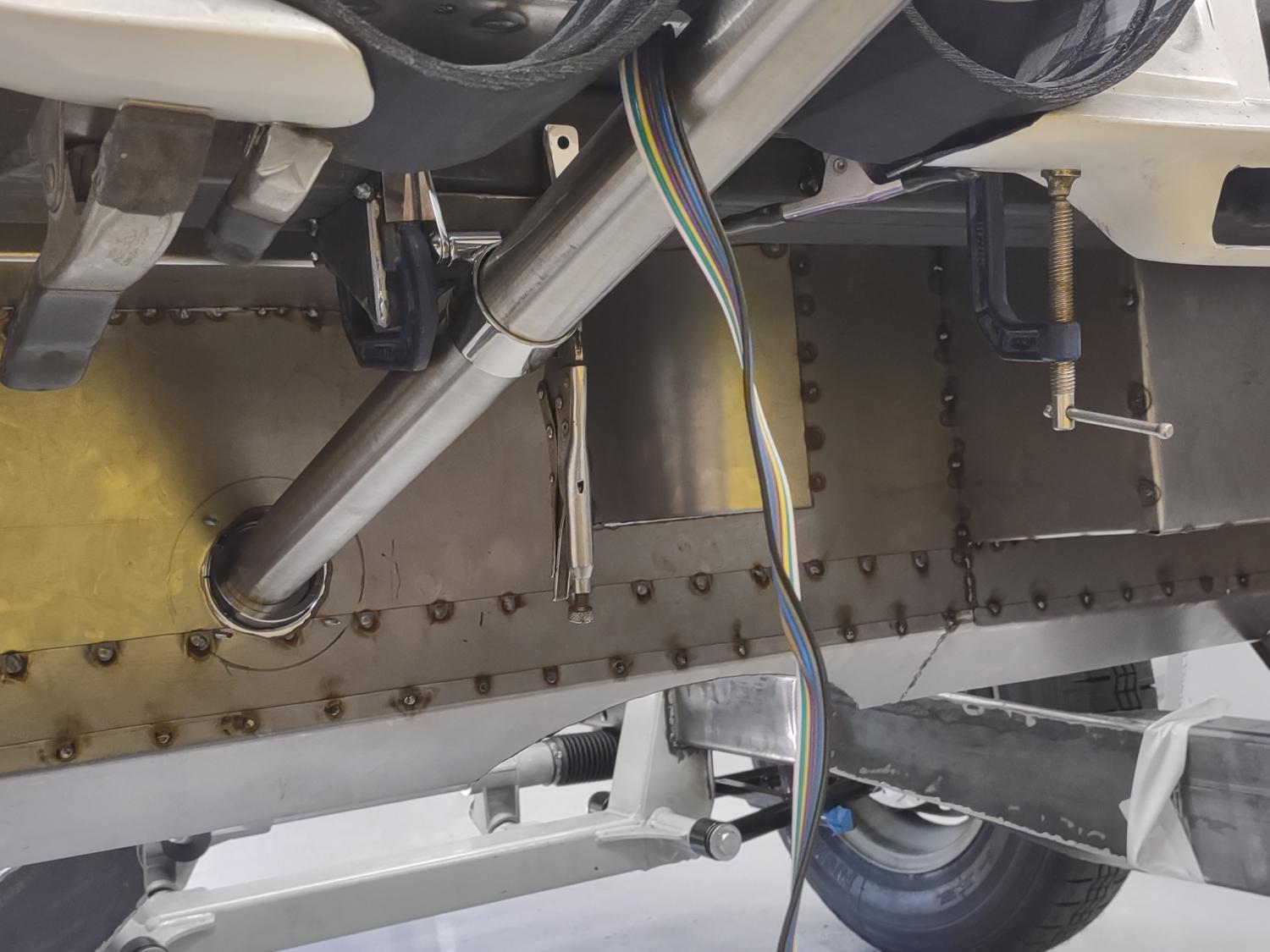

I need to know my heater box dimensions and wiper transmission sizes too. So hours of searching online yielded both that I'll be using and a bonus, the online product PDF gives sizes! Woohoo! knowing these I can leave space for everything. Once the dash was in place it was time to mount the steering column. But no floor or seat yet, so what's one to do? Simple! Use the seat from your John Deere Z915 Zero Turn mower which is EERILY similar in size to the seats I'll be using.

So with the seat in place via jack stands, I sat in position based on how I think it should be. There's plenty of room, steering wheel is at the right angle, so I think we're good! The mount will have slotted holes for vertical adjustment but the length seems perfect. A hard floor mount which will be braced with a 3/16" firewall plate will provide the need support. Nobody wants to turn the car and have the column fall out!!

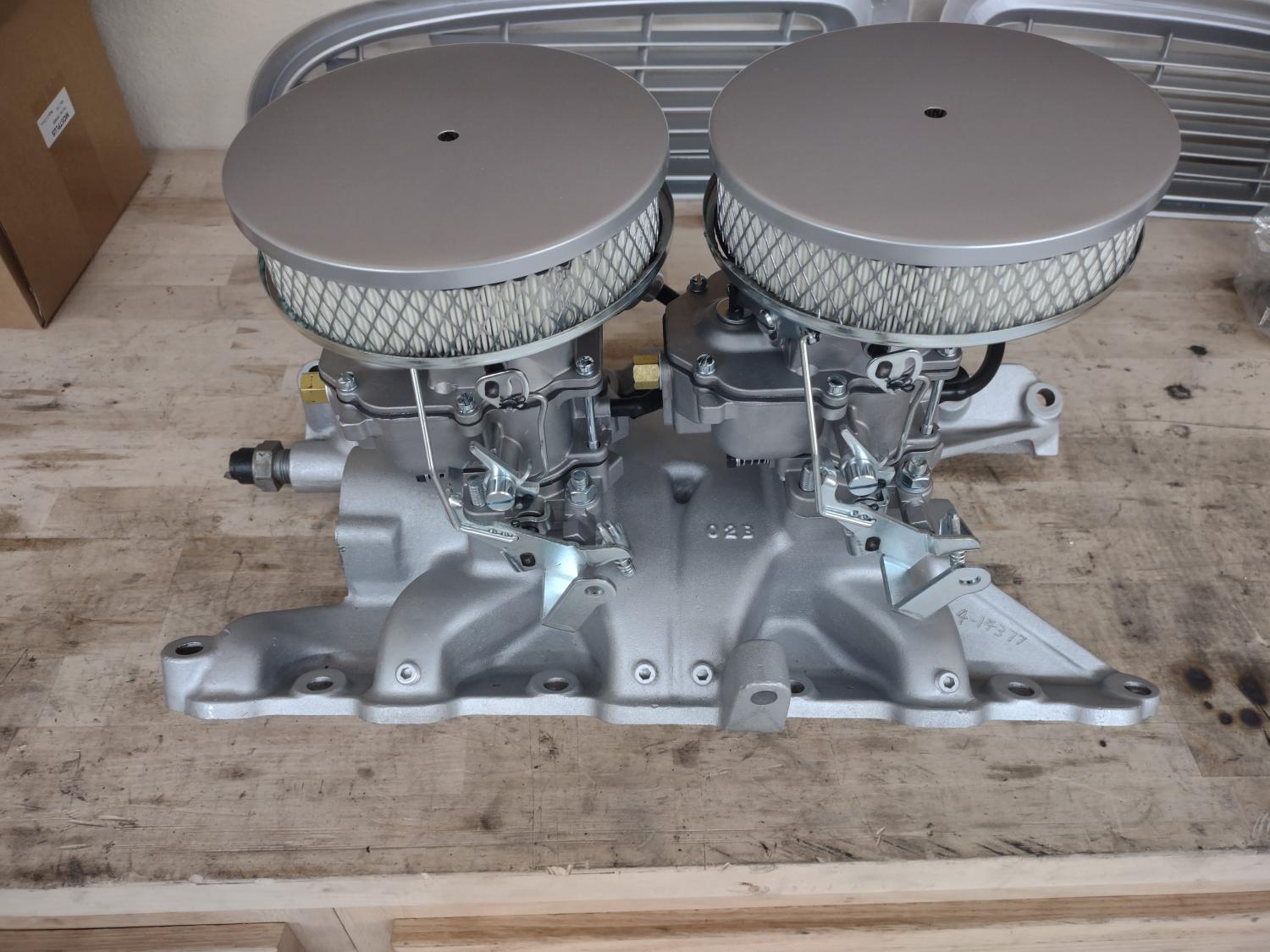

I took advantage of a free day today and mocked up my intake. This is believed to be a factory GM or aftermarket experimental intake for the 215. It's got flow ports at each runner and no part number. There's some engraved numbers on one side (very light) but that's it. No evidence of any grinding of the casting either. I got this and the engine from a guy who bought a whole truckload of parts from one of the developers of the engine. Pretty cool! Speaking of that, the engine gets here Monday night!
The factory 3.2L BMW V8 uses dual Solex carbs so I wanted to stay true to form with a dual carb set up on this engine too. 2x2 intakes, no matter what engine, are pretty rare. I still have a few mods to do (fuel drip pan and some air cleaner details) but this is how the package came together.
Dual Carter BBD carbs round out the package. Same bolt pattern as the small 2G. I offset the air cleaners and cut the element down to get the look correct. It's getting close.

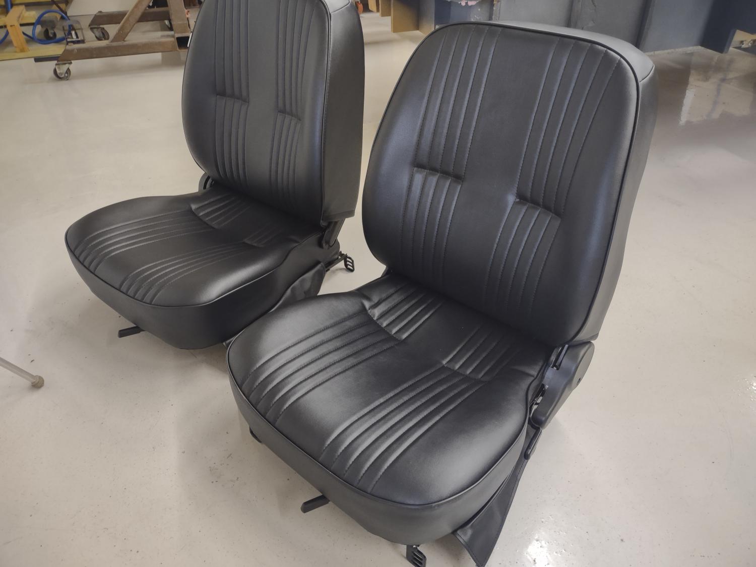

And with that, the seats came in so I took Kelly for an imaginary drive, and I go no further than the end of the driveway and this jackwad needle nose twerp cut me off!!! What the heck, I'm driving over here!!
