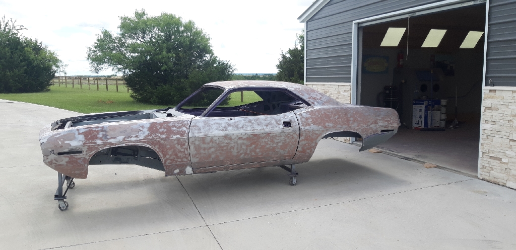

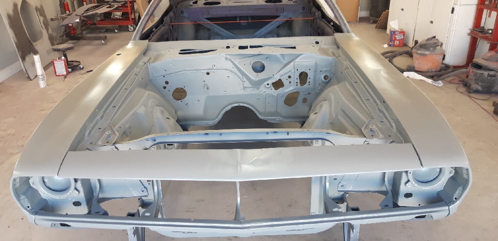

With this past week full of administrative duties with my folks settling in next door, it rained today so I was able to resume Cuda duties since Ranch stuff can't happen in the rain!
I finished the final metal work on the fenders with two patches....well, three.... needed so now Crusty is no longer Crusty! Woohoo! I also finished the stripping of the FC7. Liquid stripper followed by a putty knife followed by an N95 mask (the real reason you need one! ) followed by 80 grit. You can see my enthusiasm for bubbling paint and if you think that's impressive, you should see me watching paint dry!
So here we are in two coats of DP. One might note that the fenders aren't aligned nor is the front fascia panel. And one would be correct! These have to come back off to get epoxy on the backside and then I'll bolt them back on along with the hood and valances once those are epoxied too. That way, just like the dip tank would do, epoxy all over and then overspray with FC7 to finish! With fresh bare metal I just wanted to get the exterior in epoxy today. Alignment later.
Now, Steve isn't paying me for all this extra small detail work. Actually, Steve's not paying me for ANY of this work! But this is how the SuperDave machine rolls. Actually, I don't know what that means, but while we figure that out, enjoy the pics!

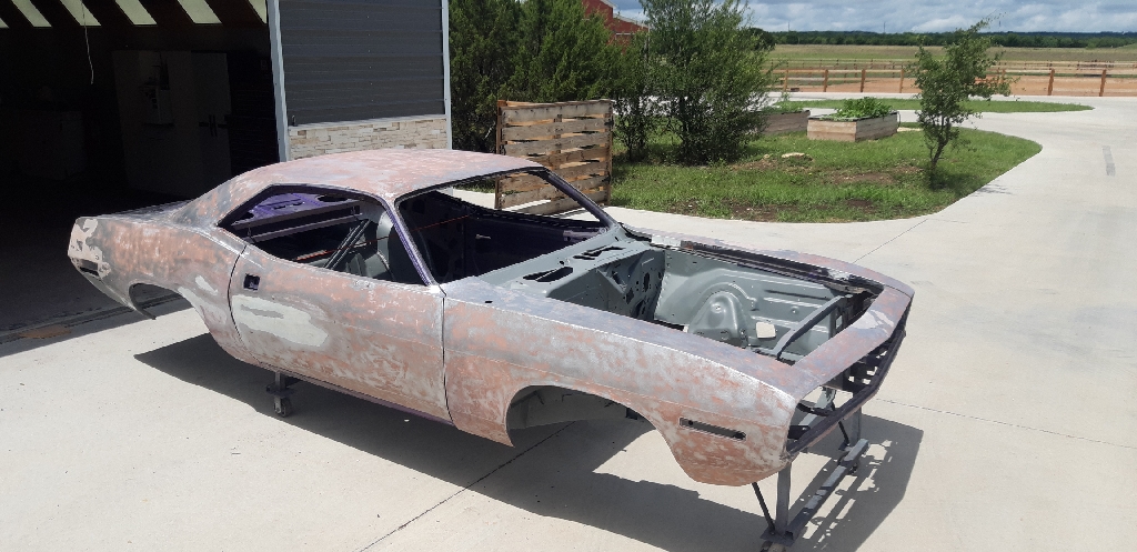

And here's the primer! Had to upload in another reply since for some reason it jammed the site loading all these photos!
Cheers

And then of course, one has to wonder what happened to all that paint. Well, here's the remnants all over the floor, my tools, and up my nostrils. I felt like I was trapped in a Prince movie! Like a purple haze.... "I never meant to cause you, any sorrow.....I never meant to cause yoooooouuu any pain" Yeah.. you know what I'm taking about.
