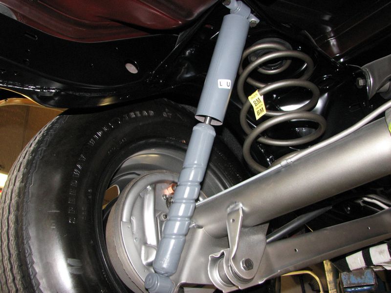

The restored shocks were mounted back on using their original restored hardware.

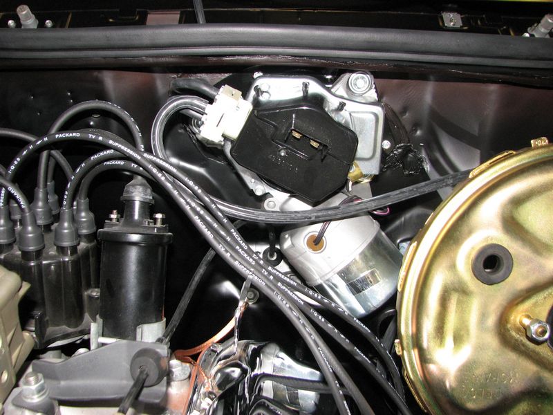

Here is the ground strap that runs from the frame rail to the body mount gusset. This is a reproduction as my original was just too stained but this one was the perfect length and had the correct ends.
Newly restored windshield washer pump, decal and hoses. Also new firewall to engine grounds.

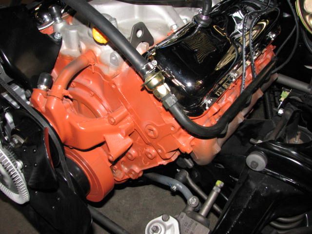

The entire date coded and original GM smog system was fully restored and installed back on the engine today. NO reproduction parts here!

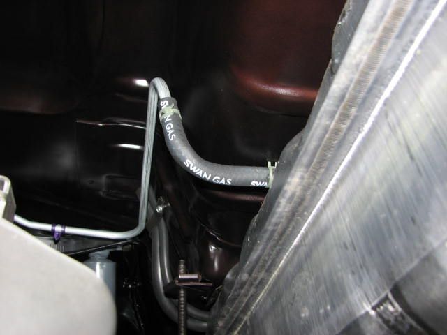

Installed the fuel tank gas line and admittedly not sure if they used "SWAN GAS" in 1969 like they did in 1970 as the old fuel lines were so weathered I could not make out any markings on them.

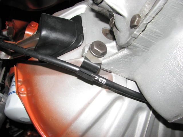

The speedo clip is slightly different than what I am used to seeing on early 70 cars. No one makes this clip so I made it per a photo I received from someone who had this on a similar dated 69 Chevelle.
