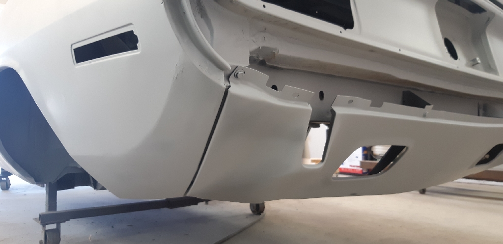

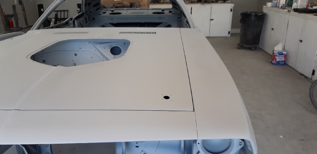

Out comes the 3M dry guide coat and the block party has begun! I was eyeballing the hood and something just didn't seem right. Looking at the rear part of it, the lip actually flares inward at the end. Knowing Steve and knowing I'd never hear the end of it if I returned the car to him in this state, I sliced a little, bent a little, and will weld up the gap to fill in the slice. Presto! A lined up hood! More on that on the next update. I'm very happy with the hood lines and the front of the car is down to 220.
Luckily, most of the dings are on the body line, so that's good.
More to come tomorrow as I hit the doors and roof!
Cheers
Dave

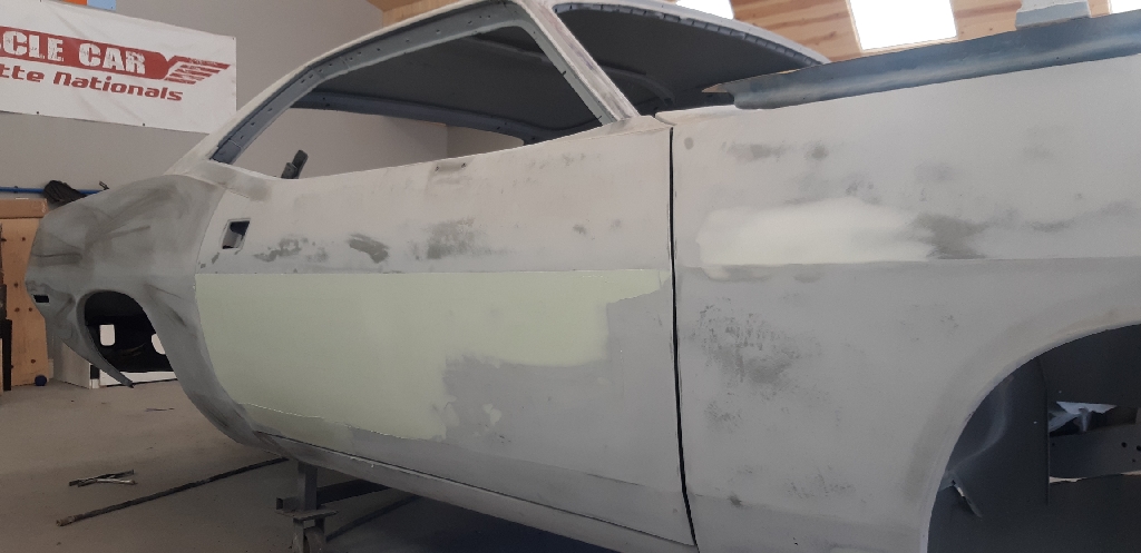

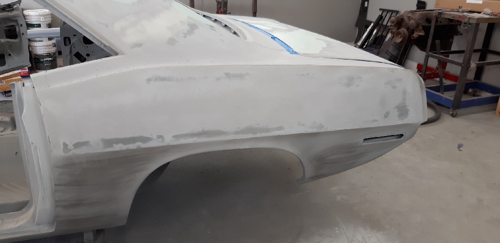

Alrighty, where was I? Oh yeah! Block-City!
As I stated before, luckily all the dings are on the body line But after the initial round of blocking, I'm pretty happy so far.
Round one of pics.... hey? Where'd that body line go?
Cheers
Dave

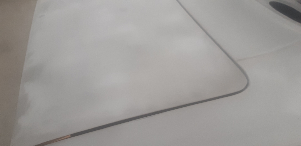

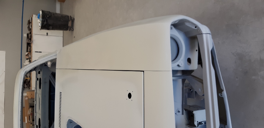

Why, there it is! Of course, after I pounded the door back out then worked some magic on the dents.
Cheers
Dave

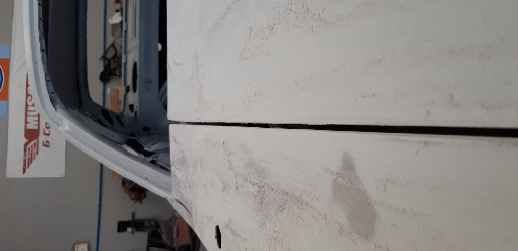

Extremely happy so far. I think....
I'll let this sit then tomorrow out comes more guide coat and 220!

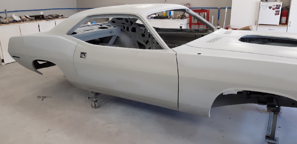

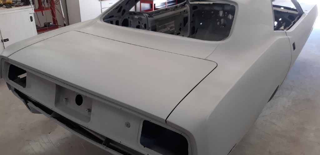

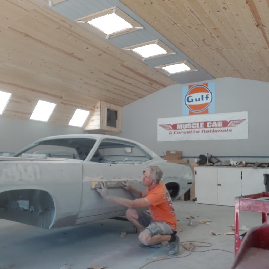

.... block... block... sand... sand... oh what a pain in the a$$ it is! Wasn't there a commercial like that?
We're at 220 but I'm not happy with a few areas so more blocking. I was surprised at the trunk lid. I felt like Red Beard in the Caribbean with all the freakin' waves! A lot more work ahead of me than planned, so it might take another day!
More blocking tomorrow! And there next day...aaaaaaand the next day. Soooo much freaking fun!
Even a few action shots so you know it's me!
Cheers
Dave

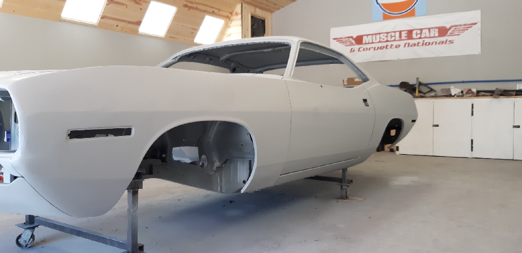

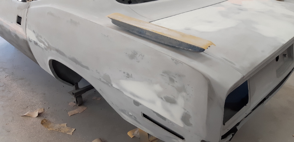

Some more of the other side, then prime. The darker primer is the heavier stuff so I can get those lines crisp. Lighter gray is the 4:1:1 mix.
That's 9hrs today. I think it's refreshment time!
Cheers
Dave
