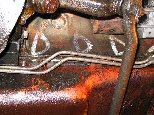

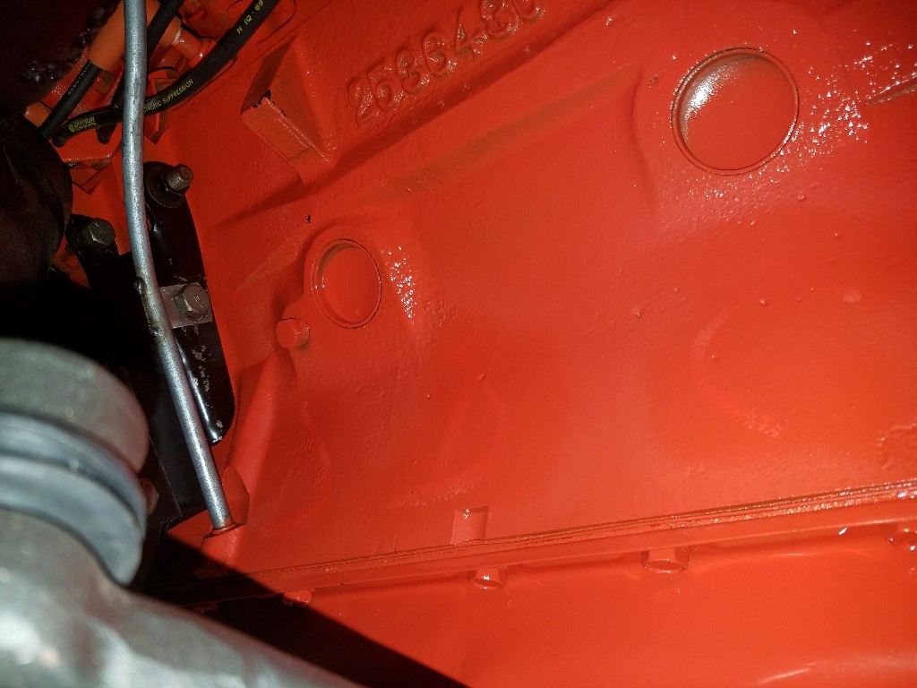

I'm not sure many know this, but I'm going to enter my car in a small, local event called the Muscle Car and Corvette Nationals in Chicago. This small, unknown show, has really been gaining popularity and I figured I'd bring my car all the way from Texas just for the heck of it . No awards or press or anything....just a few cool cars in a room. So with that said, here's some details I did on the Bee.
This first one shows the block bore size markings that were noted each cylinder to ensure the builder knew what size piston in relation to the bore side to get. These were done on the bare block then the hemi orange paint was sprayed over that. The survivor Bee I have pictured, really shows how thin the factory engine paint was since it's all but worn off of this side of the block.

Since the engine was painted either hanging on a chain, assembled minus the accessories, the oil pan shows light coverage and drips. Hey, if there's one thing I'm good at is drips!! Just look at the paint! anywhooo...now yes, I did use a little but too glossy paint since I wanted it to last a bit longer than the stock factory paint. But I think it was worth it. Also, since I three carburetors to mistune and leak fuel all over the engine, I wanted to make sure the paint would hold up.... and single stage works well!
