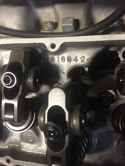

he has no clue really and his exact words are "i dont care, i bought the engine for the heads for my other car"..he does know its an L78 after that he could care less..ive know the guy 10 years and he's always been straight and up front...i believe what he says..he justs wants to recoup some money...and believe me..it aint cheap..thats my concern..i actually said.."WOW,it has a w in the VIN for Nova" and he shrugged, and said it came from a Nova..so who knows...he's a car guy, and could care less about codes etc..he just enjoys his cars....and that is exactly how ya stumble onto odd stuff..
head number..
Mark

Mark, what I was going to posit earlier is the possibility that this engine was built for a very late L89 Camaro (after they started putting C in front of the two letter designation), but since even the late Camaros apparently got codes CJM (auto) and CJJ (manual), I am guessing that isn't likely. HOWEVER, there were other mix ups during that time period. AND late 69 Camaros and early 70 Nova's shared a subframe, so F and X body stuff was mostly interchangeable up until intro of the 70 (what some guys call the 70 1/2) F body. So, just to be safe, I would take a jeweler's lupe and inspect the area down by the starter very carefully. If there is even a hint of an N stamped any where down there.... well, you know. The engine assy stamp could be legit and the Willow run partial added later.
Personally, I would like to see it confirmed as a true 70 Nova L89. Not sure what the engine block is really worth without a car though.

Is the broaching consistent across the whole pass' side deck surface?
Again run the Vin through the NCRS service for delivering dealer info, more clues are what's needed and the result may lead to others etc.

yes the broaching goes all the way along both decks and are consistent and straight..first thing i looked at..i have pics, but really whats in already posted is relevant...the rest i have really ads nothing else to the conversation
