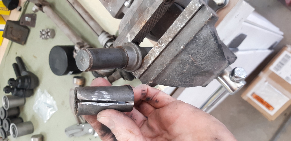

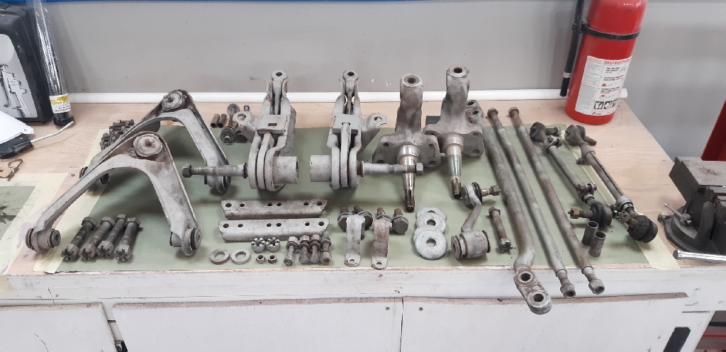

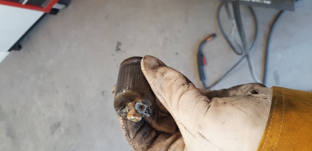

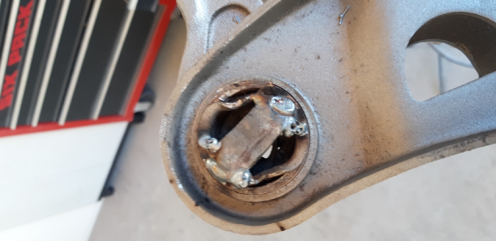

But meanwhile, the suspension is all blasted and new bushings installed in the lower control arms. First step is removing the pivot shaft which also removes the inner sleeve of the lower bushing. That gets a slight cut and then separated with a chisel. Soon as it rotates it pops right off. Then it is time to remove the rest of the bushing. It works best to beat the lip of the bushing edge over creating a flange which you can weld a piece of 3/16 plate steel too. Install in the press upside down, 1/2 piece of rebar through the opening, then press the bushing remnants out!
Installing the new bushing isn't too hard, but installing the shaft is tricky since you can push the inner bushing back out. Installing a 11/16 deep socket as a stop allows you to press the shaft in all the way down (ohhhhy yyyyyeah, baby!).
Final detail on these parts tomorrow but the cosmoline won't be here for the LCAs until Monday.

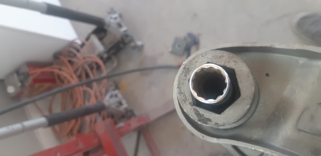

Thanked 4,607 Times in 1,139 Posts

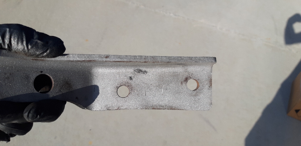

Here's a pic of the pivot shafts getting pressed in and how the socket fits. Also found remnants of red paint on the end link adjuster nuts. My Bee had these as well. So it appears a dab of red on the nuts after inspection? Jim... you seen that before on the 70s?
Then after blasting the tie down brackets, I noticed this one had H7 on it. I think this was probably labeled incorrectly or it could be a H for the "Hind" area, since they are installed on the rear frame rails. 7 could be the 7th version of this thing since they probably changed the design monthly to screw with restorers 50 years later.
....but then I flipped it over and realized it was LH for left hand.

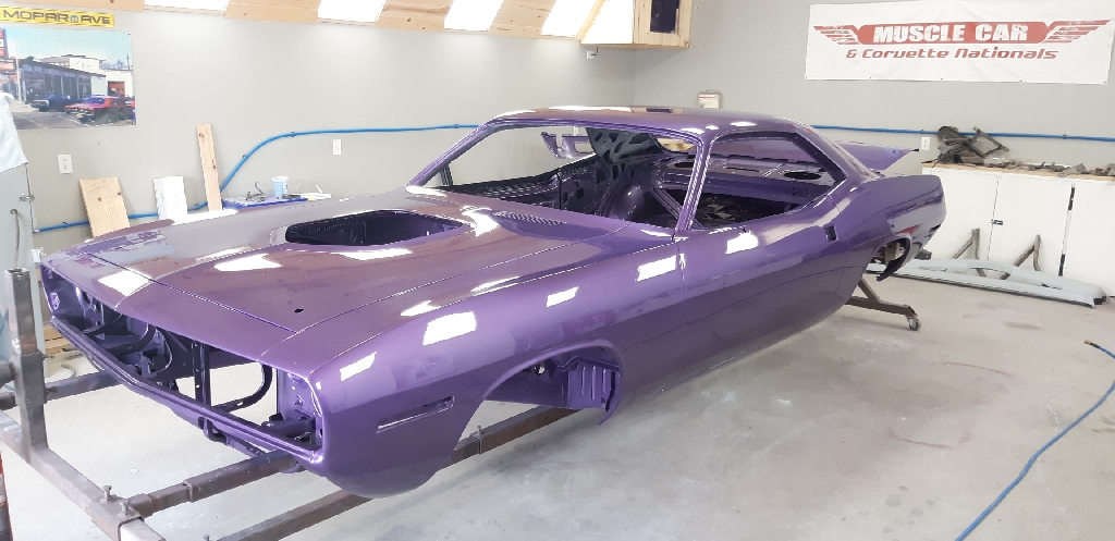

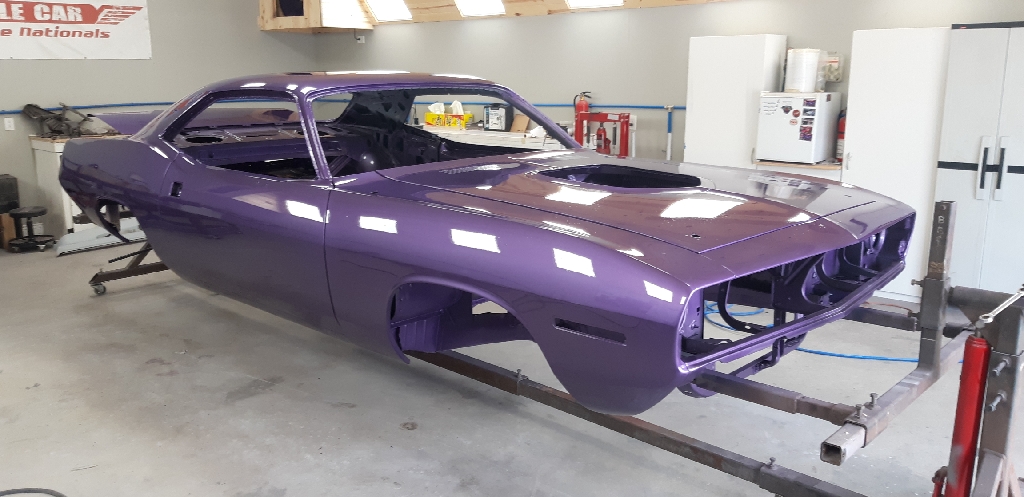

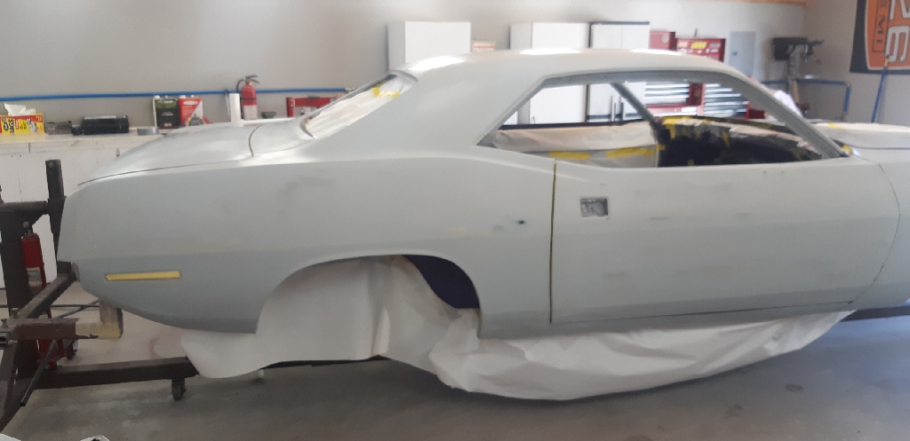

Paint!!
Now I need to cut out the 21,643 bugs stuck in it

Yes Dave - seen that a few times.
Also the adjuster arms are always dipped with a certain color paint. sometimes both sides are the same color - sometimes not....weird. I usually see blue and/or orange. I'll try and dig up some pics....
