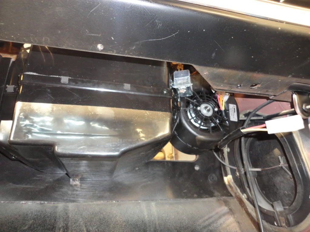

Had a good day today.....Didn't have to deal with any repro stuff....Got the new A/C set-up from Classic Auto Air installed on the inside of the car.....wired and mounted.....Easy day....LOL
