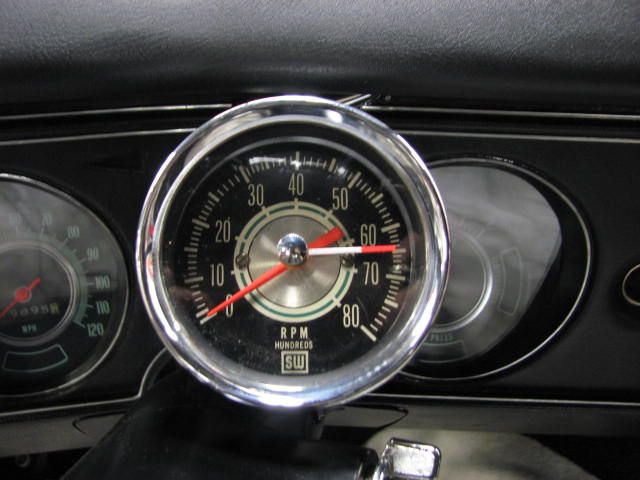

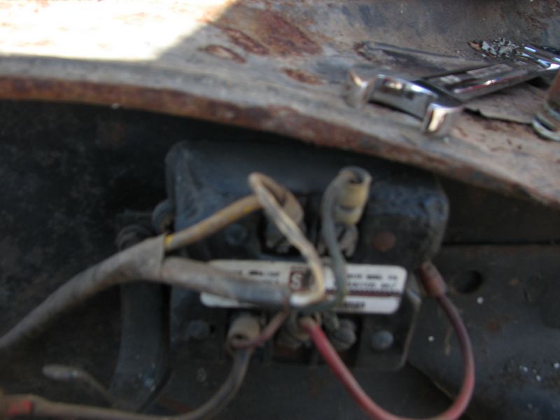

I had a very nice pedestal tach that I had bought from Dana and was pretty happy with it but thanks to Mark Bulow for pointing out that the face was somewhat abraded and the needles were faded I went out and found one thru Albert G. It does look much better so I am glad he pointed it out. In addition and thanks to Jason I was able to trade up for an NOS monitor and as of two nights ago we got it wired up. A little neater than what Yenko did but safer and we used the same style connectors, tie wraps and tape that he used. The exact same wire loom he used (Ma Bell phone cable) and yellow 'lights' lead to the fuse panel was used exactly like what was done at Yenko.
Also, the original hole that they punched thru the firewall was reused. Oddly enough, the triangular plastic factory plug that is on the other side of the wiper motor and had an "X" cut thru it as if to run a cable thru it was not used. Maybe they did not have enough length in the wire and said screw it, lets just punch a new hole in the firewall and run it thru there. Right, wrong or otherwise that is how it was found so that is how it got restored. HOWEVER.....and I just realized it while posting these photos that the yellow 'lights' lead was electrical taped to the main harness so that will need to be corrected.
I fixed and updated the wiring and it now matches the original. See last photo.

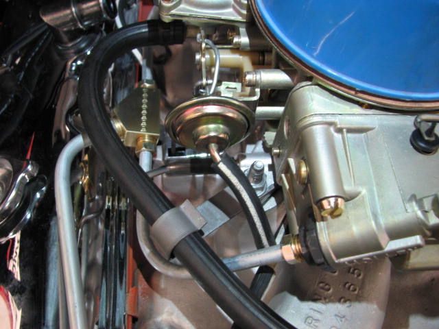

An assembly line correct heater hose bracket was found in my inventory (as I did not find one with the car) and after much research and thanks to several members, I determined these were used on the 69 Baltimore cars so it was restored and will now be installed.
The assembly line fuel Y block I received from Chris.

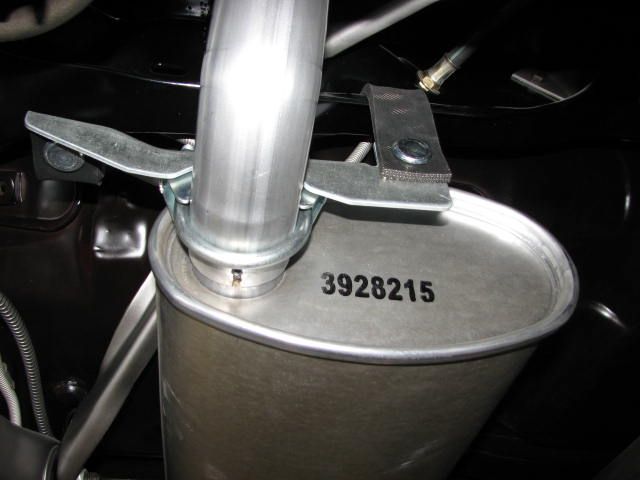

The belly of the car is pretty much wrapped up. Decals applied, everything adjusted and tightened. Ready to put on the ground and finish the topside. I am not totally done with the battery cables (they are great reproductions courtesy of American Auto Wire) but do not have the factory correct ends so I need to correct that. As in the past, if anyone sees something that looks incorrect to them please do not hesitate to bring it to my attention. Many people have sent me notes and corrected me on things I was not aware of so by all means speak up. I do not have a problem with constructive criticism and am always happy to learn something new.

Is the SWAN 3/8 ths fuel hose used in 1970 also? Is it used in other plants also?
1971 Boss 351 , 17,000 miles .. 1971 Buick GS455 .. 2003 SVT Cobra .. 1971 GTO .. 1969 Camaro Fathom Green .. 1969 Camaro Hugger Orange .. 1970 Buick GS455 .. 1970 BUICK GS350 .. 1998 SVT Cobra 1900 miles;. 1973 STAGE 1 GS . 1971 Mach 1 351C 4 speed , first car. 1970 Mach 1 428 SCJ . 1970 SS 350 Camaro . 1971 442 ... 1968 Buick GS400 . 2015 Lexus IS 350 F Sport 2021 Badlands Bronco Sport
  #529
Old 03-27-2019, 05:08 PM
SS427's Avatar
SS427 SS427 is offline
Location: Pleasant Plains, IL
Posts: 10,304
Thanks: 3,036
I have seen Swan Gas stamps on pretty much Baltimore cars only in 1970. I have no experience with the 69 but used it in lieu of no markings until I find out If they used something else.
