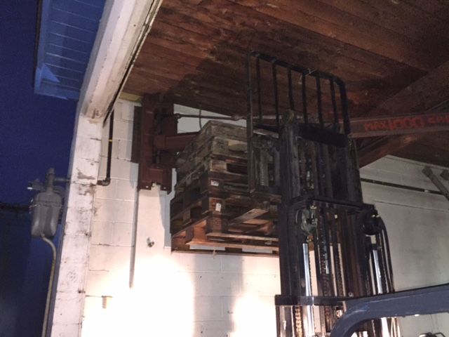

One of the building features was a swing crane installed at the front door. I really wanted to keep this both for historical and future use purposes. On closer inspection it interfered with our gas line and it impeded the installation of a new overhead door. It had to go!! Our neighbour Greg assisted with his forklift and we had to cut off the bolts that ran through the block (nasty job). Bye Bye Crane.

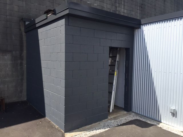

On the left is what we called the boiler room:
This is what we took out of there:
Then we took the chimney down.
http://vid285.photobucket.com/albums...psiplpypf5.mp4
Painting came next along with new facia and soffett:
Everything painted out:
Inside was painted a bright white:
This will be home to the compressor, steel shelving for items we don't need in the shop.
Air and a outside water lines will be plumped into here.
www.vancouverclassiccars.com

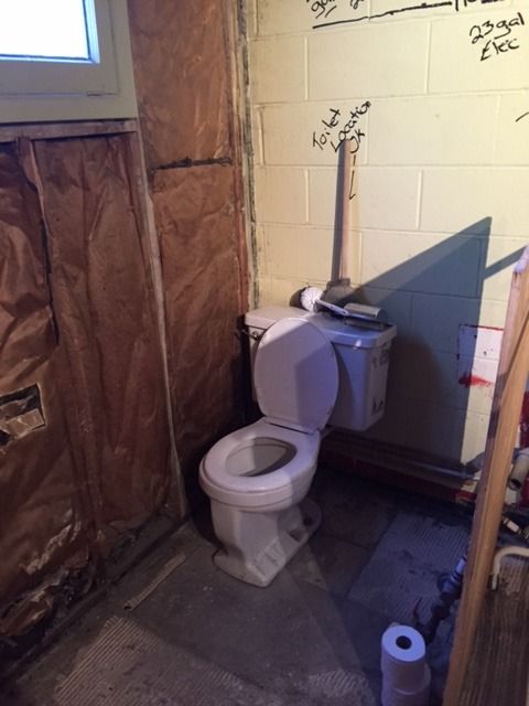

Here are some early photos of the three washrooms during demolition.
All unnecessary walls removed, all we had left was the &quot;prison toilet&quot;.
With Privacy screen.

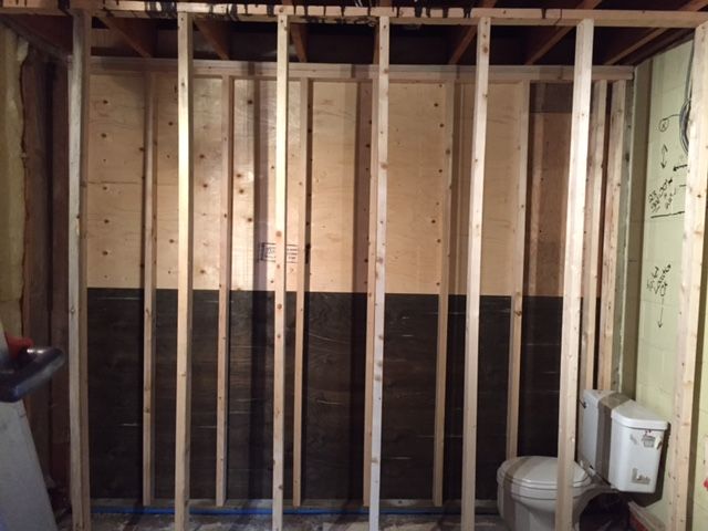

Lloyd and I were facing busy work schedules for September and had not done a lot in August due to vacations and other commitments. We decided we were going to demo and rebuild the exterior wall on Sunday Aug 28 with and early start and a commitment to get it closed on the same day:
7:00 AM new temporary support wall built into place.
Pass through was created for building materials extra TP and reading materials. Coincidentally it looked like a mini church window and given the fact we worked on Sunday this was as close as we got to being reverent.
By 8:30 we had the old wall down, you can see the rot at the bottom below the window.
After cleaning, we stated building the new wall for tilt up. We got to this about 1:00 PM after a trip to Home Depot to pick up additional material. See sections of the old wall on the driveway.
We used pressure treated 2x4 on the bottom plate, then wrapped in Blue Skin waterproof membrane and with a Butyl rubber seal at the bottom.
  #60
Old 08-29-2016, 09:51 PM
Canuck's Avatar
Canuck Canuck is offline
Join Date: Jun 2005
Location: Vancouver BC
Posts: 1,918
Thanks: 242
Thanked 744 Times in 248 Posts
Default Re: Canuck and Edgemont Villages new Shop
Our old wall was made up of 2x4, then a horizontal 3/4 inch t and G siding, a 3/4 shiplap vertical siding, followed by a Styrofoam :insulation&quot; and them Vinyl siding. In order to keep the same thickness for the new Vertical Metal siding we would put on we needed to double sheet 3/4 inch plywood to keep the outer surface even.
The bottom sheet is pressure treated 3/4 inch plywood and the top and inner layer is 3/4 inch sheeting grade.
By 6:00 PM we were done, all closed in and we are ready to resume work on the bathroom, Wet room and exterior wall as time permits in Sept and October.
Inside view finished.
