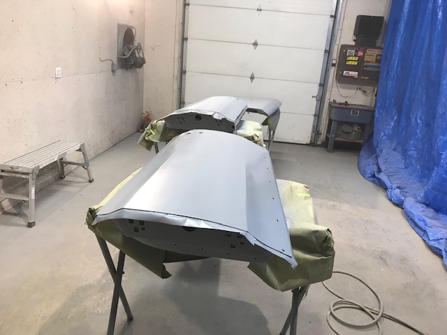

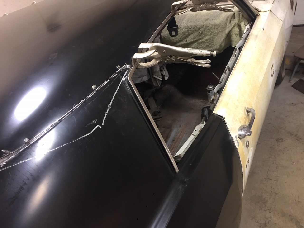

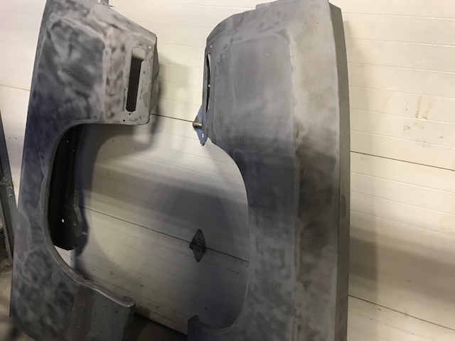

I'm slowly picking away at the panels. I repaired a couple of small spots on each door and got them into epoxy and high build primer. While the panels where drying I sand blasted both from fenders.

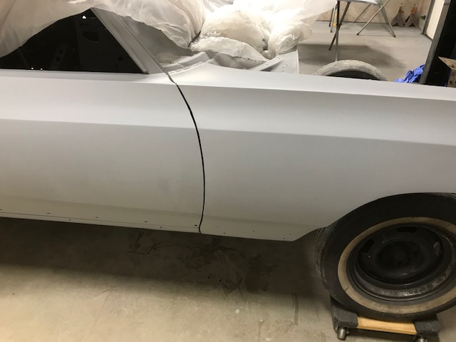

I'm picking away at the Monte. The reassembly process has started. I did shoot some cards for Jeff to try and figure out what blue the car will be. Very happy with the panel gaps so far.

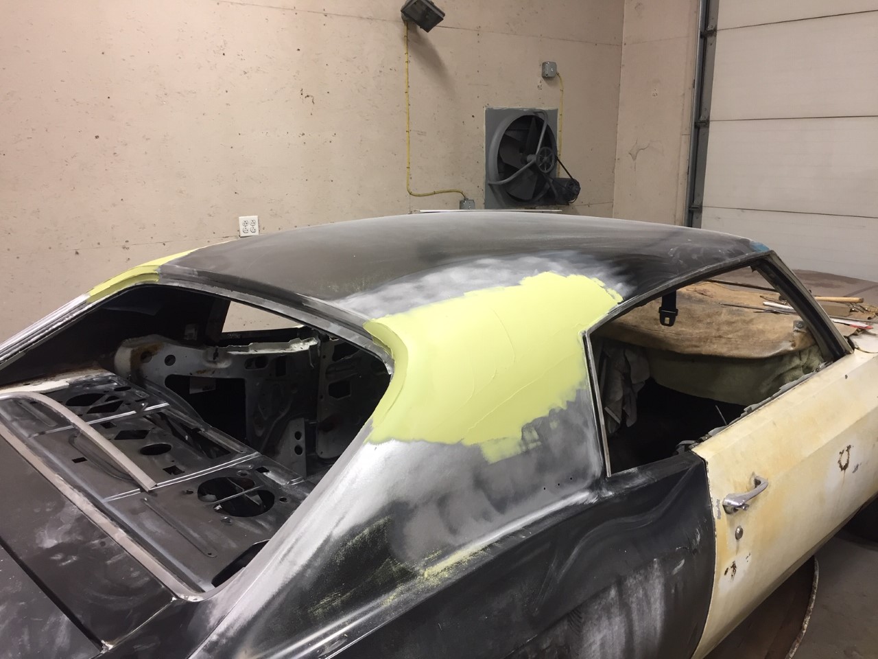

First round of overall blocking complete. Another coat of high build primer tomorrow. Once all the panels are to my satisfaction I will disassemble for final top coat. Jeff wants the front end all rebuilt so while I have it all apart I'm going to detail out the engine bay.

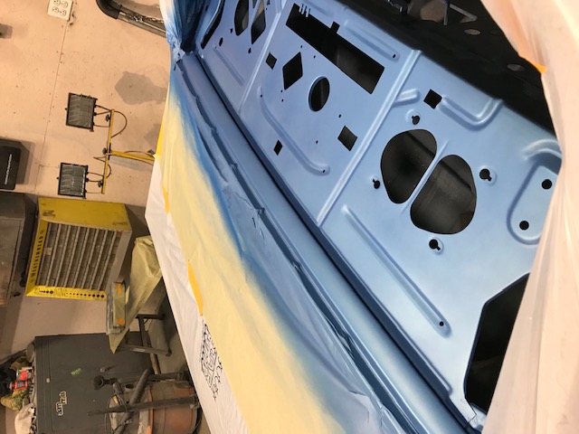

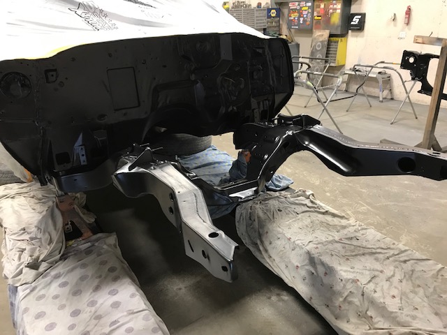

Been a busy month. The disassembling of the front end, degreasing and sand blasting all the small parts sure does take a lot of time. Epoxy primer was applied last night, top coat tonight.

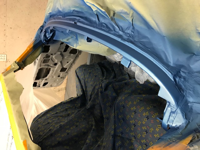

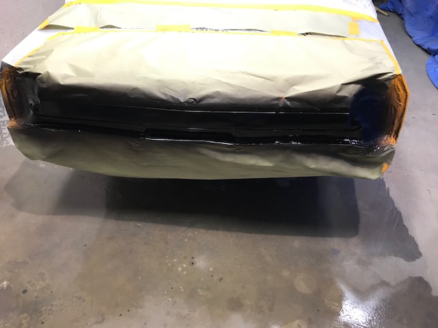

The front end is all back together. I'm just waiting for the backing plates and caliper brackets from the platter. Power bucket seats have been installed. I applied some color this weekend. Medium blue to the interior and blacked out the rear tail panel like the 71 SS.
