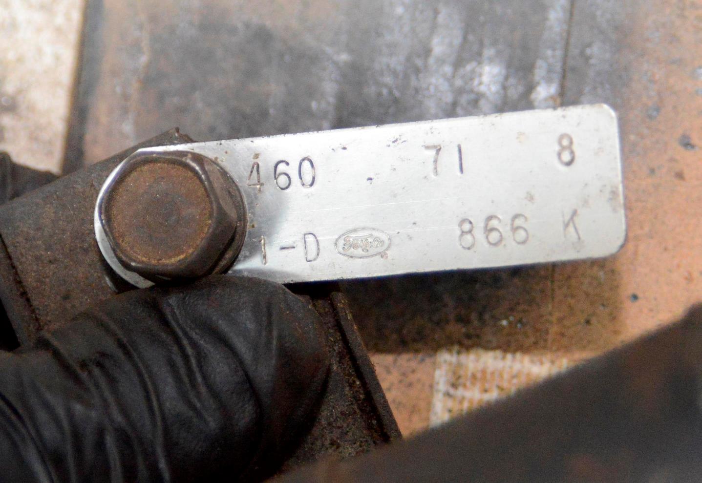

Originally Posted by Charley Lillard View Post
429SCJ where do these tags go ?
The silver tag is the engine ID tag that bolts onto the coil bracket. Here's the one on Grampa's Lincoln
