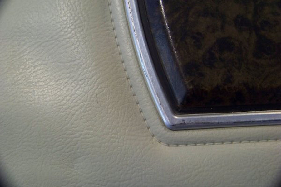

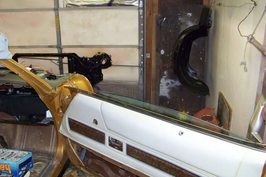

I am looking for any REAL Neutral Comfort weave material that anyone may know about....
I believe early 70's
First two are the original door panels which had been MARHYDE painted black, I cleaned them with a tooth brush and Goof Off, it took over a half gallon to remove the Marhyde.
The second two are an ORIGINAL low mile Neutral Comfort Weave interior - code 788 - I can only hope the interior turns out anywhere close to this nice....
