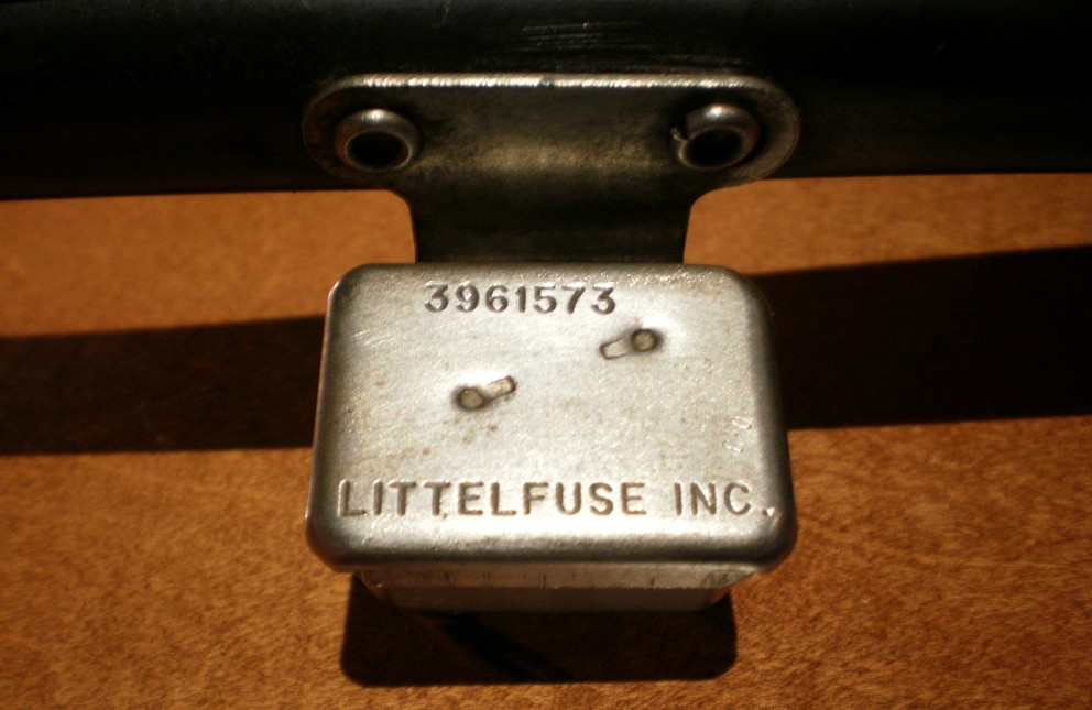

I pulled a Purple/Black wire with an end connector from the back of the cowl wiring gutter, what was the purpose of this wire?
[img]<<GRAEMLIN_URL>>/biggthumpup.gif[/img]Like the fresh weekend pass hanging on the wall from this years MCACN show [img]<<GRAEMLIN_URL>>/naughty.gif[/img]
  #68
Old 12-15-2011, 09:49 PM
Posts: 20,896
Default Re: 1970 Chevelle SS 454 LS6 Rebuild + Details
That purple/black wire connects to the Transmission Controlled Spark #3961573 kick down relay rivited to the gutter.
Of the 3 terminals on the gutter mounted relay,it fits to the passenger side terminal,nearest the firewall.
The wire should have a female end to slide onto the male spade.

<div class="ubbcode-block"><div class="ubbcode-header">Originally Posted By: Mr70</div><div class="ubbcode-body">That purple/black wire connects to the Transmission Controlled Spark #3961573 kick down relay rivited to the gutter.
</div></div>
Thanks Rick,
so it would go like this correct?
I wonder why the last owner did not have it connected?
Also photo shows the pedal wires, is everything correct down there?
