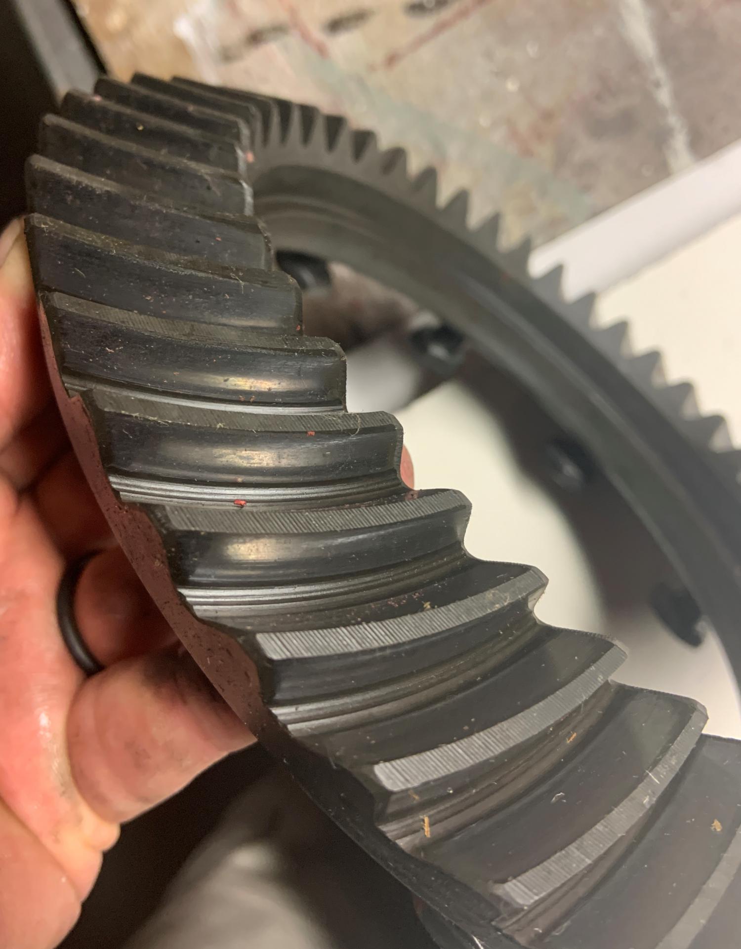

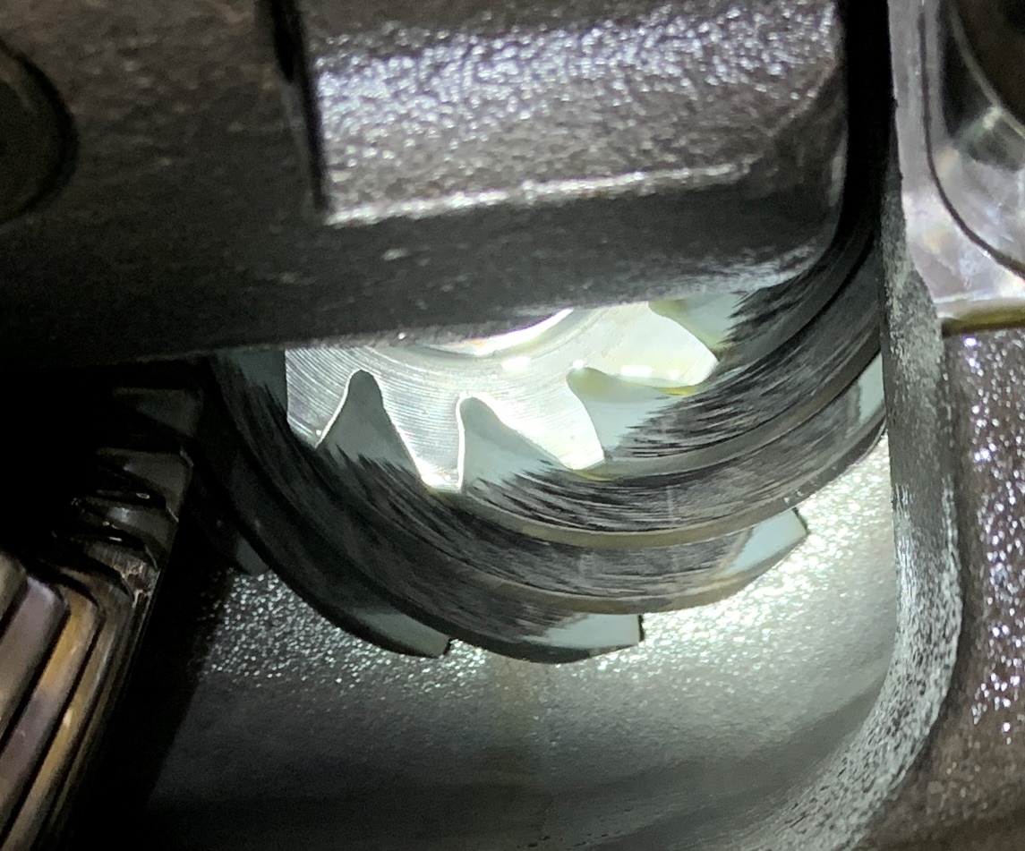

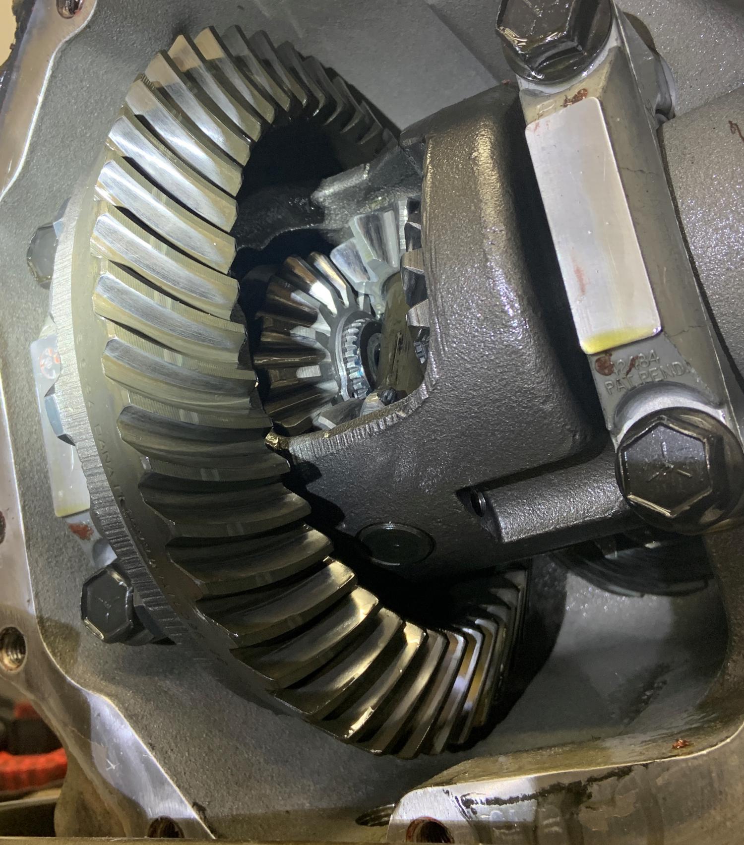

Ok, so who is good at diagnosing gear patterns here?
Looks to me like the ring gear and pinion have been devouring each other. Also, I can hear that loose roller in the pinion bearing when I turn the pinion flange and the is a bit of clunky backlash in the pinion. Much more than the NOS rear has.
So did the bad bearing cause the pattern to change or was that a byproduct of the gear pattern being set badly and the the contaminated fluid ruining the pinion bearings?

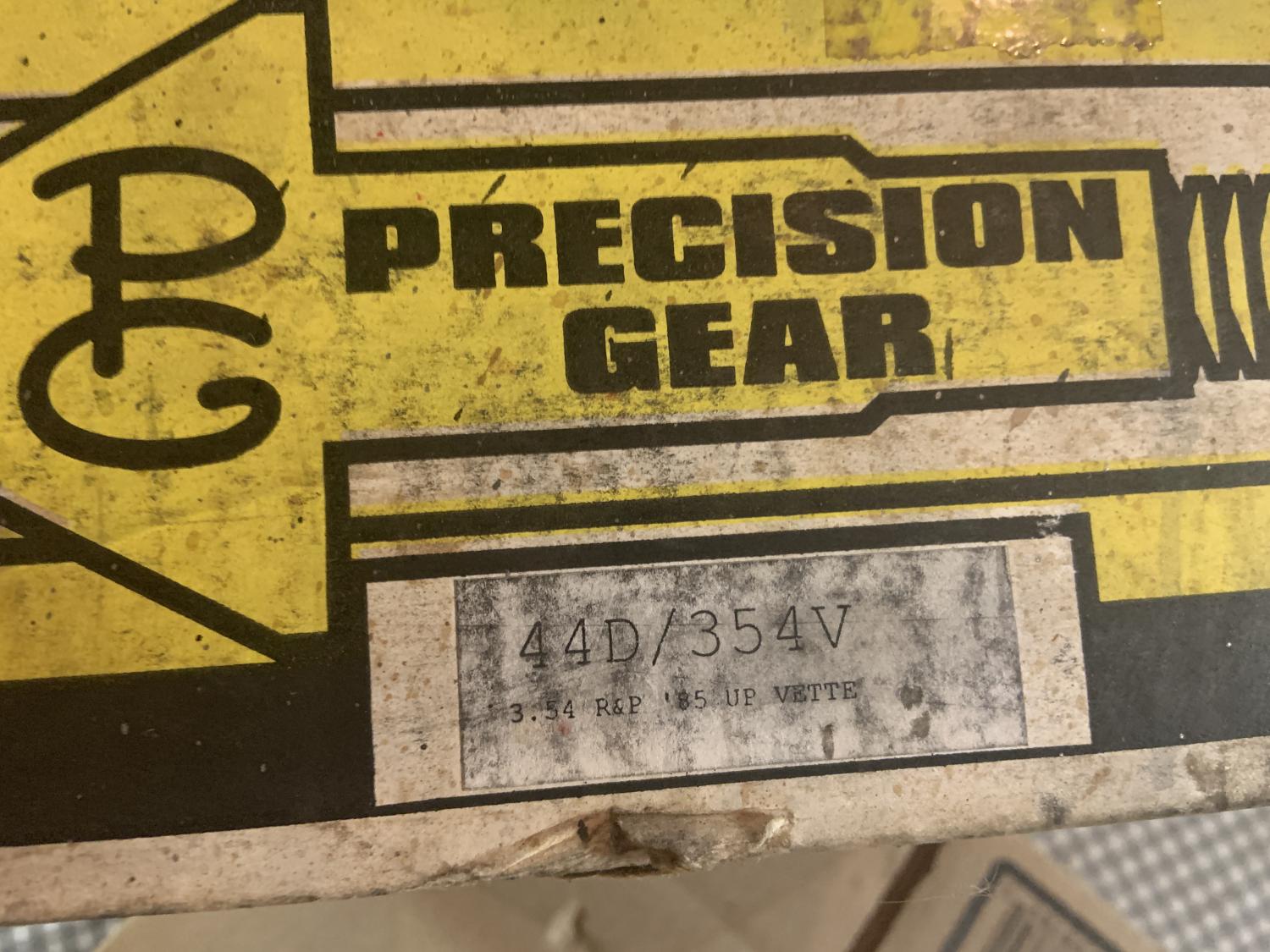

I rechecked my old pile of records and it looks like they were an aftermarket set of 3.54 gears I had installed back in 1999.

At least I got some new wall art out of it. And luckily I kept the original set of 3.07 gears that I took out at the time. If I want to get this diff redone, I'll just use that set and get it all refurbushed.
And here's the original set of 3.07 gears from basement for comparison of the wear pattern.
