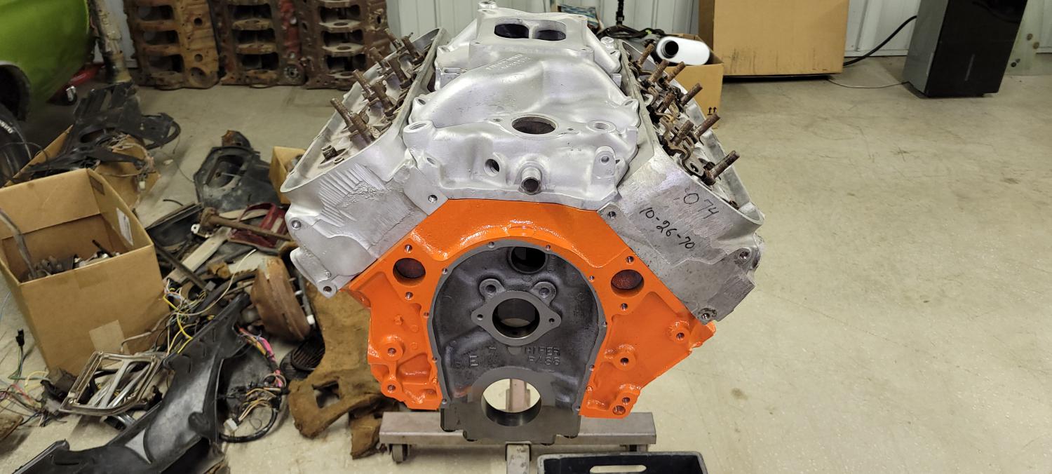

Not really. Still working on the quarter. I stopped work to install a new storgae deck in the attic of my shop. I also worked through starting 3 different l78 motors including my own for my 66. I should be able to get back to the car during the holiday.
The motor probably wont go off to the machine still till the late spring. I wont need it to next fall at the earliest. Here is a picture of me checking out the intake to head alignment. I snagged some 074 Zl1 heads as they are dirt cheap compare to the 842s. They look virtually the same from the exterior. Gonna have to probably get custom pistons made to eat up the huge open chamber these heads have to get the compression about the 11:1 i would like to see. Heads are nice and clean. No fixes to the rocker studs, no porting, and someone didnt deck them down to nothing, although i make have the shop take a heavy cut to shrink the chambers.
