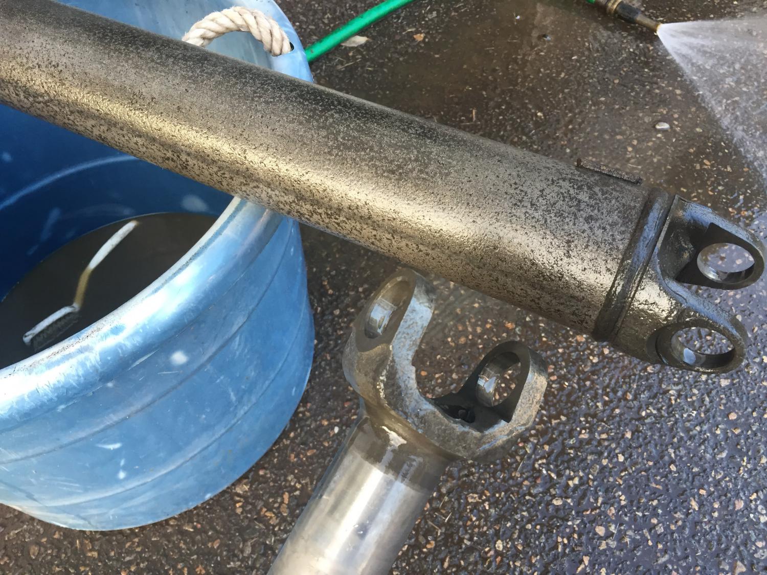

More progress a day later. I bought two gallons of evaporust today at the local advance auto. And lo and behold one of them was filled with water. So I am returning that one tomorrow. Nice!
So I dumped out the old used up evaporust and scrubbed the driveshaft again and replaced it back in the tube with the one real gallon I bought.
Here's how they looked today:

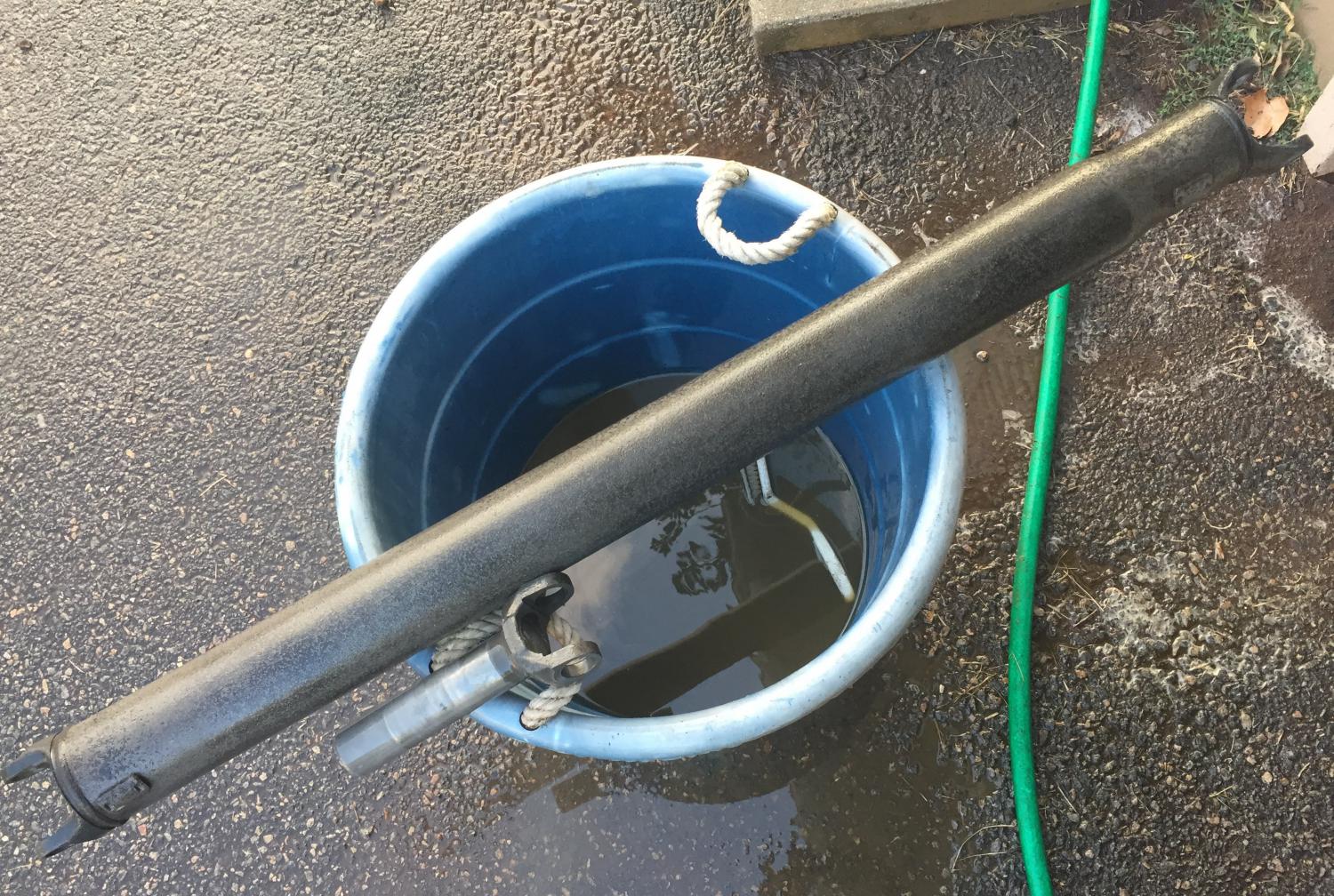

And day 3 after an overnight with a fresh gallon. Now that's some progress as compared to the old stuff.

The question is what do you do with the nasty liquid with the junk in it when you're done?
  #725
Old 10-01-2020, 02:45 AM
SS427's Avatar
SS427 SS427 is offline
Location: Pleasant Plains, IL
Posts: 10,304
Thanks: 3,044
The liquid itself is harmless and biodegradable and can legally be dumped down a drain. However, the solids in the waste will dictate disposal. I seperate the solids from the liquid before I dump it.

You can extend the life of the liquid by straining it through a cloth with a magnet in it. It pulls away some of the iron and gives a longer life to the liquid because the liquid will continue to work on any remaining iron residue, 24/7.
