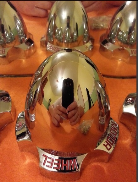

This was an NOS set that sold for $1500 a couple years ago
  #762
Old 10-20-2020, 03:21 AM
Posts: 12,381
Thanks: 18,513
Nicely done Steve and thanks for sharing the details!
First glance at the pic w/ rear glass on the chair pad I thought ModTop, love Spyders too and can't wait for the end result.
