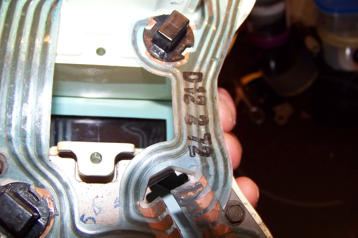

My printed circuit board was DELAMINATING so after removing it.
1. I got out a sheet of parchment paper (NOT WAXED PAPER) and
2. an old clothes iron, set it to the lowest and worked up until somewhere around 180 deg.
3. Put a hand towel on the granite counter and
4. laid the circuit board down over the towel
5. laid the parchment over the plastic circuit board
and then IRONED it back together...
It took a while as I worked slowly with as low a setting on heat as would make it stick back together rather than risk melting it. (the first time it was only 125-130 deg and it was not hot enough.)
