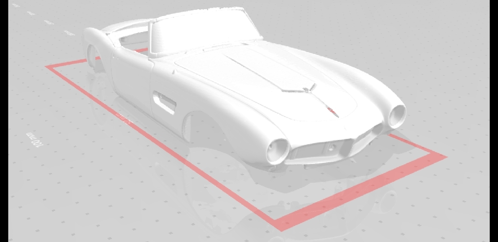

The meeting today was a complete success and Mike is just about as excited as I am to see the completed body buck! Due to the holidays coming up, I probably won’t have the CAD file until Mid January. I’m also working with a CNC company that will router out the panels. Mike and I will finalize the end design with a few keels along the longitudinal axis that will keep the buck straight during assembly and also aid in panel formation.
The 3D scanning technology is amazing. Time to jump back in the other projects while this moves forward!

The scan is done and it's moving forward to dividing the model into stations now. Woohoo!

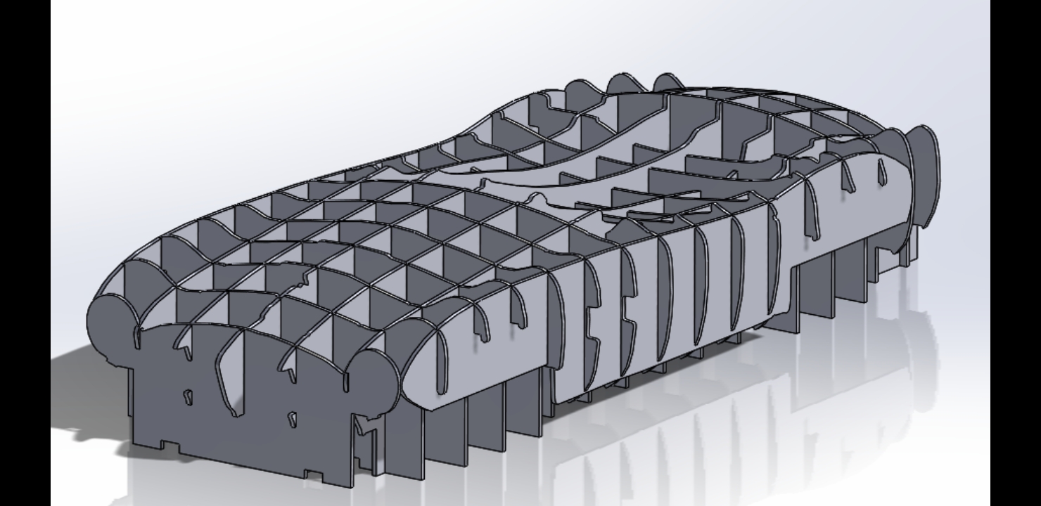

More to come...they’re almost done with the CAD design. The latest email showed me the placement of the body buck stations as well as the stringers that will run longitudinally down the body. Think old-school style Gullows balsa wood model plane.

... and this is what I mean! I got this email yesterday and it's identical to what I envisioned. I think we're pretty close to being done with the CAD work and then it's onto getting it sent over to the CNC company to router out the design in 3/4" plywood.

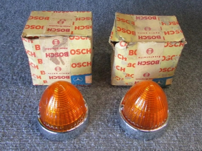

I acquired some NOS Mercedes bullet style turn signal
lenses and a few other small parts. Coming along nicely! I hope to have the body buck assembled in March and should be in paint by June

Ha! Good one Freddie! Parts collection continues, and I picked up set of NOS Mercedes W108/111 turn signal bases, lenses, and bezels. They're very close to the 507's although I'll have to make my own base extensions. That should be easy enough to do compared to making the whole of everything else!

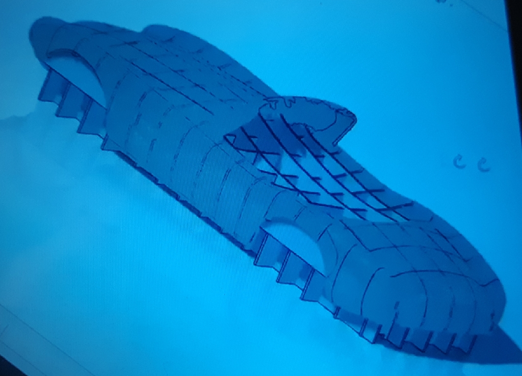

More progress progressing forward! Latest feedback from the CAD people is this rendering which shows the skeletal sections under the sheetmetal body to verify fitment. What you see it's what I'll be getting out of wood, both horizontal and longitudinal. All parts will interlock and they'll be a keel down the center foot rigidity as well as alignment proposes.
This is a snapshot of a video they sent me, but I'm technologically challenged with trying to upload this tip YouTube. But fear not! Videography at it's finest will be forthcoming!
