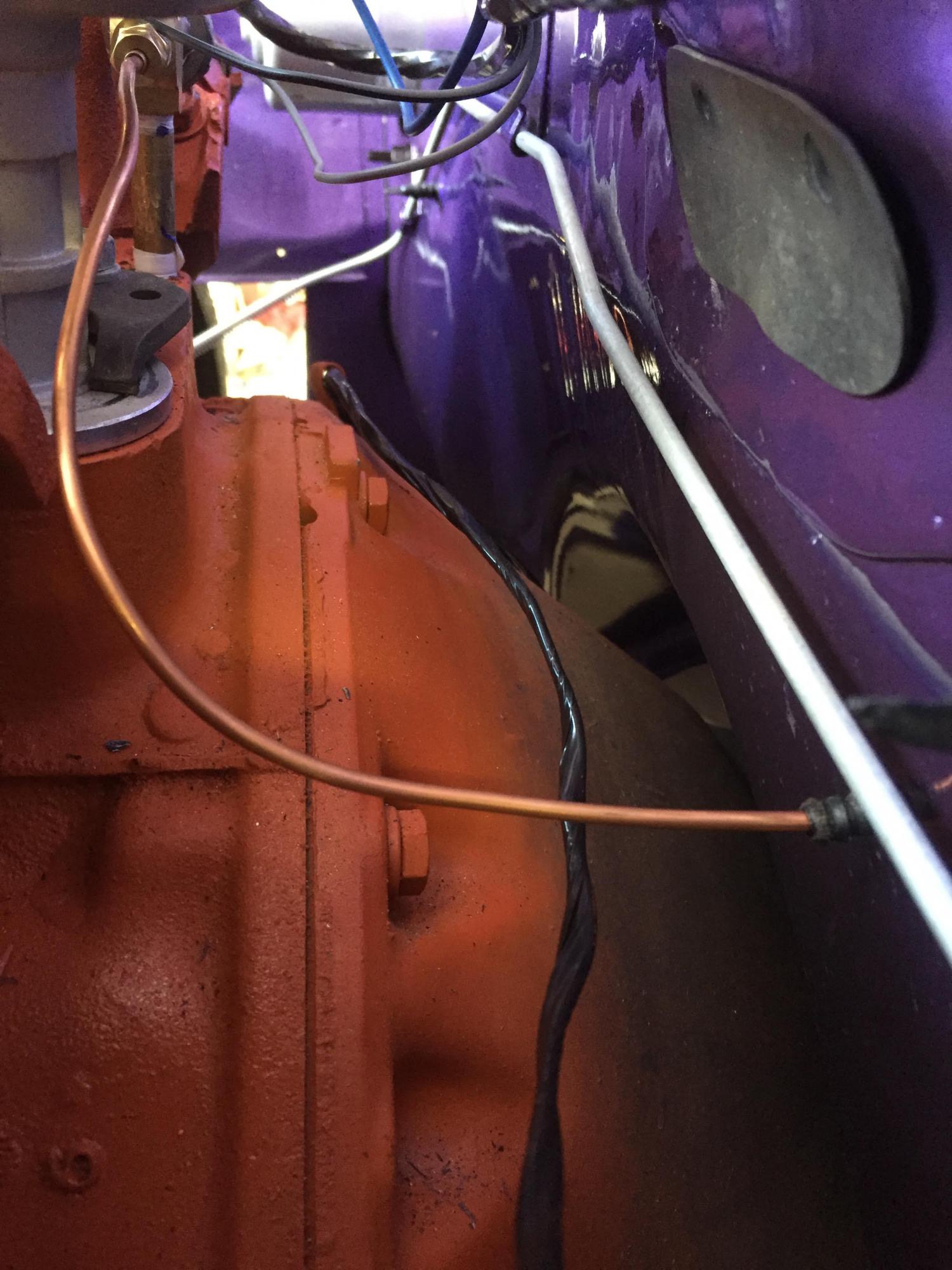

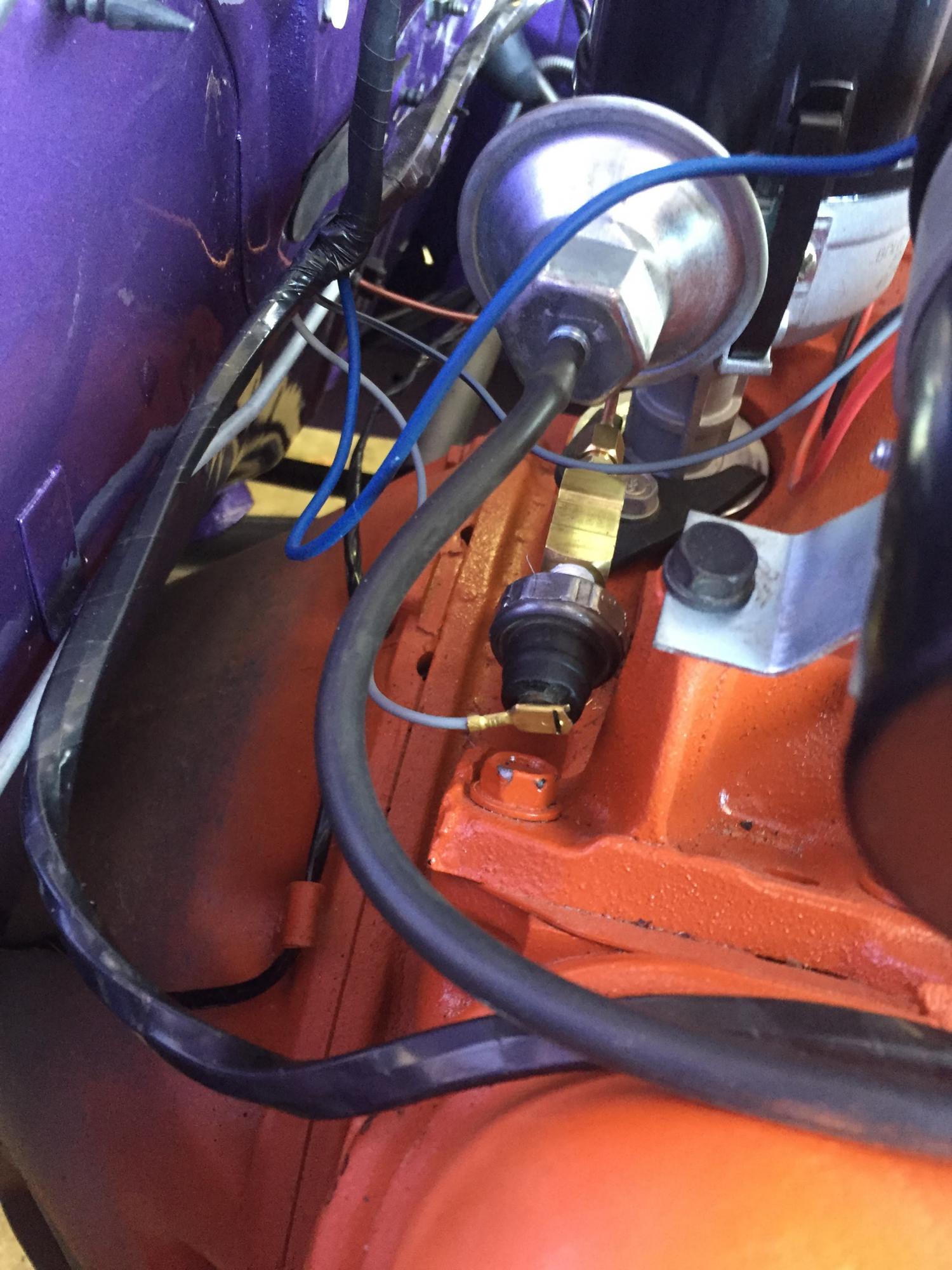

I spent the day finagling with the dash and installing the copper oil pressure line. I was able to create a T-fitting with some brass fittings and the original idiot light sender. I then routed the copper line through one of the plastic push through cowl insulation clips. I just snipped the pointed end off and the copper line fed right through, very close to where it needed to connect to the fitting. I installed the Stewart Warner oil pressure gauge in the instrument pod, which had to come halfway out of the dash to access. Once I get the tach installed tomorrow, I will post some better photos of the dash area

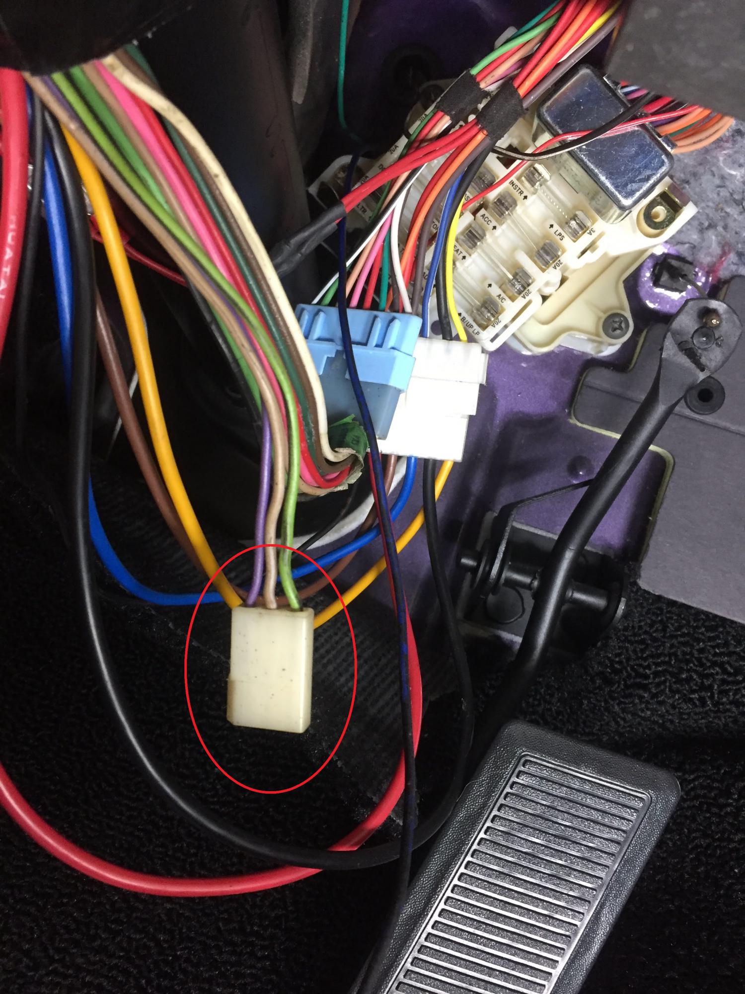

And here's a question for you E-body wiring gurus...any idea what this thre wire connector from the column goes to? I can't seem to find anything under the dash. The wires feed off of the turn signal and hazard assembly.

I got an answer from the E-bodies.org forum. It's the connector for cornering lights on a C-body car. Looks like someone replaced the turn signal switch back in the 1970's with a superceded Chrysler part that covered several applications. So it will just hang there and look lonely from now on.
