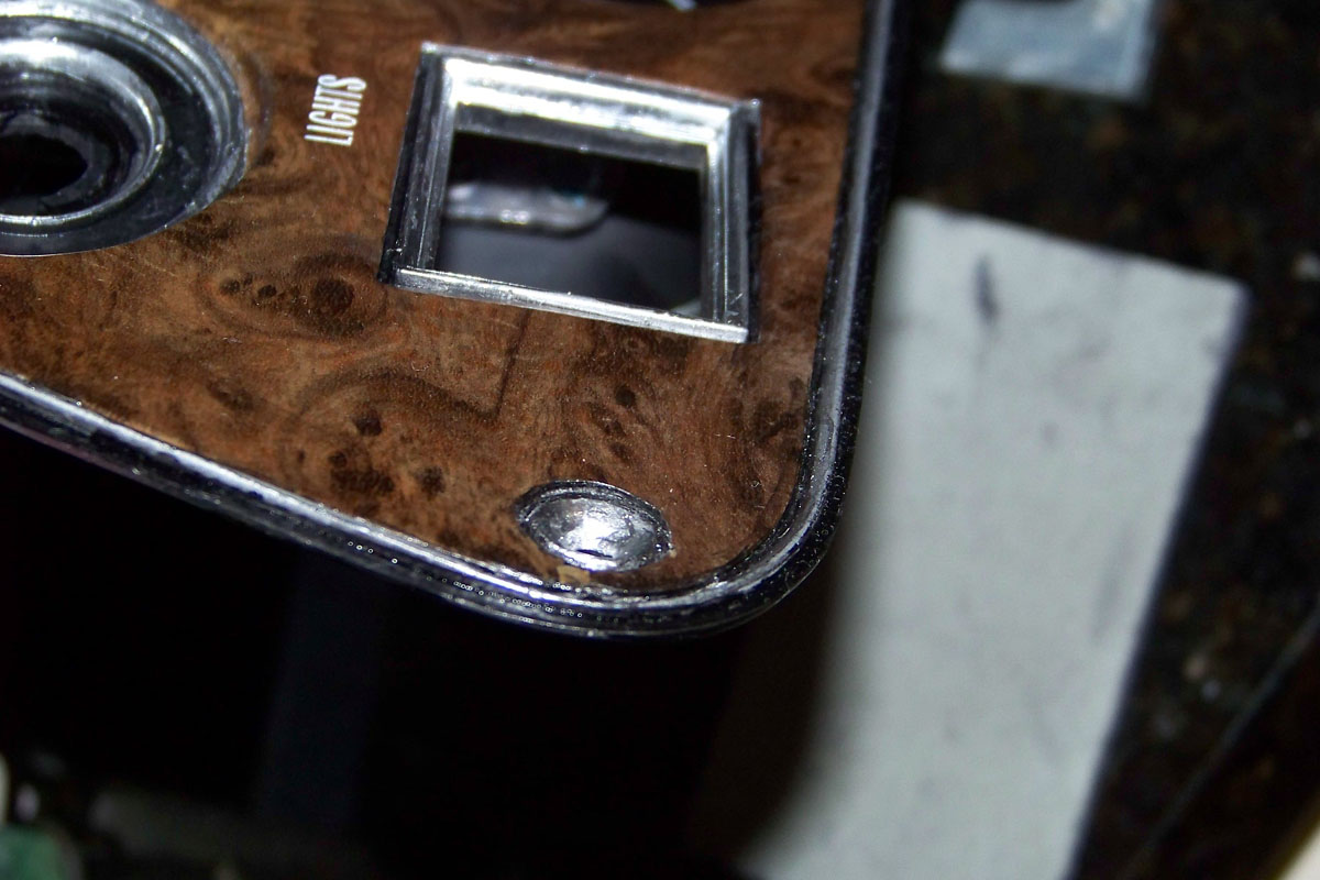

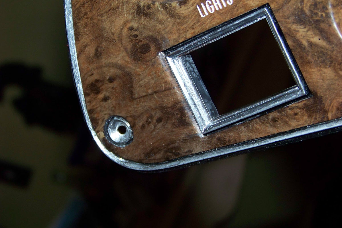

The wood grain is a pain to remove. Every inch of it has adhesive. Took me about 4 hours with a real thin blade. I then sent the thing out to be metallized and then had to mask off the edges with petroleum jelly. Then spray black. Got about 20 hours in the thing. I did this on mine about 20 years ago and it is holding up well.

I am going to try this out on my bezel. https://www.youtube.com/watch?v=mqZgAy6kRG0&t=60s

I've got one of those pens, just haven't gotten around to trying it on anything.
Here's the one I got:
https://www.amazon.com/Molotow-ONE4A...WG7T5S3R3RP2E5
Here's another vendor:
https://alsacorp.com/
And a video of what appears to be magic:
https://www.youtube.com/watch?v=GY0iNcApC8s
I was going to try this stuff on the dash corner vents. 70's were one year only on the vents. Impossible to find NOS.

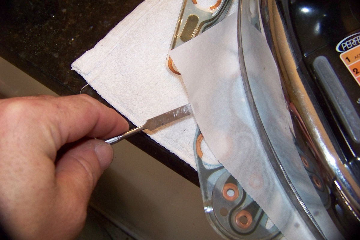

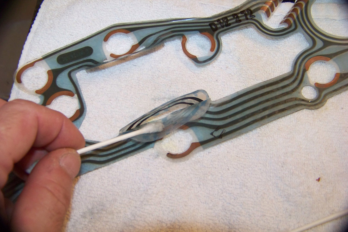

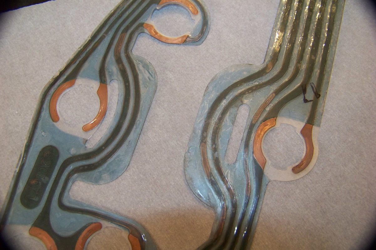

Some photos of the relaminating the cluster circuit board

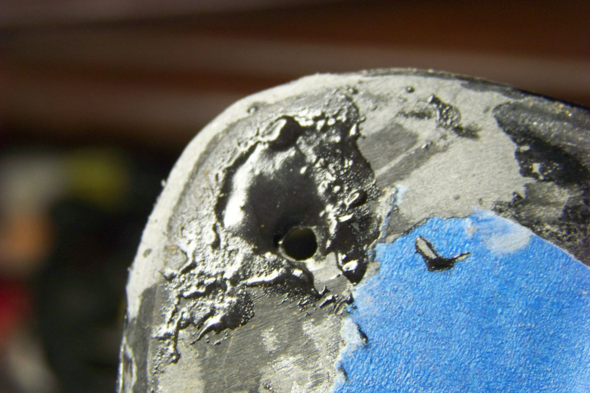

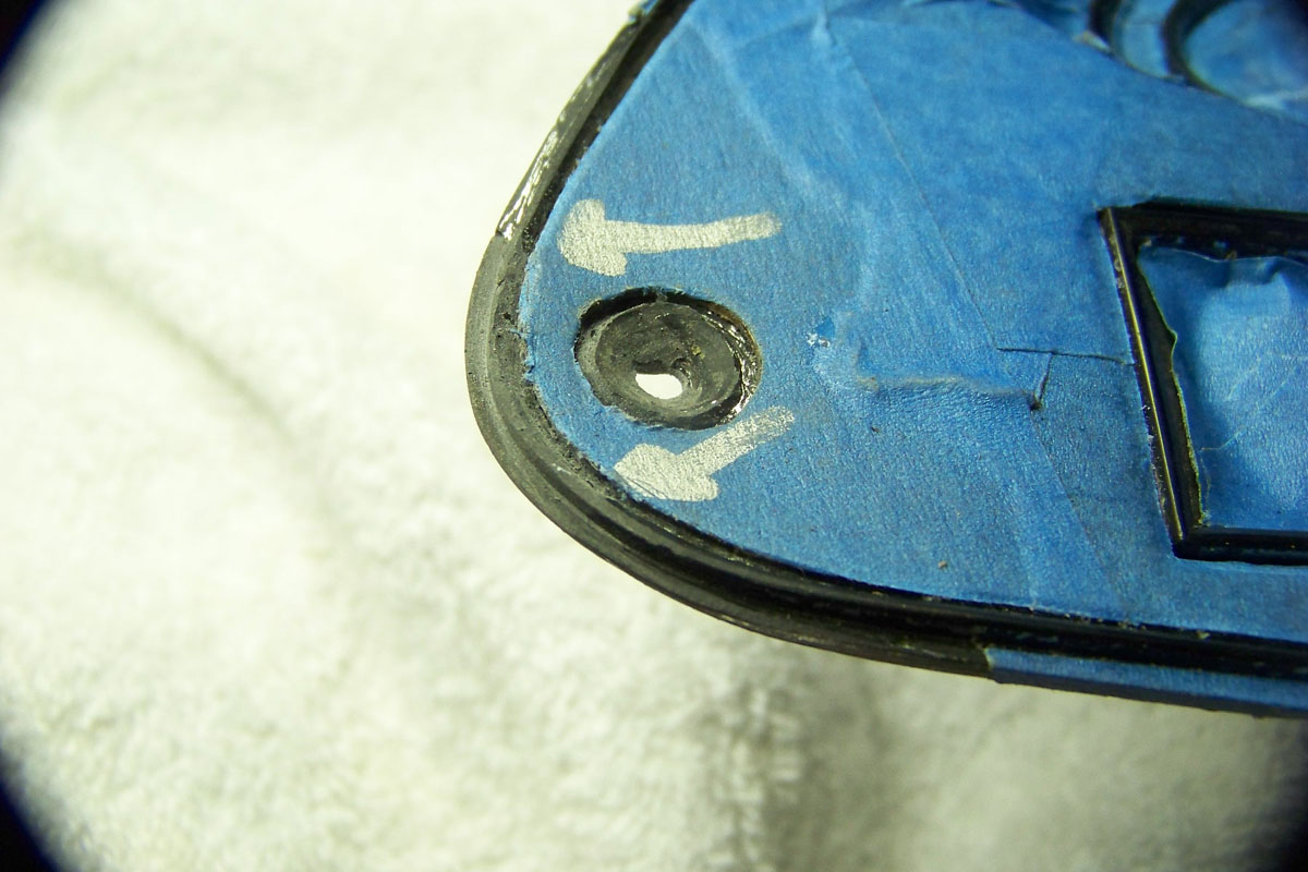

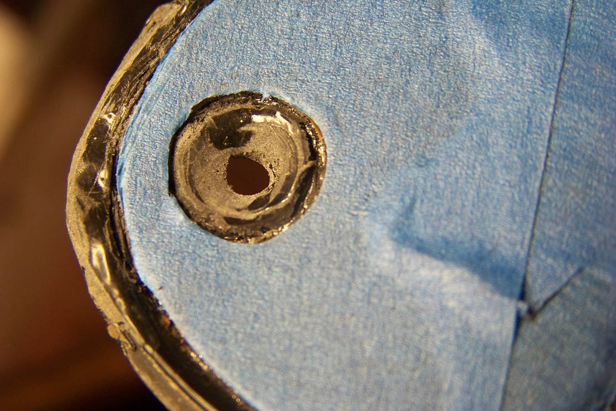

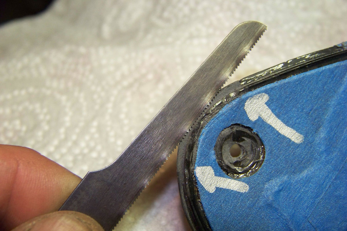

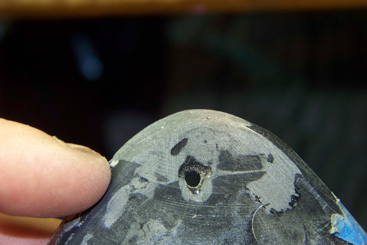

There was an entire corner and half of the screw hole which were missing... I taped up the wood grain and used 3M automix repair material to build up the area and worked it back down.
The lighter gray color is all replacement material

HA I just picked up one of those at Hobby Lobby over the weekend.
Mine has a finer point with a metal collar half way up the writing tip... probably a 1 mm tip

Join Date: Sep 2016
Location: Dayton Ohio
Posts: 927
Thanks: 317
Nice work! I actually like the detail work better than the body work and engine stuff. It can be a challenge especially when you don't have many practice parts.
On the dash pad, did you flatten your or did you leave a bit of an arch? I didn't flatten mine completely as the dash on mine has some curve

Pick up the bigger Molotow refill and save yourself some money.
https://www.amazon.com/dp/B01MR2KER3...a-360766397241
Air brush it on in light coats and see how incredible it mirrors chrome.
The amount of paint they put in those felt tip pens is ridiculously small.
Thanks I wondered if it would airbrush or not...
IMHO it looks JUST LIKE vacuum metalized. especially when you are only seeing a small amount, it would be perfect for a chevelle gauge cluster.
