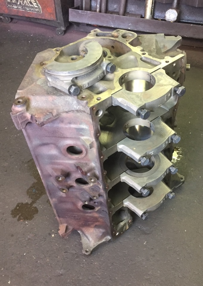

Engine progress! Block is already tanked, bored, honed and cam bearings installed. Heads are next. The Speed Pro H535CP .030 pistons are installed on the rods. These are an updated version of the factory piston with valve reliefs instead of a compression lowering pocket in the center.
With the factory DOVE-C heads it is well over 10 to 1. Once I CC the chambers I will know exactly what it will be. The Speed Pro spec says 10.8 to 1 with 72 CC chambers and 10.3 to 1 with the 77 CC chambers.
