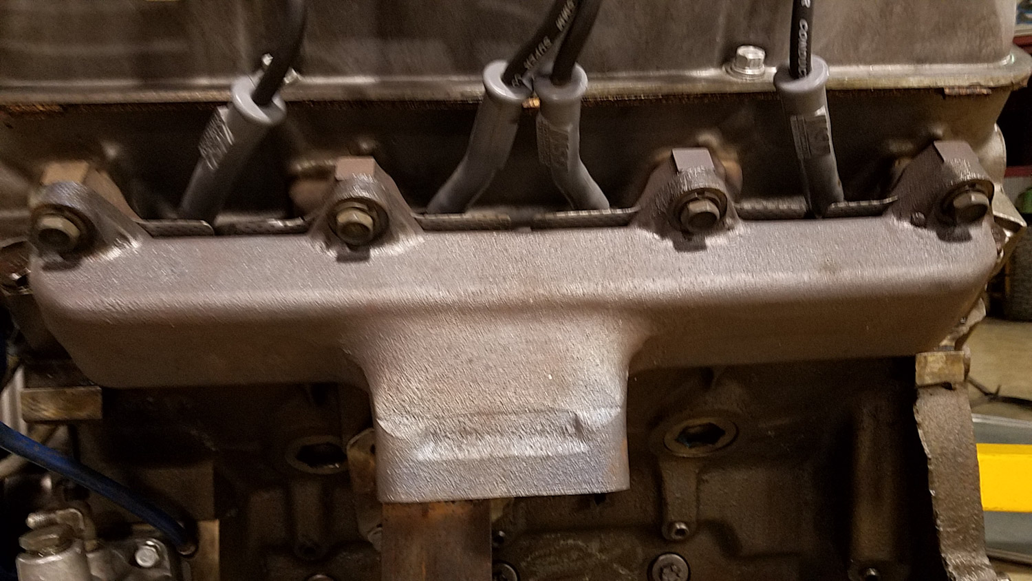

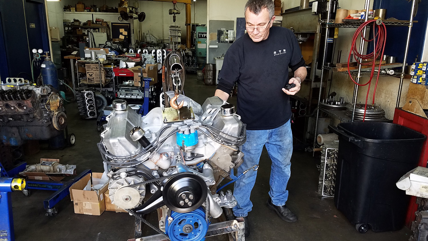

Finally at Stanley's for dyno work. Using the correct log style manifolds. That'll cost some hp.

430.5 hp at 6100 was peak with 38' total advance. 415 lb-ft at 4900. We ran factory water pump, alternator and exhaust manifolds. They had to rob a lot of power.

----Yup! I know those exhaust manifolds to be HP eaters, but all looks very cool!......Bill S
