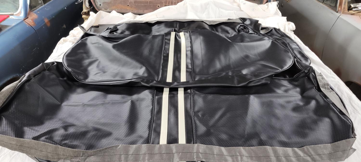

SMS actually got me my headliner a few weeks back. The seat covers finally arrived this week. I had been hearing from others about long lead teams but my experience was only a few months. Door panels are yet to arrive. Im really happy they included head reast covers as well. Not something I have seen with PUI or Legendary.

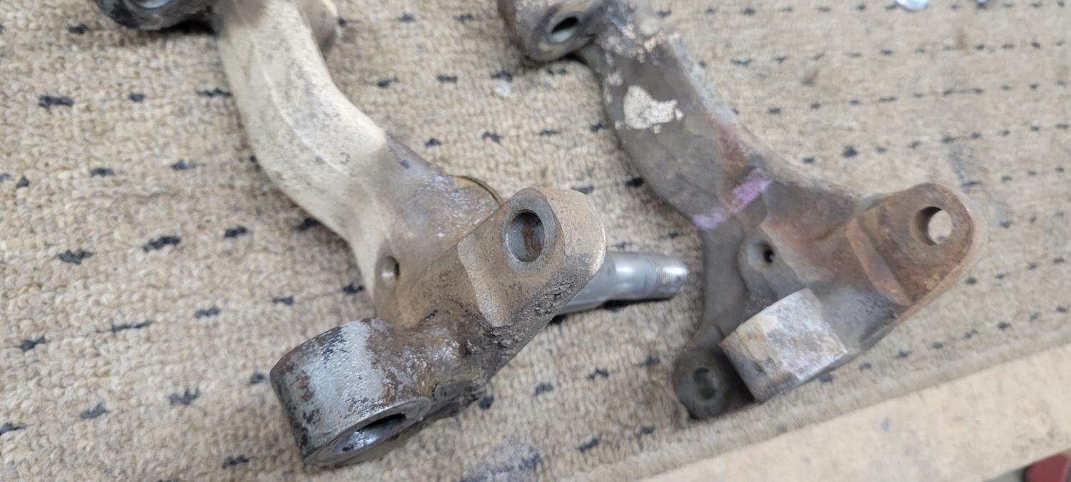

The calipers had some very light traces of factory paint marks on only one side. I also found some torque marks near the brake lines.
The spindles were fun because they have all kinds of different colors and neither side matches the other. On one spindle there is black and blue, while the other side is cream, blue and violet

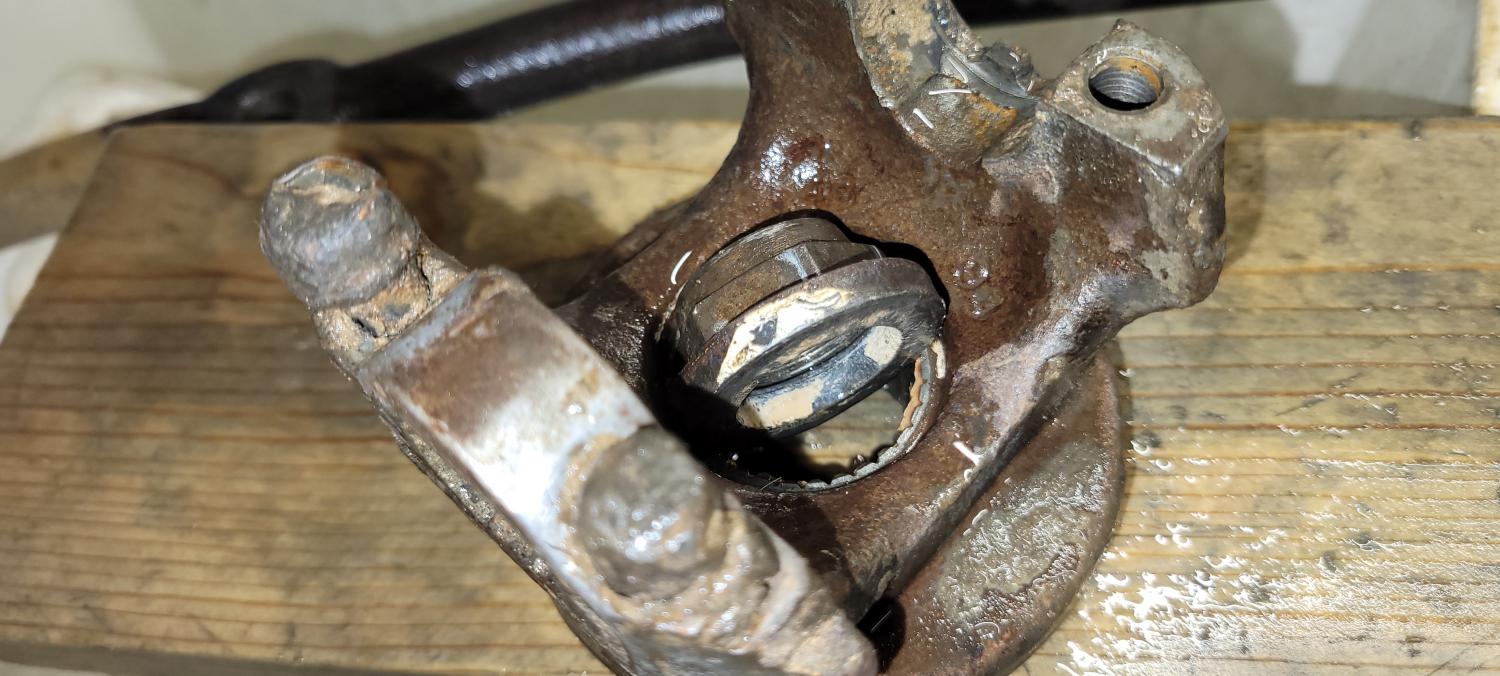

Axle Yoke had some blue on the side with some cream/white for the main nut

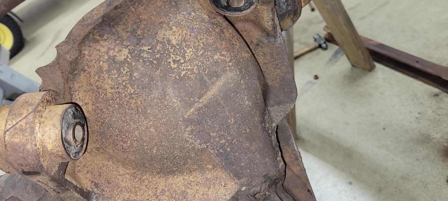

Rear cover appeared to have an X marked

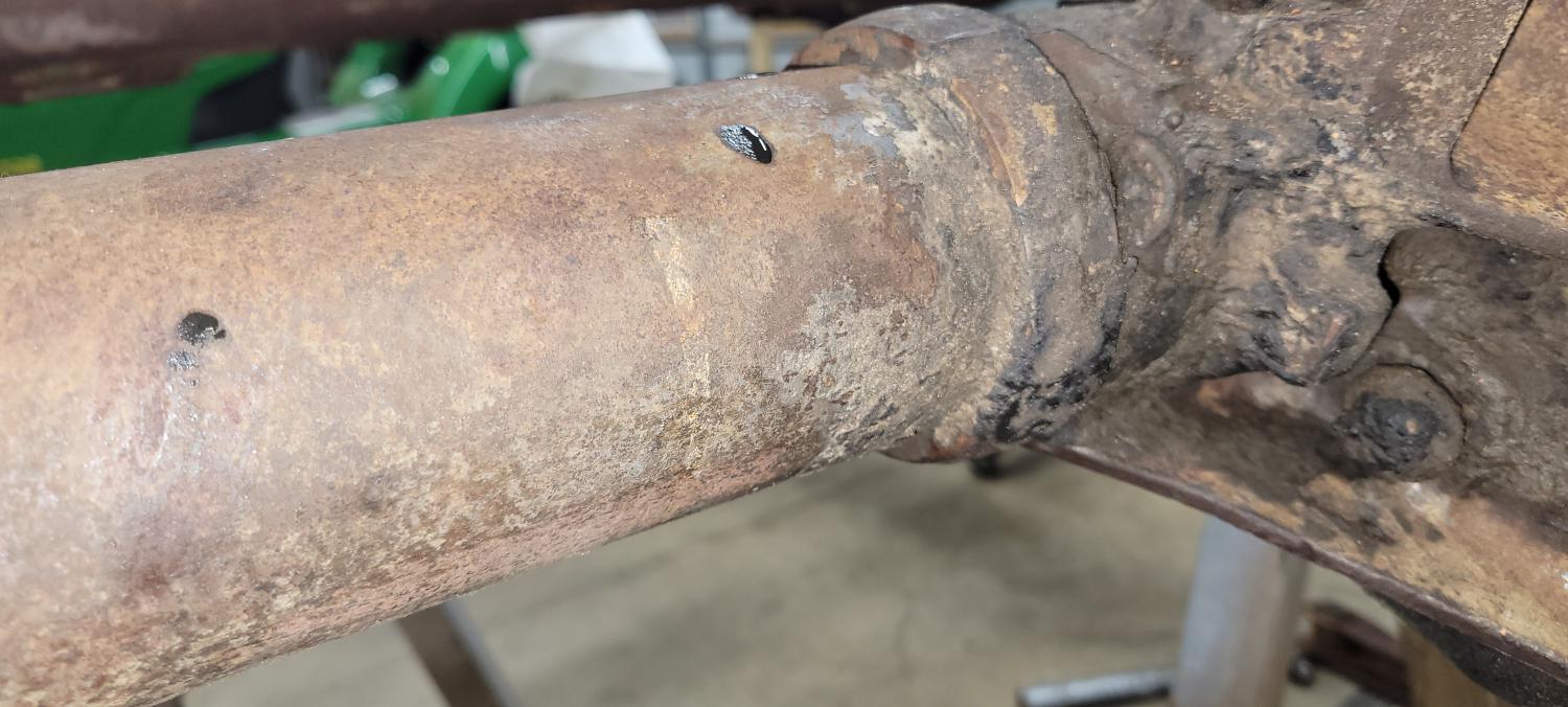

Rear end itself has some yellow on the drivers side and white stripe ont he passenger by the stamping. Also another X on the top of the center section
Brake lines only had some orange on one line

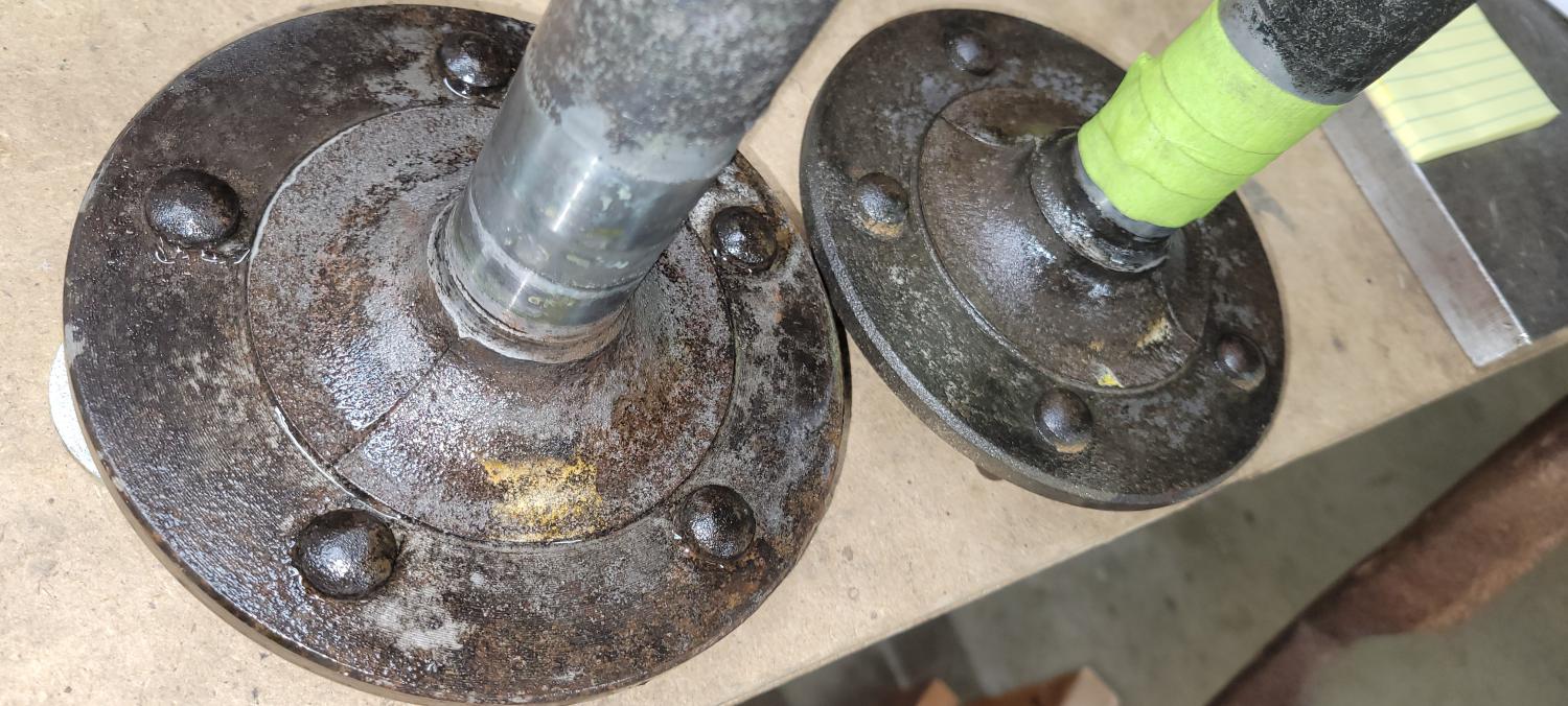

The axles sadly are trashed as the bearing surfaces are flaking. That being said still found some yellow marks on both axles beneath the brake dust.

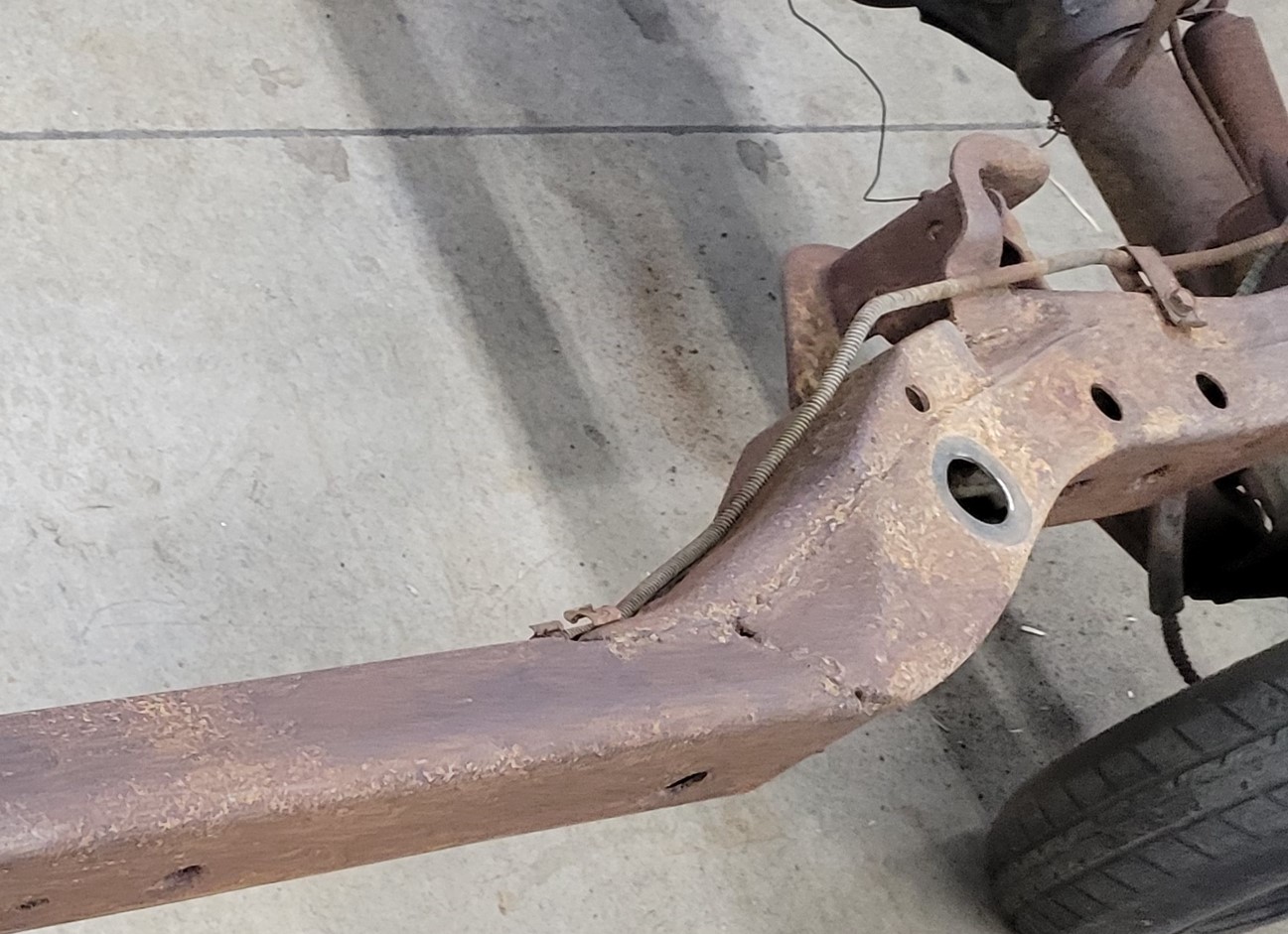

Default Brake Line Clips
Ive seen other cars that utilize p clips and bolts for the brake line. My car actually had the older style clips. They still had some mustard color under the brake line but were mostly rust. Still very good shape and cleaned up nicely. I also noted the assembly manual showes p clips and bolts.

  #90
Old 02-18-2024, 11:19 AM
chevyman0429's Avatar
Join Date: Nov 2008
Location: Clarkston, Mi
Posts: 1,716
Thanks: 344
Thanked 521 Times in 228 Posts
Those 3 clips are from that frame ? Did u restore them already and if so how? Your frame looks like it will clean up real good.
