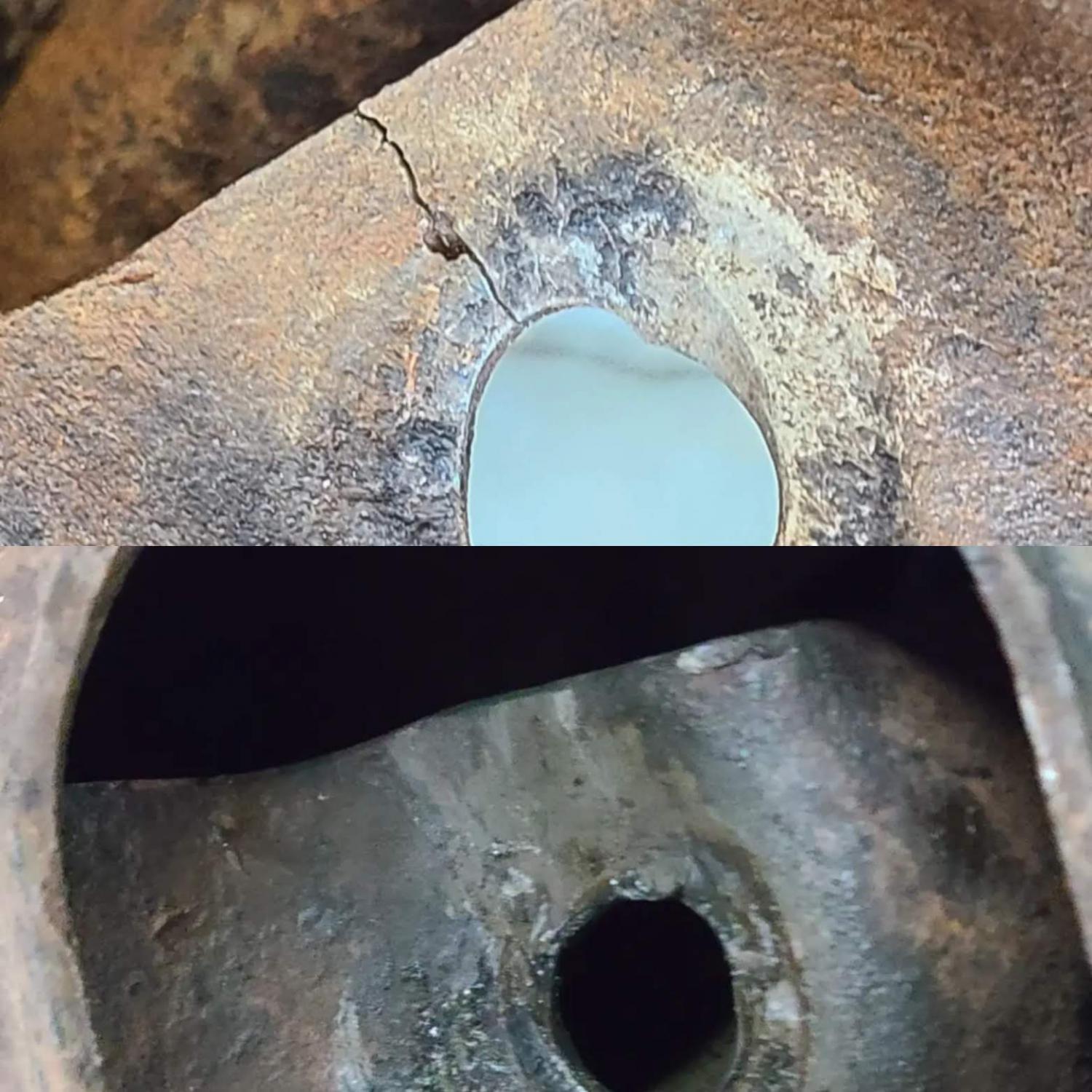

There was a small crack on the frame where the upper shock mount is but I simply drilled it and hit it with the mig and ground it down. It passed the strength test after using the coil spring compressor. No flex and no cracking.
The original ball joints were toast and the shock cushions were toast which is why I believe the frame cracked in that spot.

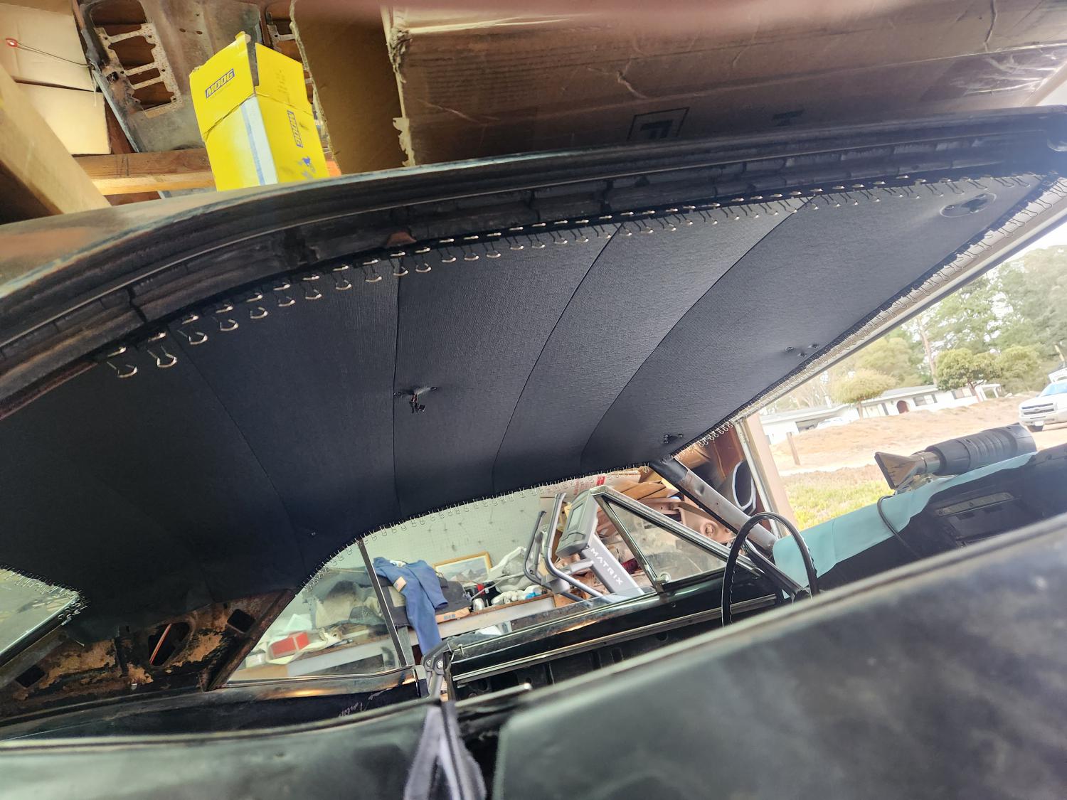

I've managed to get the used headliner fitted and it will be glued in within the next couple days. I'm content with the fitment as it is my first time installing a headliner.
Some of the tips that helped me most was:
Pre-installing all screws before installing the headliner
Fitting the front center and rear center of the headliner first
Pulling the sides of the headliner AT the bows, not between

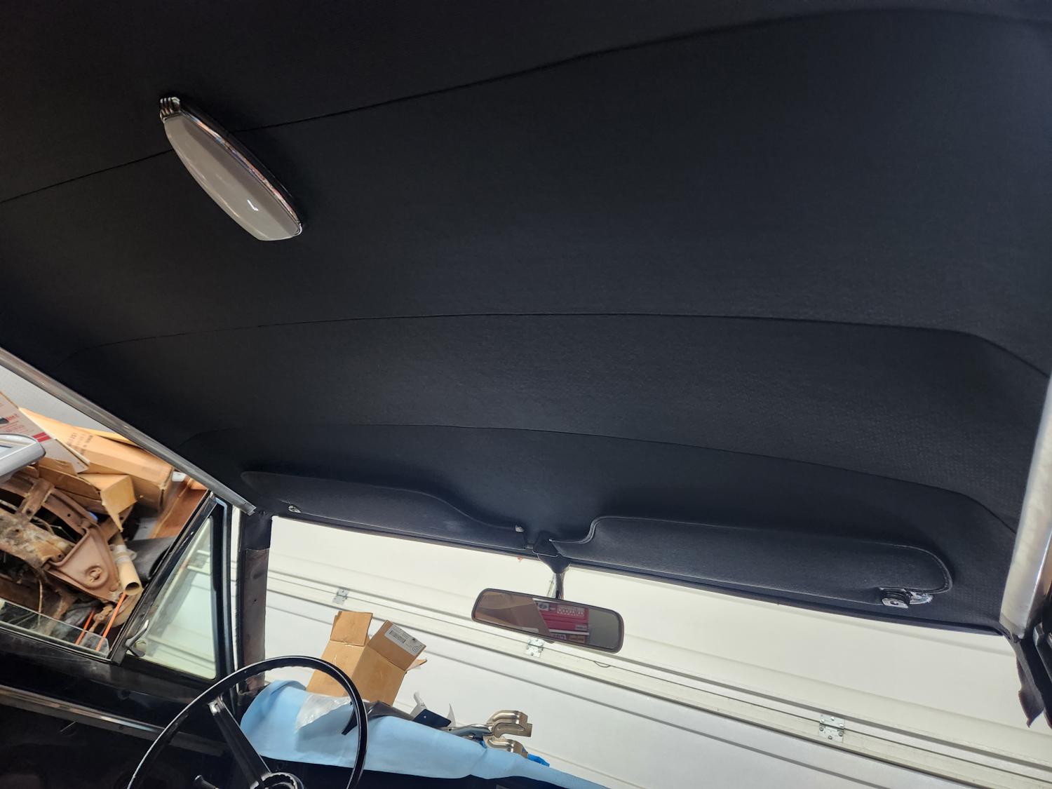

Headliner installation complete! I don't think I did too bad considering it was my first time. I made a repair to one of the original GM sail panels but it worked.
To install the rear glass trim I used a small rubber mallet and placed a small paper towel between the rear glass and mallet, sliding the mallet against the glass carefully bumping the trim into place.
