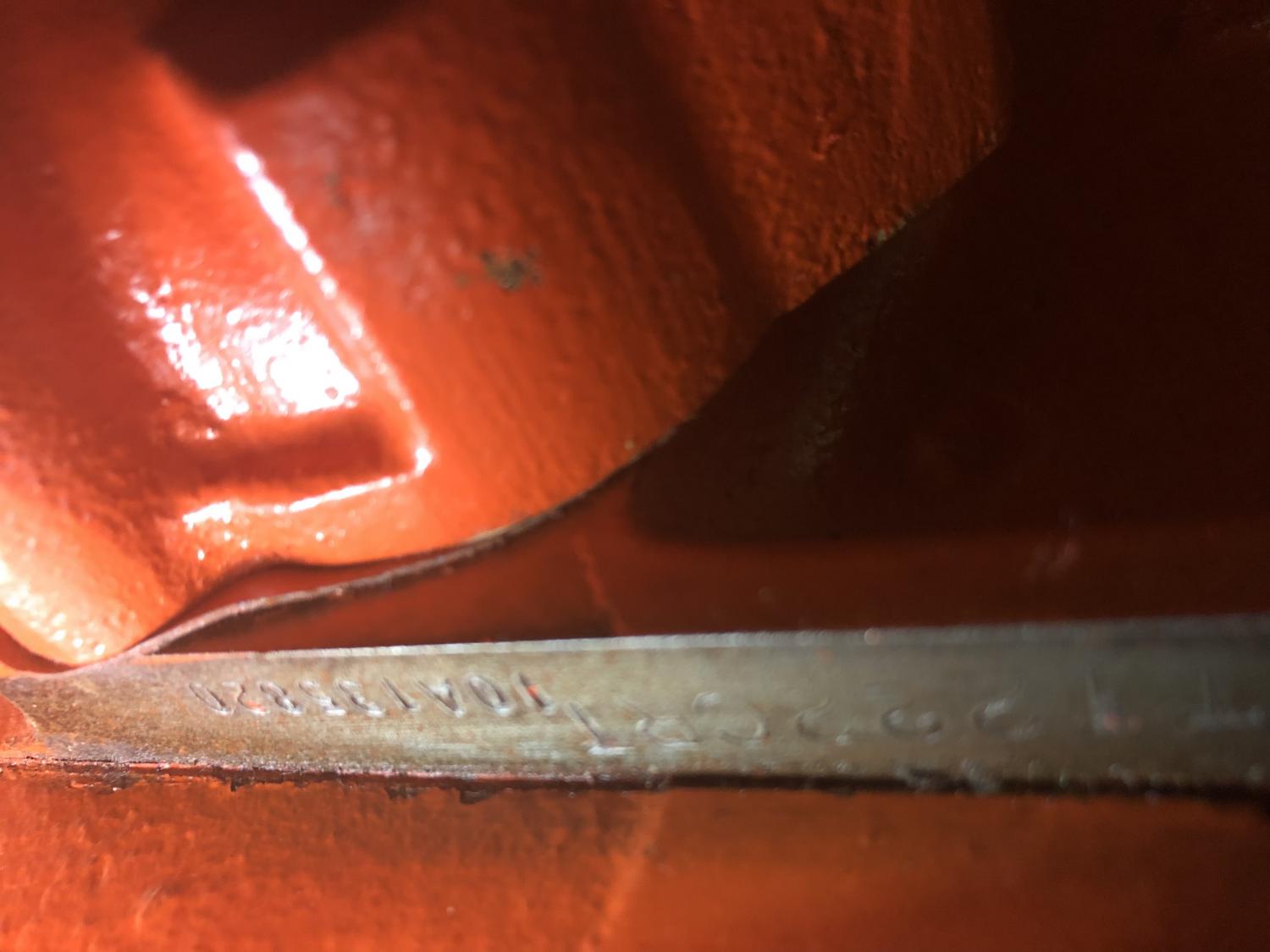

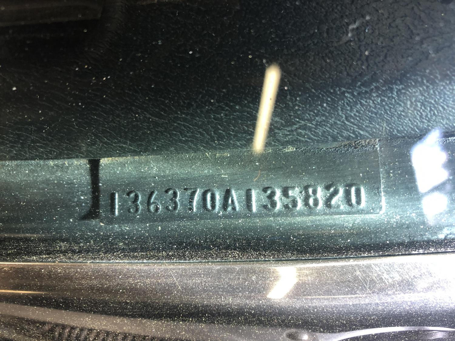

I recently sold my 70 ls5 Chevelle and have been looking for a replacement. I found a 70 ls5 phathom blue m22 car 5 hours from home claimed to be original paint and interior matching numbers. I arrived at the car around 8am after leaving home at 2:45 instantly saw the paint was for sure lacquer everything but the door panels was original as well. Vin stamp seemed off but I’m not expert I then checked the casting date I see H 25 70 car was built 4th week of February 1970 I said that’s odd. Look at again I’m for sure 100% seeing H 25 70 the owner has no idea. Get the car on the lift see a large oil plug near the oil filter I said to the owner was this 4 or 2 bolt when you rebuilt the engine? He says 4 I said I’ve seen enough that’s a re stamp he claims there’s no way. I explained it all to him. He understood he was asking 70 I offered 55 he declined said 65. I returned 60 he said 63 is bottom
Dollar. I drove 5 hours home without the car questioning my decision. The only thing it retained was the m22 everything else wasn’t the born with stuff

The owner said he’s going to keep the car for now he seemed pretty upset about it. I think because it was his dads car who bought it under the impression it’s legit. I told him it’s still a cool car someone would like to own just be honest. The build date of the engine was to early too now that I look back at my texts. 2/22 is the date it says it was assembled. Every Chevelle I’ve owned that’s numbers matching the engine is atleast a month earlier than the cars build date not a week prior
