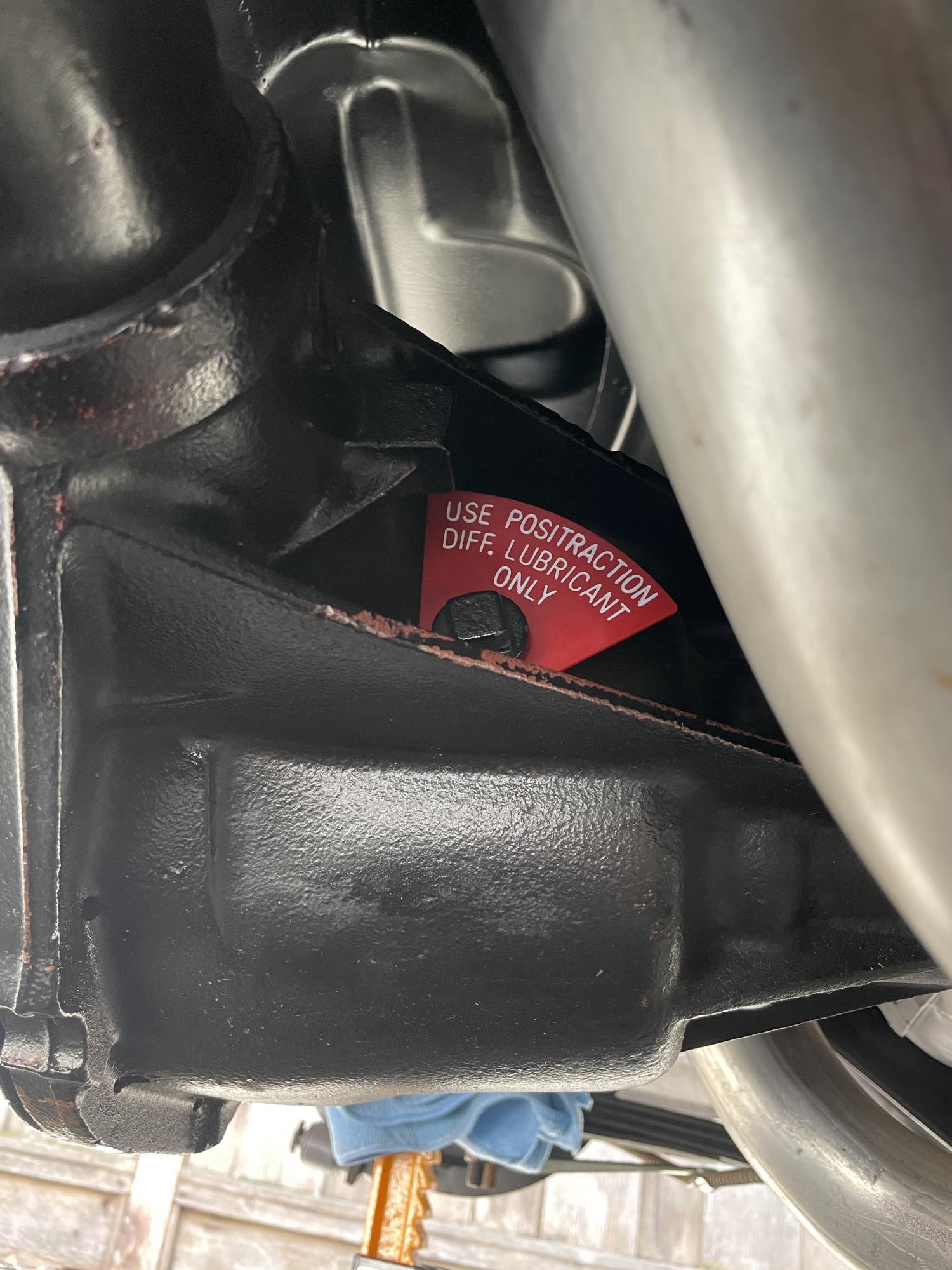

I also added a posi lube tag to the diff fill plug, adding the period after "diff" to make the repro look more correct (a slight touch from a center drill to deboss then a drop of white paint). While under there I went for 2 qts of fresh Lucas 80W-90 for the posi with a new Fel-Pro gasket and 1.5 qts of fresh Sta-Lube 85W90 GL-4 for the M20.
