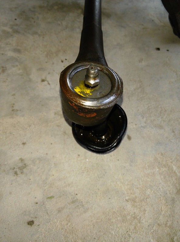

Here's a few pics of my originals:
IMG_20150705_100736 by Dave H, on Flickr
IMG_20150705_100731 by Dave H, on Flickr
IMG_20150705_100720 by Dave H, on Flickr
IMG_20150705_100715 by Dave H, on Flickr
IMG_20150705_100652 by Dave H, on Flickr

Thanks Dave,
I guess that makes one vote for the grease fitting to not be on the cast surface. Is your car an early or late build, and I wonder if there may have been a change during the production year? My car is a late '69 build. Do you happen to know what the part number is on the boot?

Our 69 Z still has it's original inner and outer tie rods intact. Both ends have the grease fittings in the flat steel portion of the tie rods. It's a 12D Norwood build.

All '69 Camaro's whether early or late build have the grease fitting directly under the stud.

And that is what the AIM shows as well. Somewhere along the line I thought I heard that they were on the end of the casting. Don't know where I heard that. I suspected that may not be correct based on the AIM, but then Rick's says that their rod is assembly line correct and it is on the casting end. There are so many misrepresentations with the parts houses it is hard to know what is what. Does anyone happen to know what the part number of the boot is?

GM didn't think about it in 69, but with the locking steering column, once the car was up in the air, the lube tech could not turn the wheels from underneath to get the clearance needed to get the grease gun on the zerk.
That is why the zerk in the side came along a few years later. Otherwise, one had to remember to leave the key partially on so the steering column would not be locked after the car was in the air.
