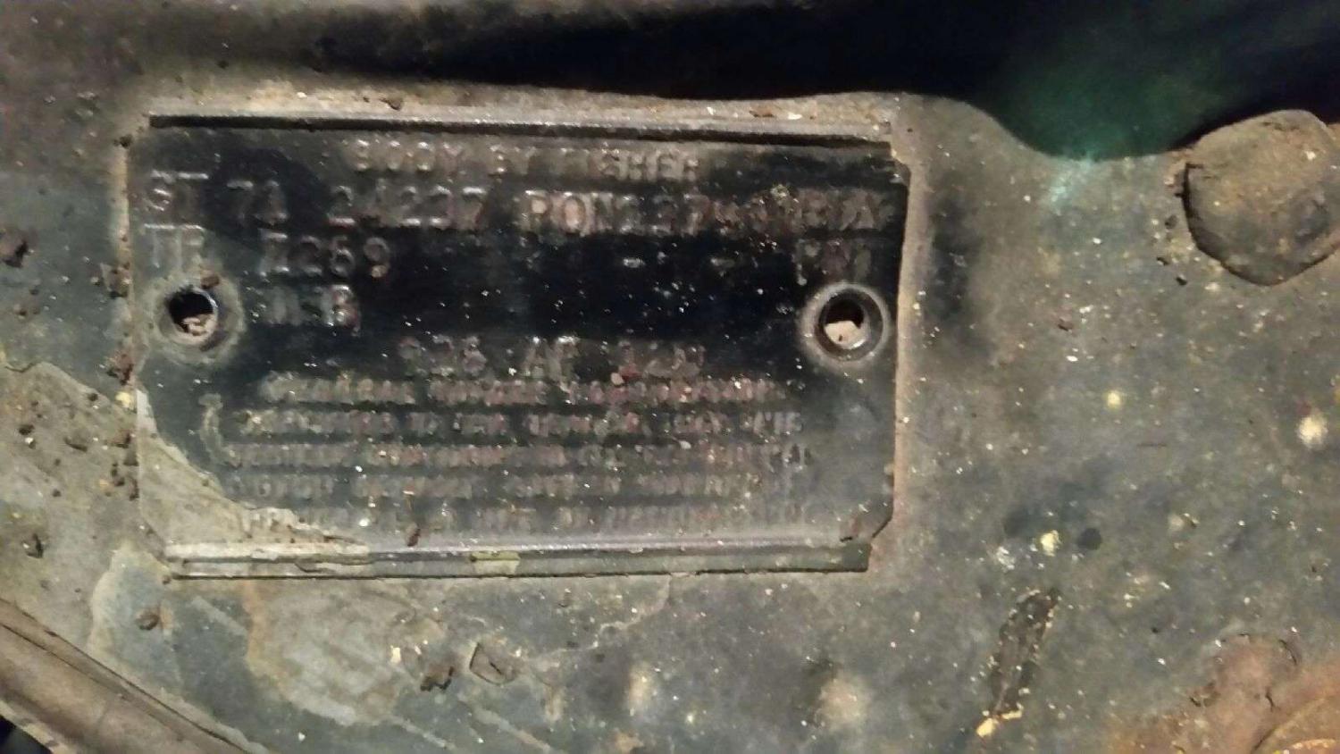

Old 12-16-2022, 12:53 AM
Join Date: Nov 2018
Posts: 543
Thanks: 362
Thanked 719 Times in 195 Posts
i owned this car for a few decades. so here is the trim tag on the 71 gto 455HO that was ordered right after the judge option was dropped and it had stripes and rear spoiler on the phs. it was a special paint orbit orange (which was a 70 color). the cowl tag has - - for the paint code and i never knew what it was but if you look close you will see numbers stamped at the bottom of it. i posted it on a forum and a guy informed me that those numbers were the paint formula for orbit orange. wow learned something new that day. phil mitchell now owns this super rare car.
