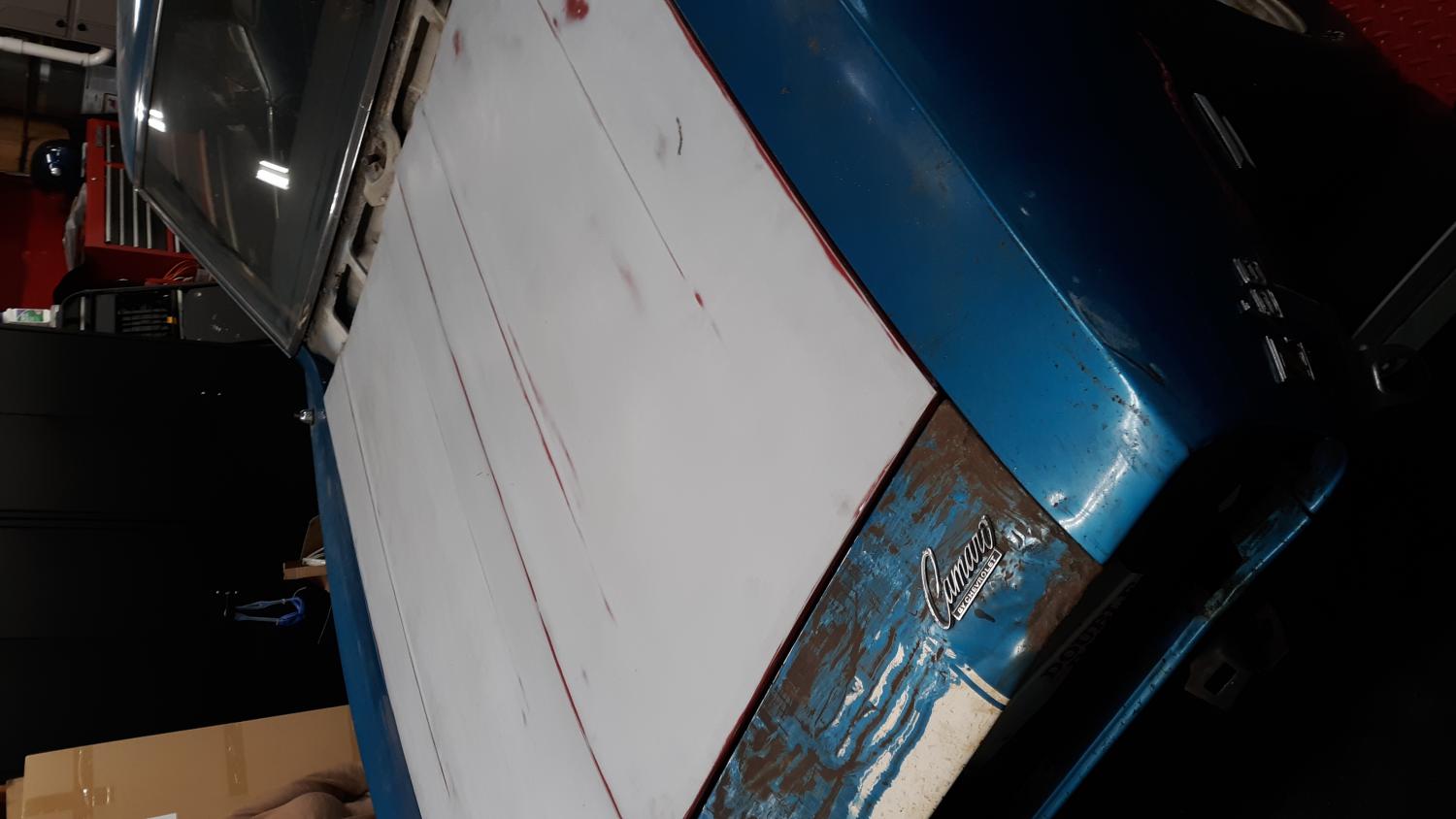

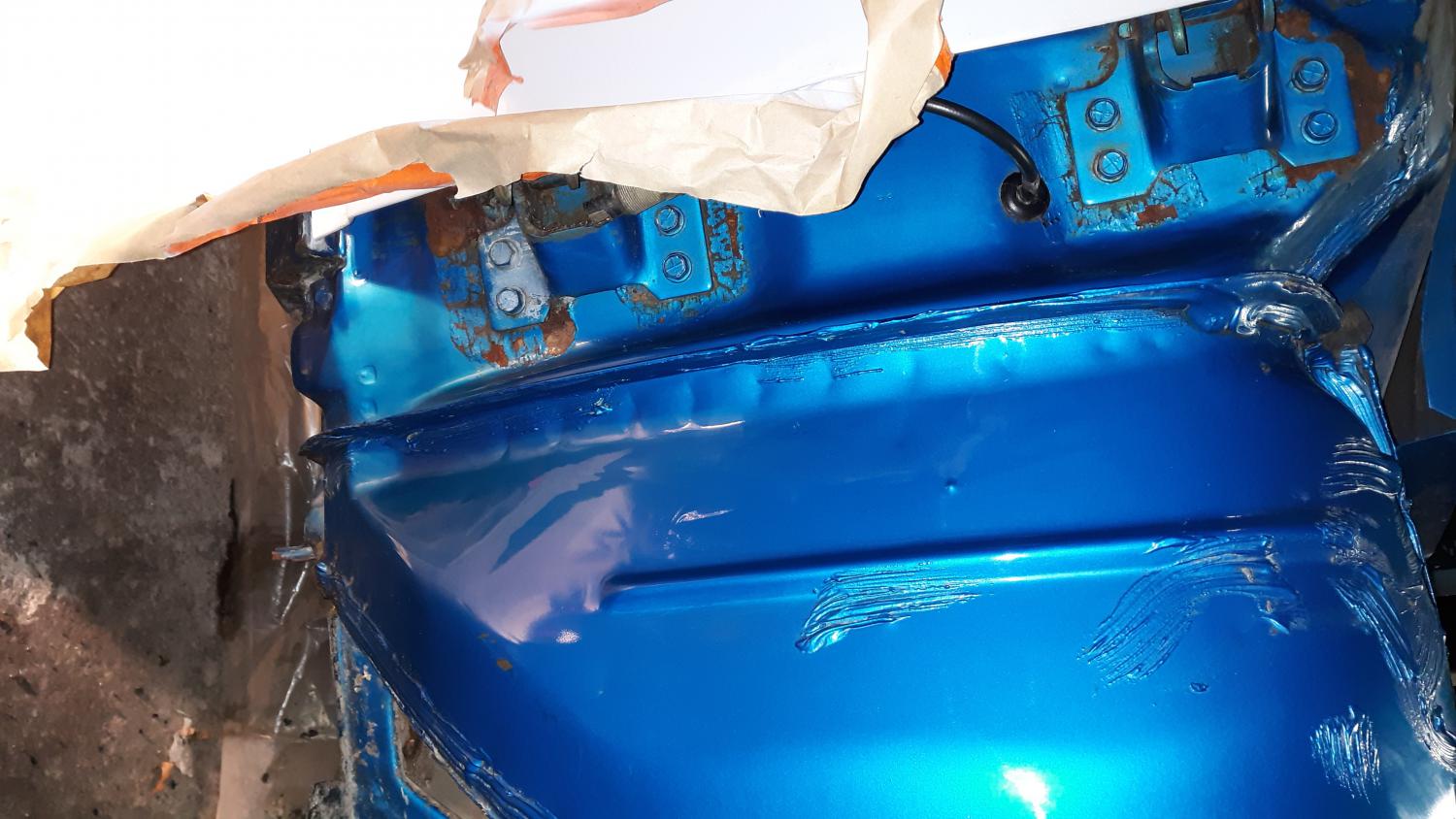

Default Z/28

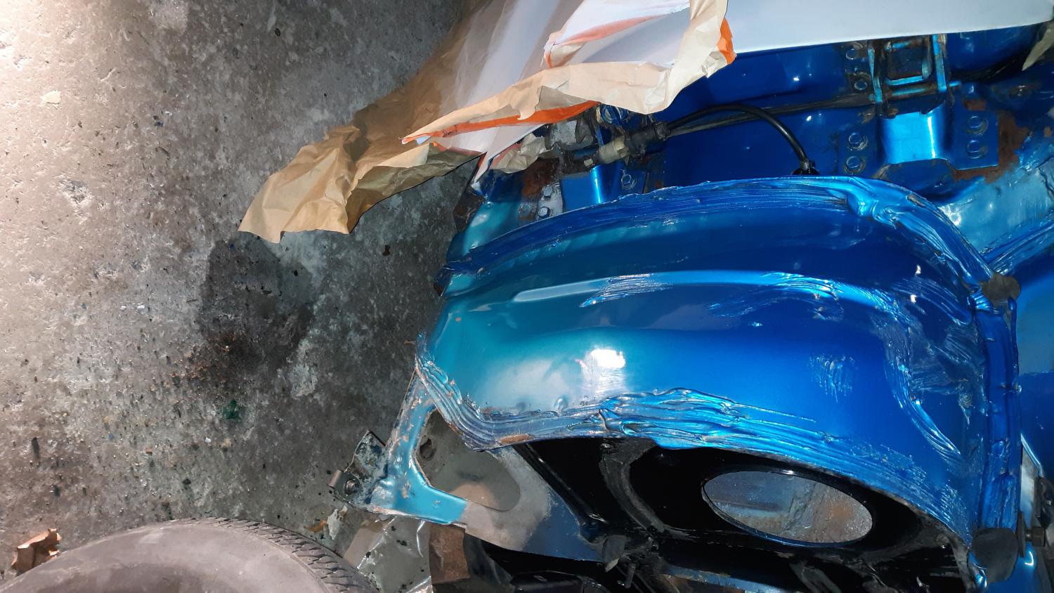

Look at that beautiful paint! The seam sealer guy got carried away? No Second Hidden VIN under fan... D

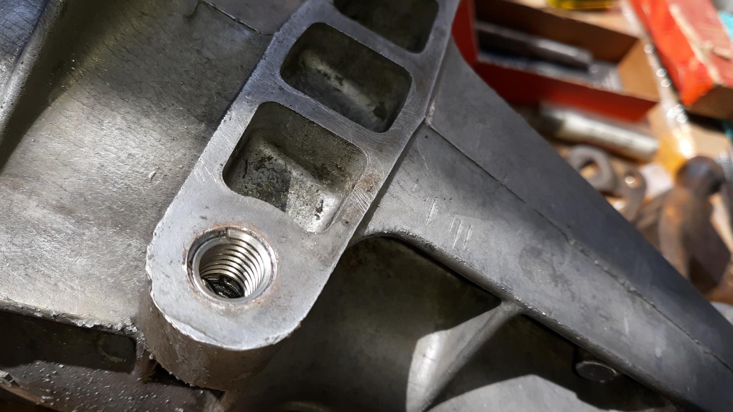

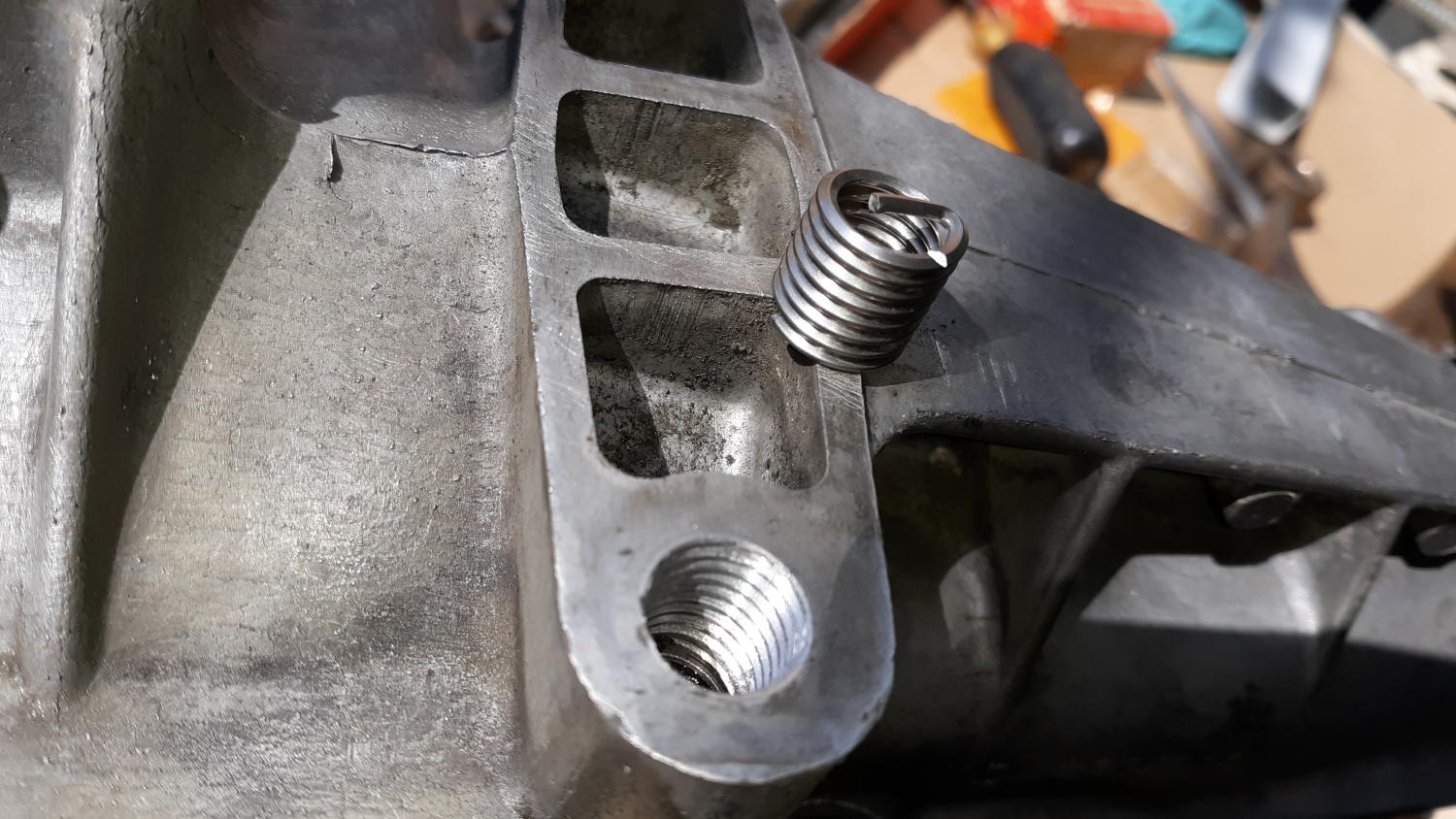

Trans inside super nice showing alot of factory markings. Original front input bearing cleaned and re-installed. Lock washers for safety, you'll never see them. One thread repair only. Original header panel HAMMERED! D

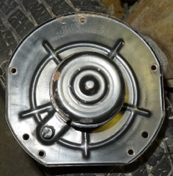

Fan dated July of '68 ...Little creature had a snack. Plastic fan blades. He ate too much, he looks sleepy. SSHHH don't wake him D

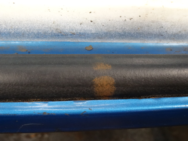

Default Z/28

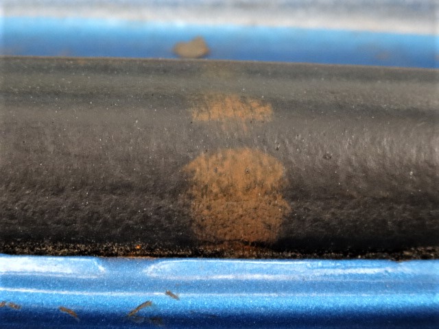

Deck Lid gasket line-up marking... D

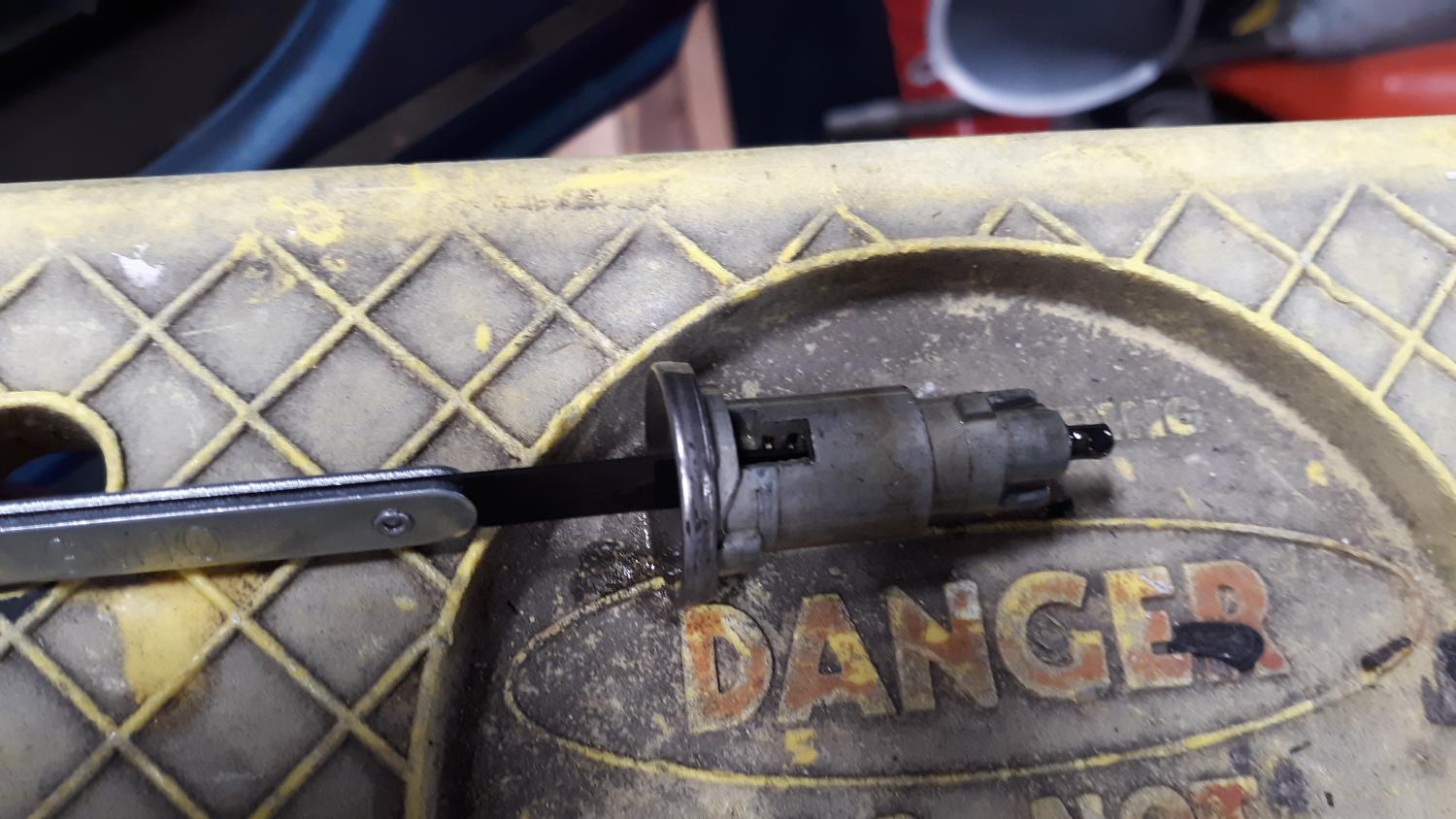

No keys, used factory coded picks. Got it on the 4th one. D
