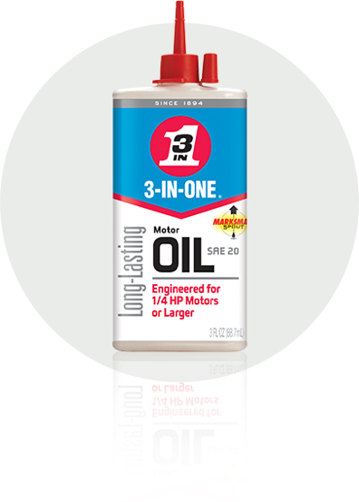

Originally Posted by njsteve View Post
Very cool info Bob. Now I guess I have to find a vintage drum of 10W oil.
3in1 Electric Motor oil is 10W. Ya gotta be sure it says 'Electric Motor' on the can, cause the garden variety can has different (unknown to me) stuff in it.
I remember that stuff! But now I have to find a 1970 era tin can of it. I may actually have it somewhere! Looks like the new stuff is rated at SAE20

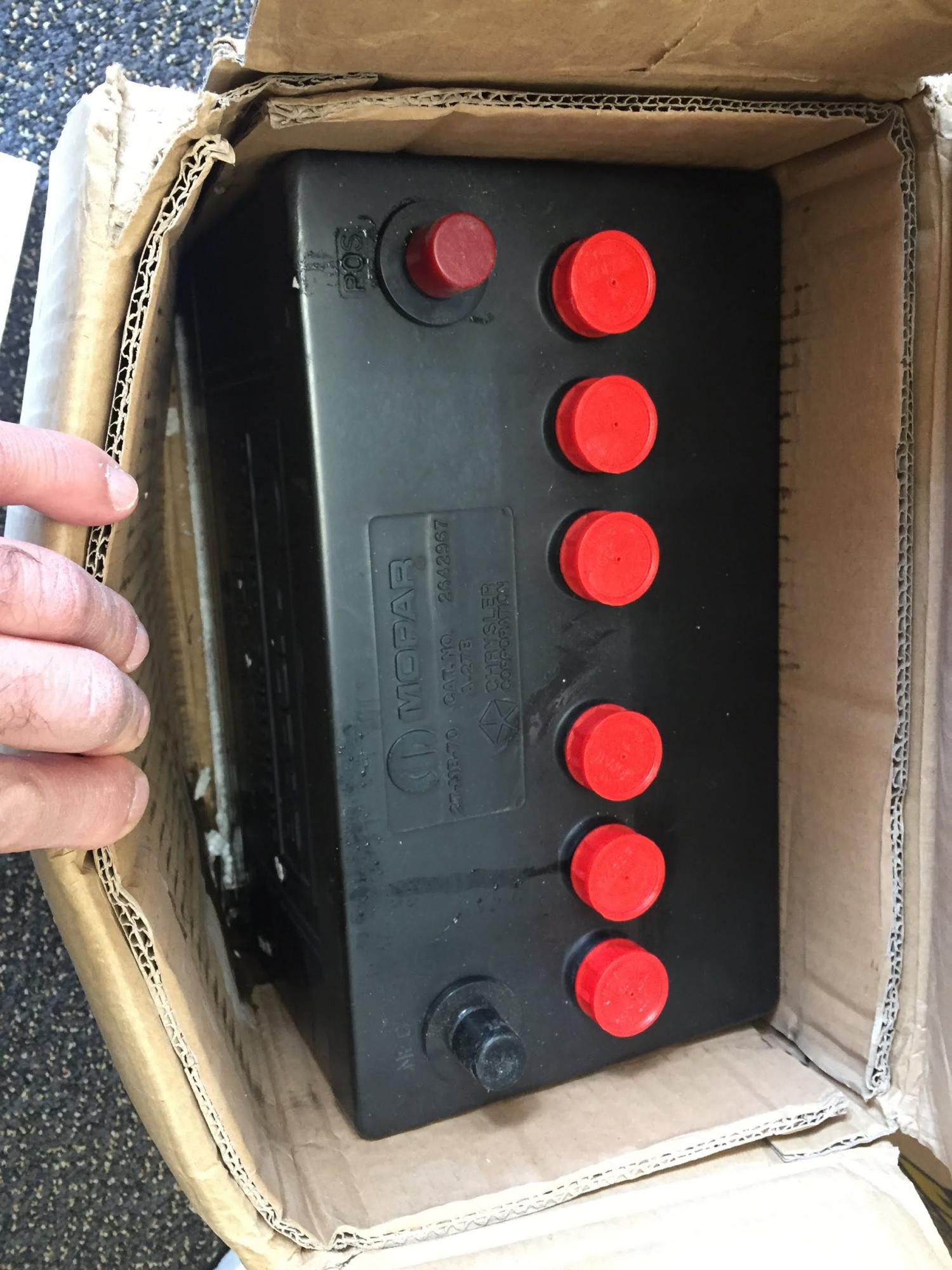

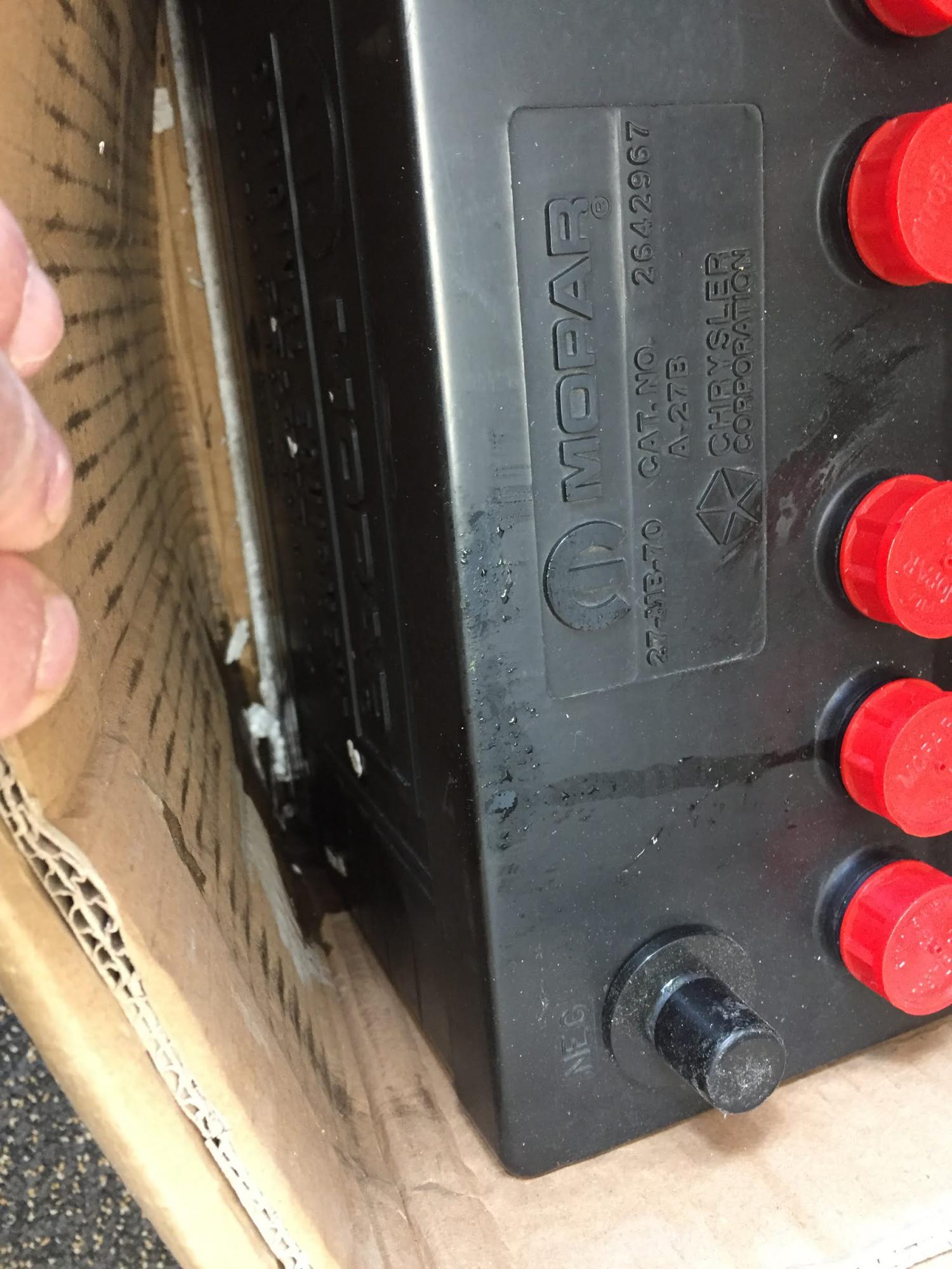

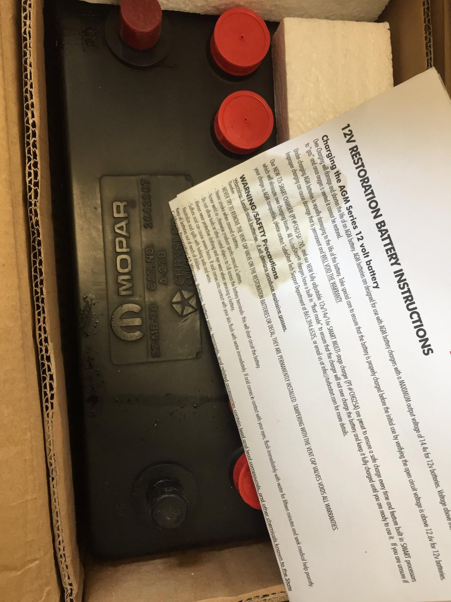

And Fedex Ground strikes again.
I found the only remaining TurboStart reproduction Mopar group 27 size AGM battery left in the United States. (No other sizes available either - this was an orphan sitting on a shelf).
TurboStart stopped making them a over a year and half ago and keeps delaying any new production til who knows when (maybe later this summer, last I heard from them).
Shipped from Jegs on Tuesday for a Thursday delivery via Fedex Ground...Shows up Monday busted and leaking acid from the bottom of the box.
Jegs immediately refunded my money. Fedex doesn't give a crap and won't pick it up because it's toxic waste (LOL). Jegs told me to dumpster it.

Cut Top off and make a battery topper out of it for future use on a modern battery.

I was thinking of that but where/how do you dispose of the acid and battery guts? And how do you cut the case without causing a high amperage short. You cant use a sawzall, it would ground out between the cells.
Any advice?
