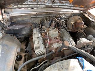

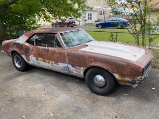

Old 11-02-2020, 12:31 AM
wannarun70 wannarun70 is offline
Join Date: Sep 2006
Location: long island ny
Posts: 295
Thanks: 41
Thanked 21 Times in 14 Posts
Not exactly a gem yet, but heres a couple. 327 rs, Ermine white/red interior.
