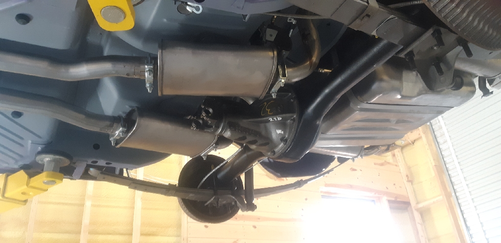

Moving forward, the infamous U-Bolt debacle of 2020 has passed! They finally arrived and the rear is back where the rear belongs... in the rear!
Since the part of the trunk floor that I replaced was the area where the exhaust mounted, I had to assemble the exhaust, install the valance, align, mark the holes for the mounting brackets, remove the valance, exhaust, drill the holes, reinstall the exhaust, valance, align everything, then tighten. Easy... freakin' peasy!
It's coming together nicely! Is it perfect? Nope. Will it win best of show? Pfflppp... Will it make Steve's Dad finally lay to rest his purple car fix? Definitely!
Not much left. I'll start in on painting the bumpers tomorrow!

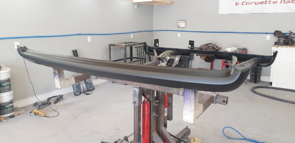

Thanks Sam! The rotisserie doubled as a bumper scaffold for painting. Up next... purple part troix!

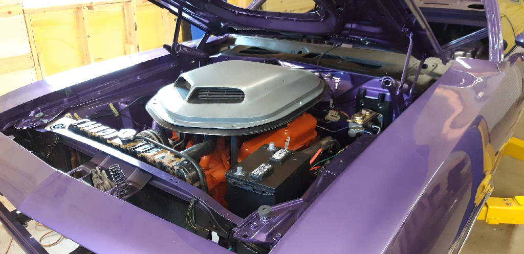

Bumpers were sanded back down and adhesion promoter sprayed on first followed by DP Epoxy using 401LF catalyst instead of three standard 402LF. After that, 2K primer with no additive. Once the paint in complete, the clear gets the flex agent. I'll fill in the pinholes then it'll be ready for paint!
Engine bay is buttoned I up with all brake lines hooked up for Steve-O to start the bleeding process. Wheel lip moldings installed, and up next will be the undercoating in the wells. Once the bumpers are done, the da ssd's h will be loosely placed in along with the steering column, seats, aged the remaining parts awaiting pickup!
Woohoo! Almost done!
