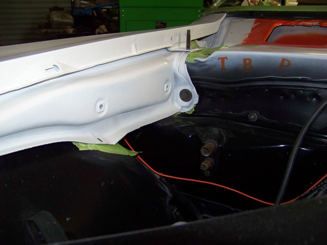

Mated up the subframe and the body...
Bruce dropped off a load of parts earlier today - gardener exhaust, complete interior, radiator etc I am getting excited!

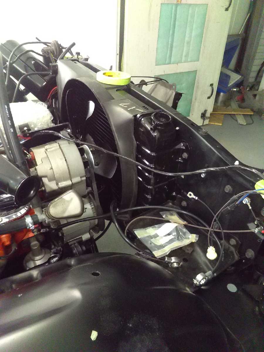

Looking great!
Am I crazy or is that fan mounted backward on the clutch?
Jason
  #43
Old 09-14-2021, 01:52 PM
firstgenaddict's Avatar
Posts: 5,596
Thanks: 161
You're not crazy...

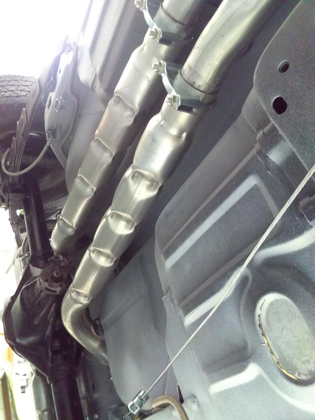

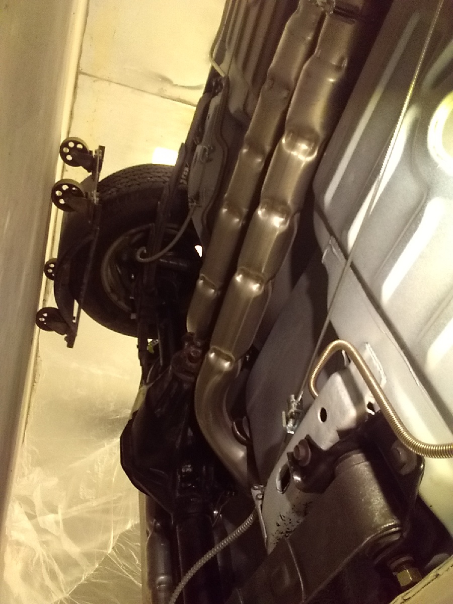

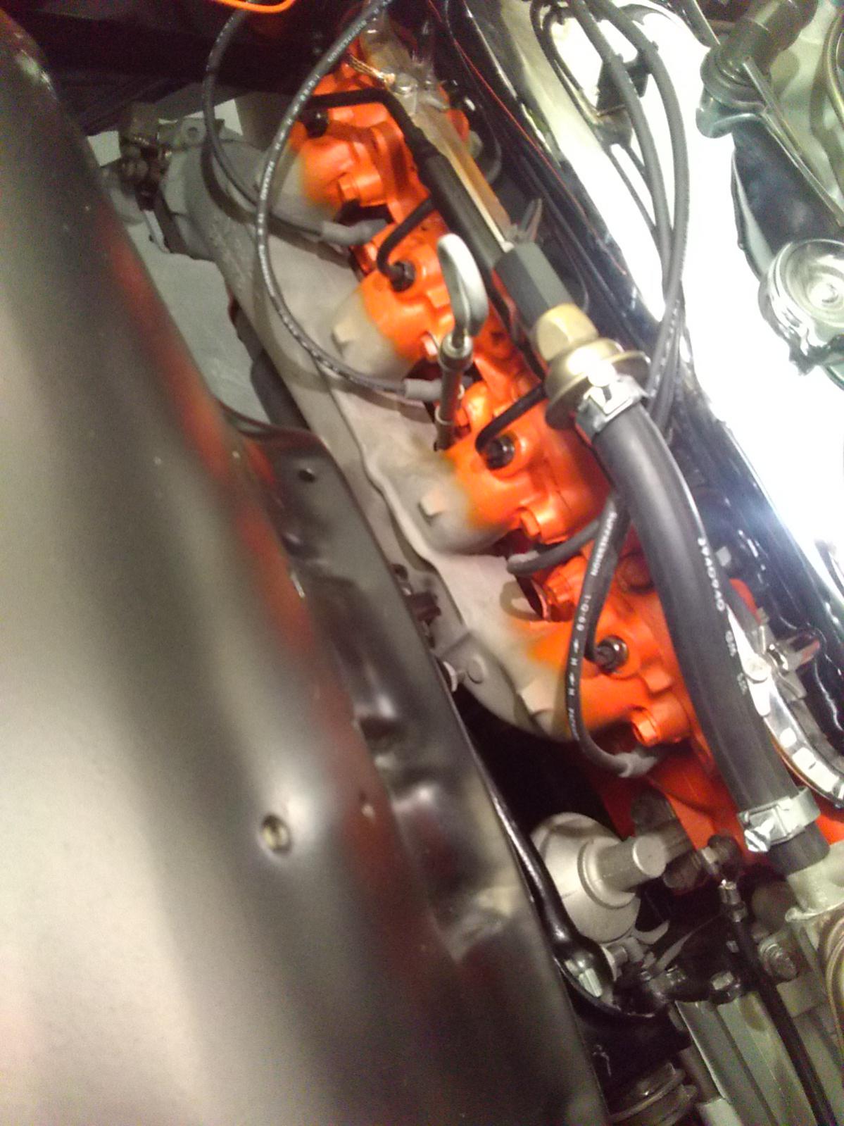

More photos - gardner chambered exhaust, all the cocktail shakers and the spatter paint.

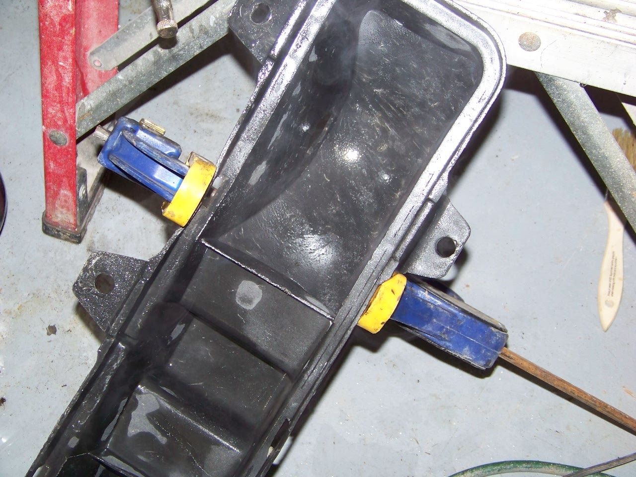

More photos - the RS hose kits do not have a orange striped hose which is what the originals had so I restriped the actuator hose orange and fixed the yellow on the hoses as well.
NOS Trico splitter -
The bottle of electrical joint compound which I use on all grounds and wire plugs.
The tail lamp housings sometimes are deformed and will not hold the lenses very well. I submerge them in boiling water for a few minutes then use a clamp to pull them in - then set the change using cold water in a pump up spray bottle.
