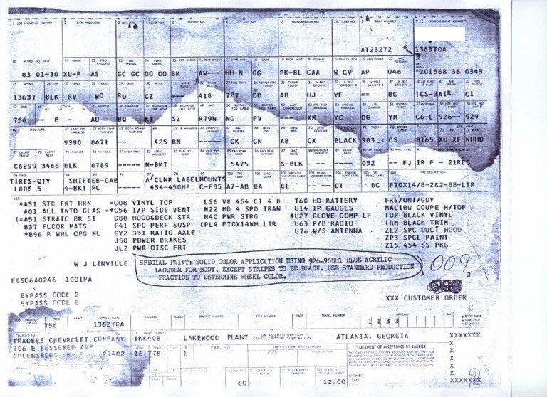

Found this on a 70 from Atlanta. No idea if it's painted correctly but...

Thanks guys. Boy that sure is a very light blue. I'm trying my best to get used to that, lol.
Both of those look nearly identical to what I'm seeing on mine.
Interesting to see the other Dupont number on a 70 build sheet.
I just read a little bit from Jim Mattison and he states the 926-98371 number was for 69, 71, and 72 only but it is clearly shown on the 70 Chevelle build sheet that Charlie provided. And here we have the 926-96881 on another 70.
Armed with both of those numbers, I'll cross them over and do a spray out on both and see what I come up with.
