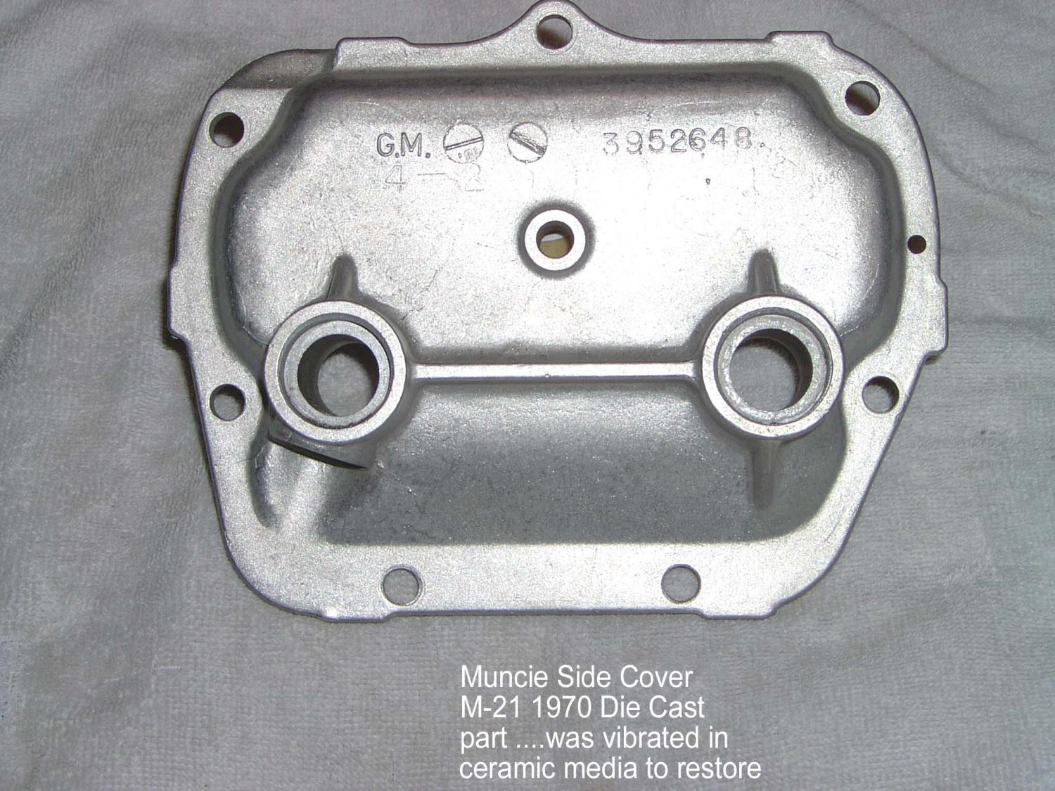

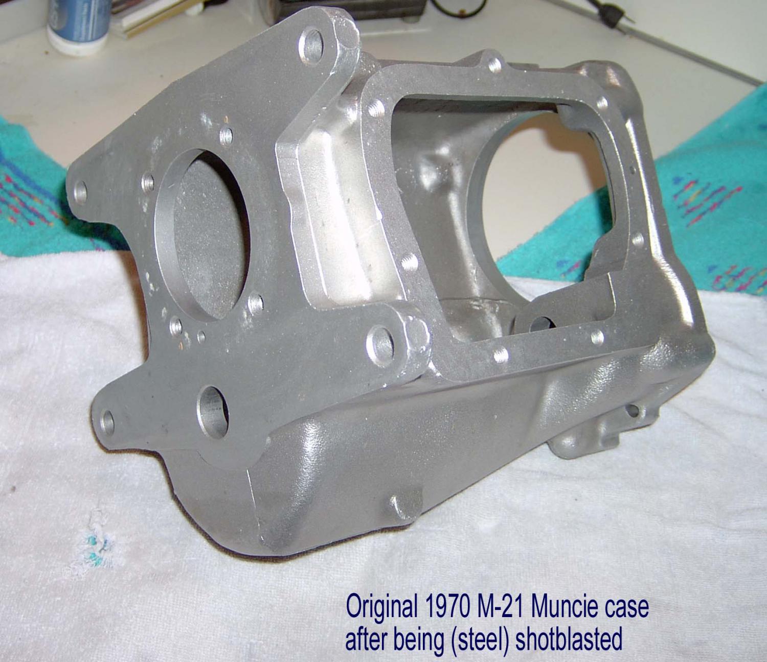

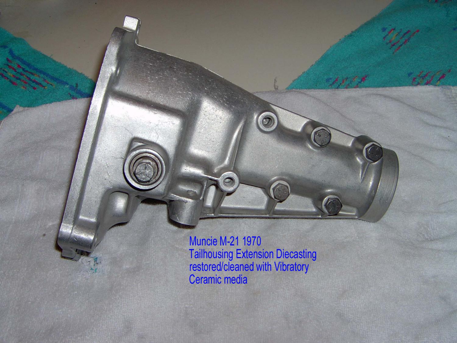

I have zero experience with vapor honing
I do have experience seeing Aluminum Sand Casted Intakes that were Metal Shot Blasted
as they were when mfg at a Foundry
See my alternator cases that were tumbled/shaken in ceramic media..........
Ive also shot blasted Muncie Case (Sand casting) and Tumbled/Shaken Muncie
Tailhousing, Side Cover

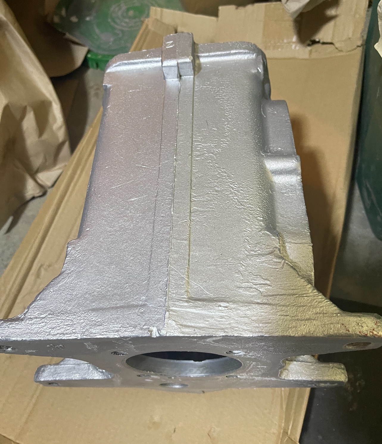

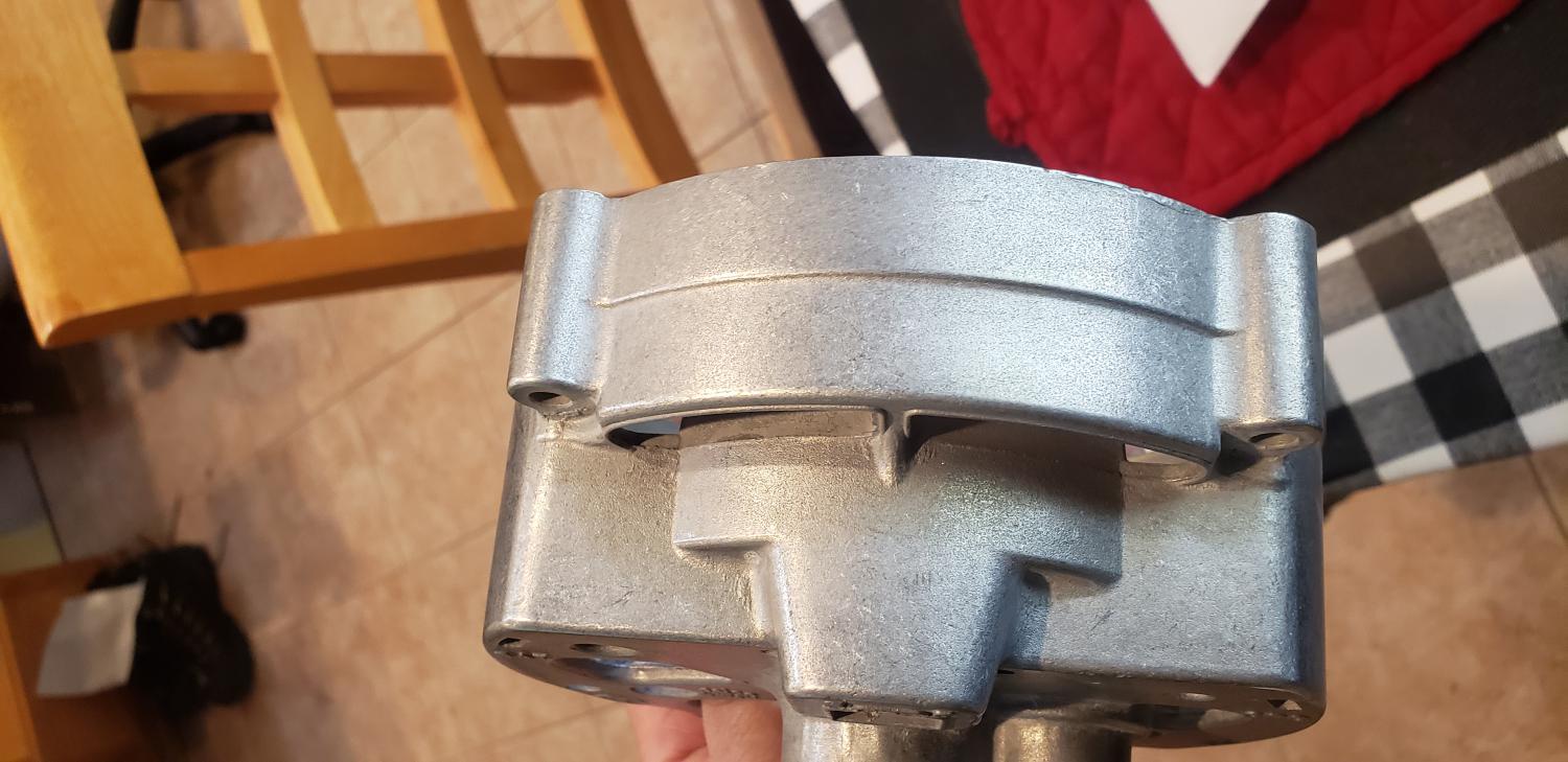

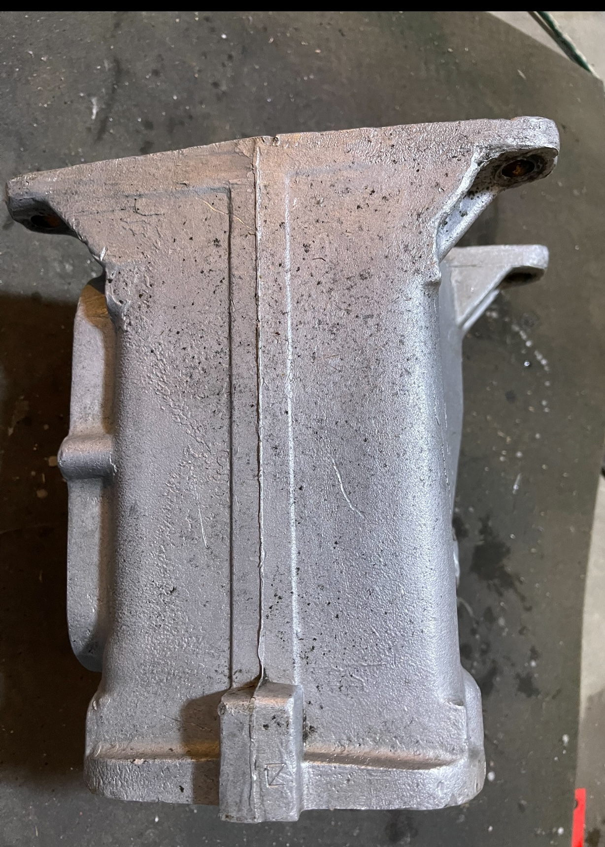

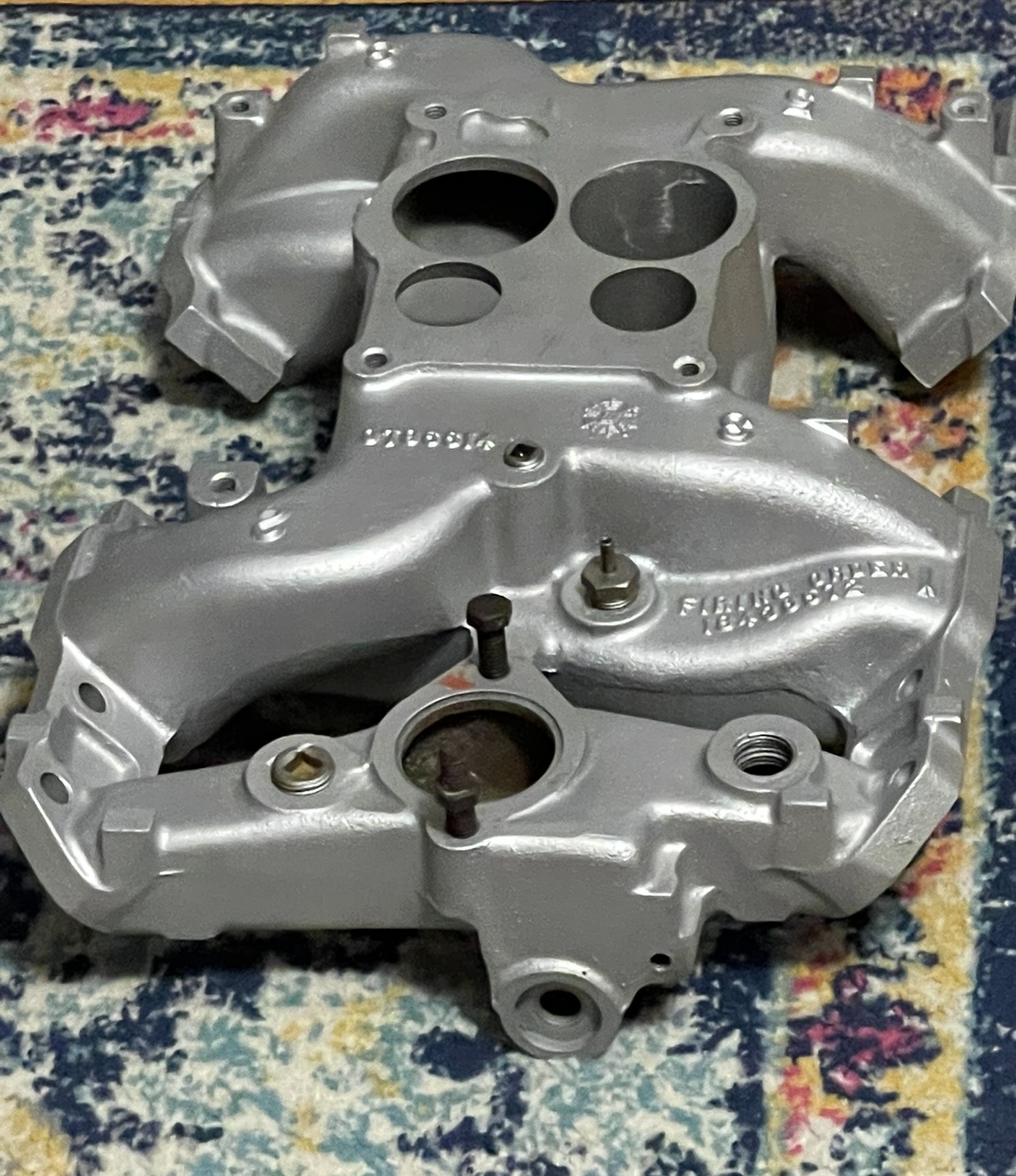

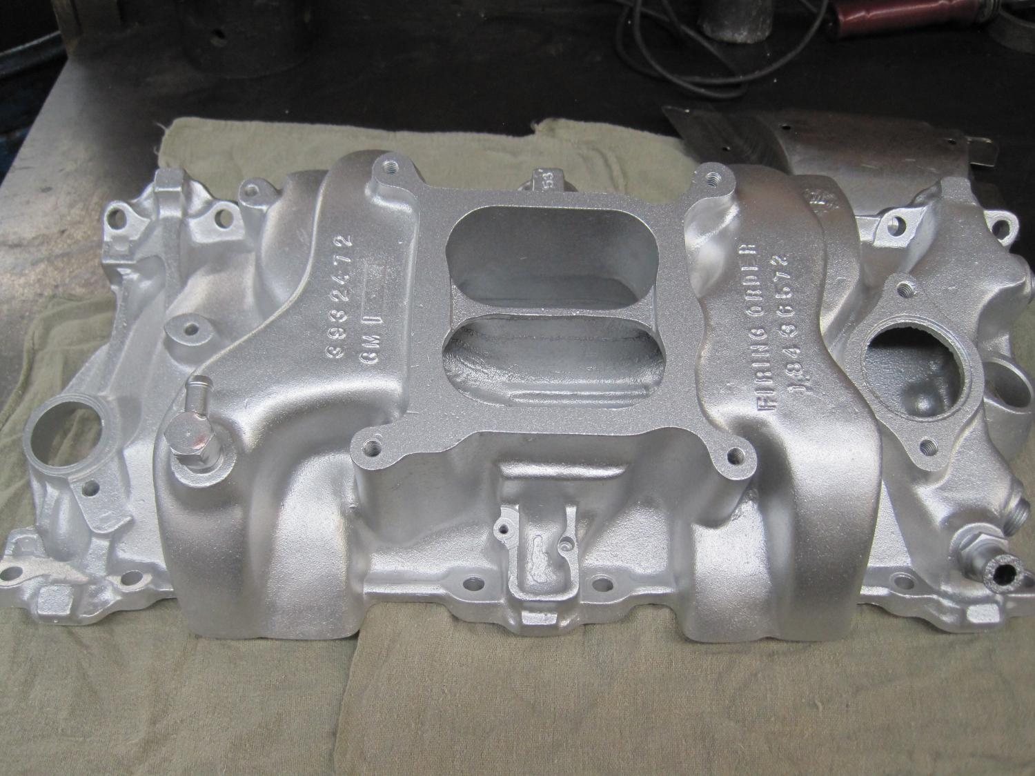

I have my own vapor blaster and I can vary the finish.
Sometimes I get a part the way I want it and later I decide I want it just a little less shiny or it’s too dull and I bring it up w a differnt mix or even different amounts of air pressure.
These pictures are from when I first started and I was playing with parts to get the right sheen.
Gives a good idea of the differences.
Trans case is just cleaned vs vapor blasted.
RAIV intake was dull after being, just cleaned vapor blasted half in first pic and then Finished.

Notice it doesn’t smooth out any of the rough casting, it won’t even remove anything silicone. If I need to remove paint I glass bead it first gently to remove the paint then I bring the finish back up w the vapor (honing) blasting. I don’t think there’s any difference between vapor honing and vapor blasting at least not as far as I know. It’s all media in water. Some people add glycol to the mix.
The whole point of it is to roll the media across the finish which closes the surface vs striking the surface and abrading it with some mixes I could polish it like chrome.
